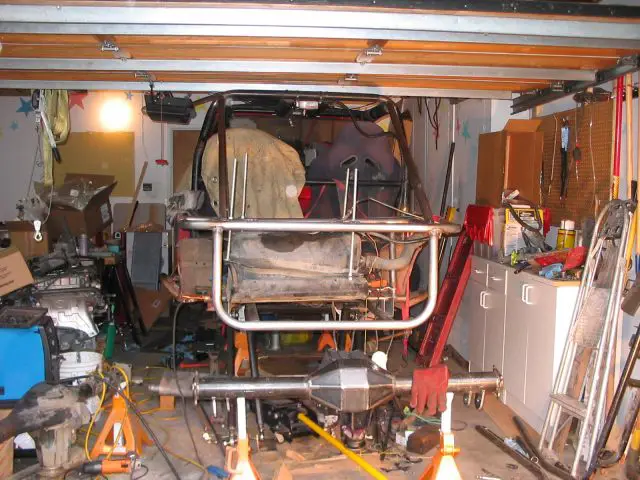

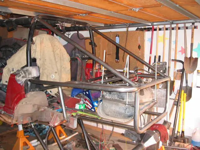

This is where it was last yesterday afternoon

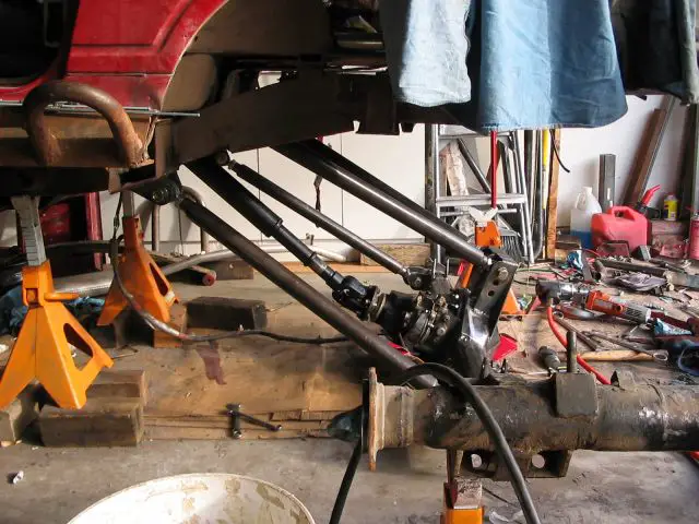

But this is the one that has amazed me.
The driveshaft installed; the axle is sitting on the floor, and the driveshaft is just starting to bind! It will never get to this point with the coil-overs installed; they are only 14" long.
attachment.php
At ride height, I nailed the pinion angle. This one was a guess; I was shooting for a ballpark under angle, so I could adjust the uppers and get it aligned.. At this time, I am thinking there is no need to do that, it's right on.
attachment.php

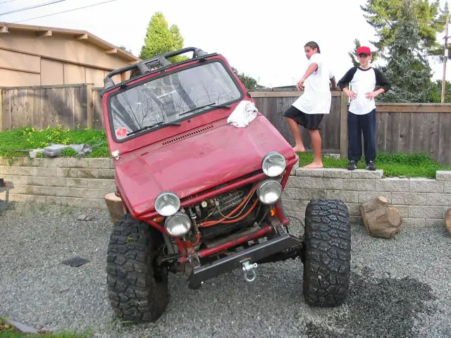

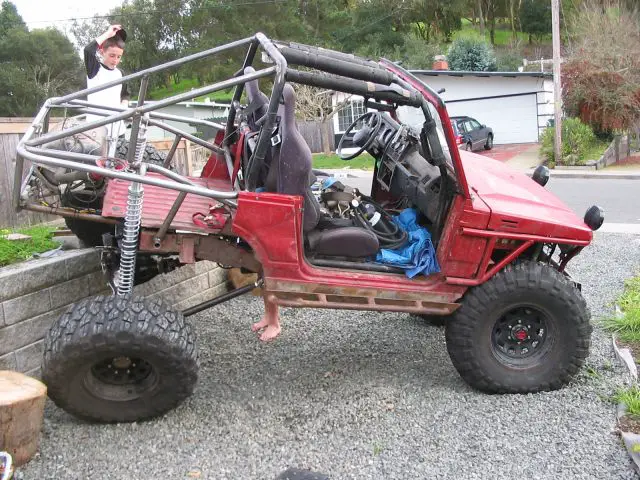

Poser shots..
And yes, the front end flexes as much as (or more) as the rear. The rear isn't maxed out at this point. Yes, there is still up travel in the the rear!

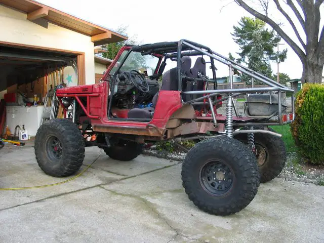

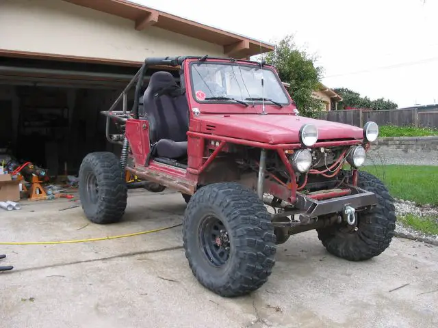

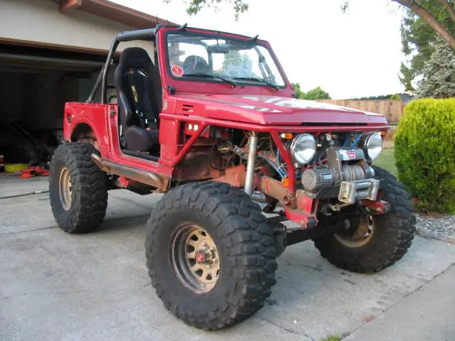

Finally got the ride height down to what I wanted it to be.
Had to use an 80/110 spring rate. Which means the rear end weighs in 600lb range, not counting the axle/tires. :eek:
Comparison shot - old vs. new. Old was pre-moab 2005.

We should do a Hammers Run, However I need a real axle up front first. :rolleyes:
