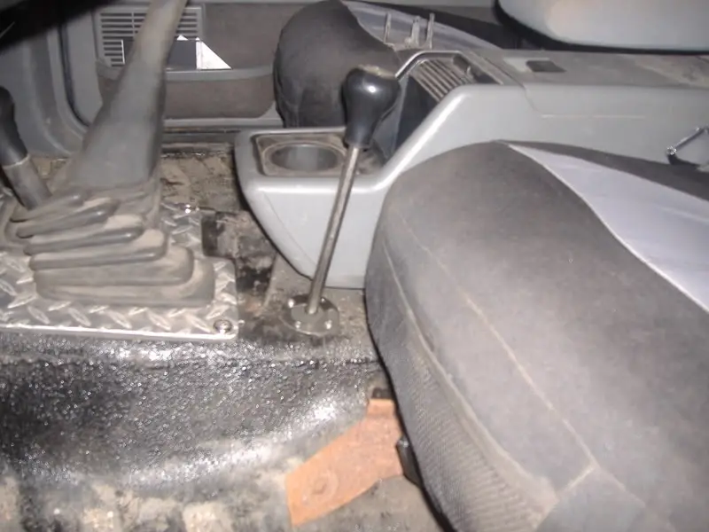

Here is my setup.
Currently still just flat stock.
But thinking about cutting them at floor level and then welding round stock and a knob to them.

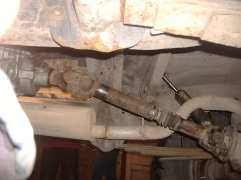

There all very creative. Got me thinking of one these Doublers. Just wondering about the driveshaft angle on a allready short B2 frame? This would be for a Daily driver also.
It's not bad. The rear axle is pushed back 1.5" from stock. With about a 5" lift.
haha thats a short driveshaft:p: thatnks for all the great ideas. I have some of my own so we will see what happens in the next week or so.
That's not bad at all. Thanks for the reply.

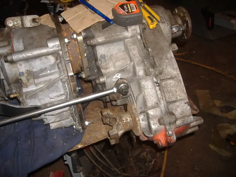

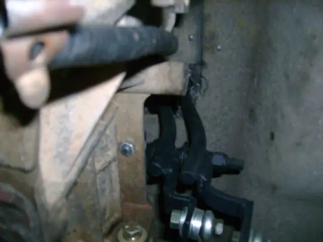

How did you get that linkage to point up, i was in teh understanding that you couldn't rotate thoes little levers.....
I believe if you open up the case you could rotate them to whatever point you want. Or just make new ones to point any way you want.
Yes if you open the case you can clock the shaft a bit. The shaft has a 6 tooth spline so your left with only 6 different positions. The doubler leaver I made, cuz I had clocked the pin the same way as the rear case. And I didn't care to pull the case apart to get a parallel lever position so I just made it the way I wanted, besides it needed to be longer so it worked out to my benefit.

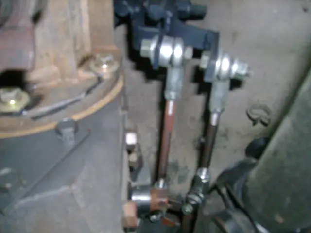

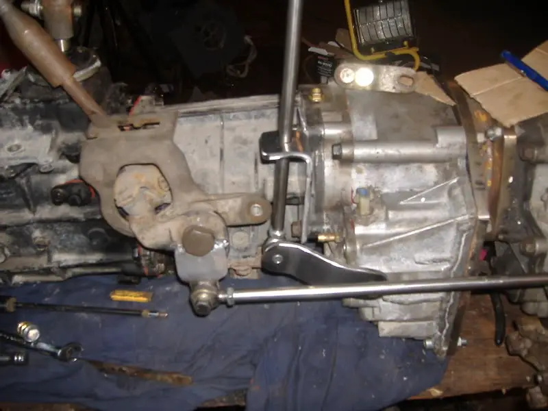

Its been a few weeks since I've been able to work on this project, but I got some done today. I got the shifters pretty much figured out I think. Tell me what you thing.
I have to go get some solid dowl steel for the shifter levers and break out the torch to bend them up, but it all seems to be working well.

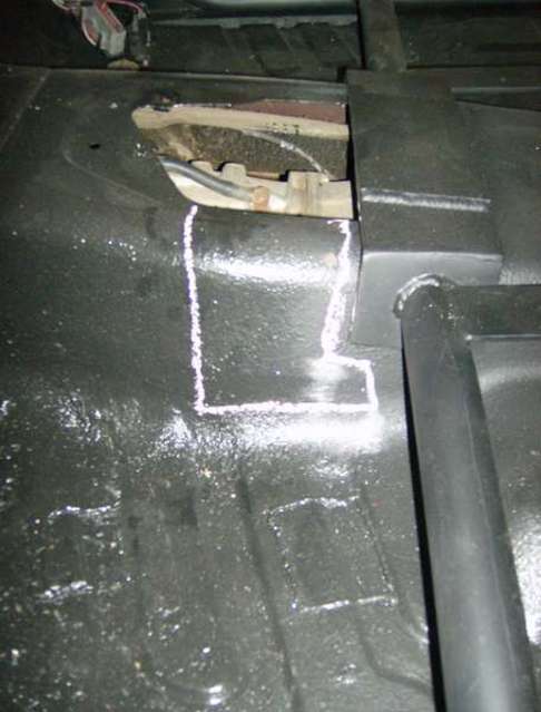

Because of the amount I have to space out the levers from the side of the trans shifter mount I have to cut a lot of the floor out.
I have some thoughts on how to clean it up, but you'll just have to wait and see:p:

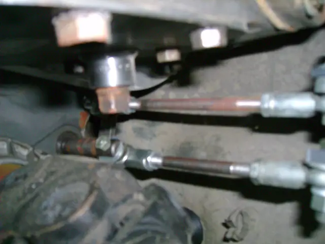

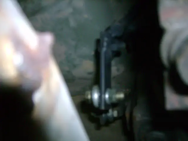

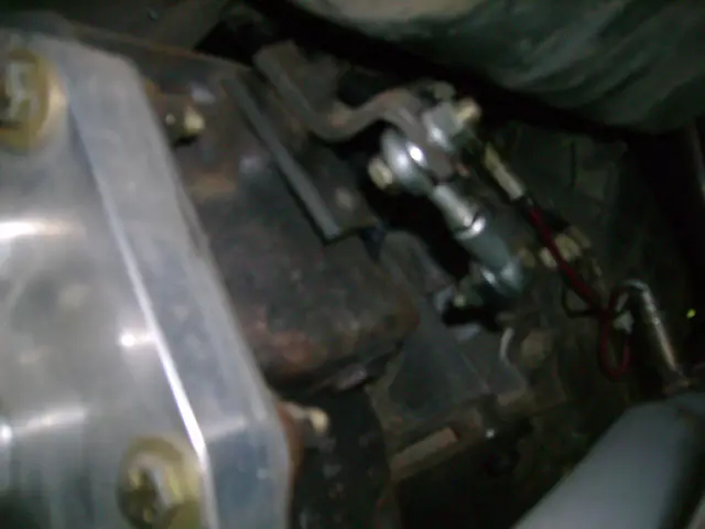

got the floor cut and the shifters in. also the crossmembers for the tcase and the tranny
this is what supports the rear of the tcase. It bolts in where the stock vibration dampener bolted in and there are poly bushings on each end of the cross member.
this is what supports the transmission in the stock location. It bolts up on the frame also in the stock locations. I just made it so it would go over the front drive shaft so it will clear.
you can see the shift linkage but its really hard to get a good picture.

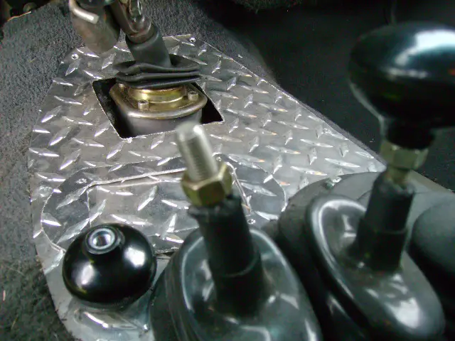

and the bling. I plan to use the stock shifter cover and block the hole I cut in the floor with some rubber. then the boot to clean it all up.
