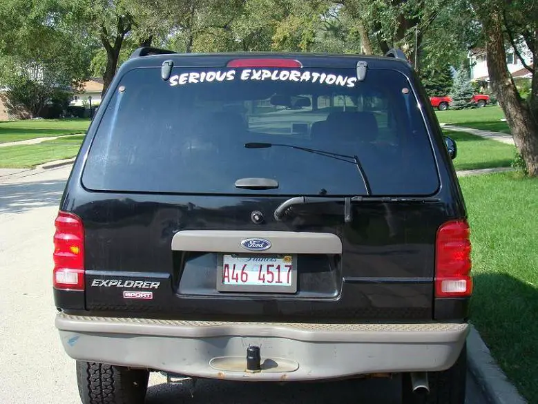

Some of you guys know probably that I've got to stay busy. My Un-Limited is all done so I need something to play with... and got myself a new toy... very, very neglected 2002 Sport.
I can't believe that someone can postpone service that much and just keep on going not fixing stuff... untill the moment when the truck simply stops working...
Doesn't look that bad - except for some dents and bruises...

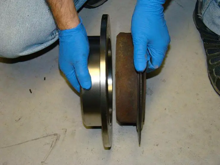

First I have to fix what needs fixing. It had no brakes - after driving it home - with very limited braking I found out that one of rear brake wheel cylinders was stuck and the other leaked brake fluid. Front pads are run down. Picture of rear rotor attached. Have to fix a vacuum leak... and clean-up. Interior is even worse than exterior. Carpet is gone... gone... will probably replace it with something like Sport Track has on the floor, center console has had a part of it replaced and it's different shade of gray so I might just install a message center there... cut armrest, radio acting-up - no matter how you turn the knob volume either goes all the way up or all the way down... door locks don't work right, lift gate does not lock on the driver side, missing one key and no remotes...

Holy crap :eek:
I've never seen rotors that thin before...looks like you could almost cut glass with them!
I'm also surprised they didn't just fall apart either...
And if you don't mind me asking, what kind of deal did you score on that one?
holy cow I've never seen a rotor that bad in my life & i work at a parts store
Wow Dre. Looks like you saved that Sport from a slow, painful death. :D
nice explorer sport u got there dre keep up the good work
Holy crap x 3 on those rotors. Wtf?
that was driver side... passenger side was not as bad but probably due to the fact that passenger wheel cylinder was stuck.

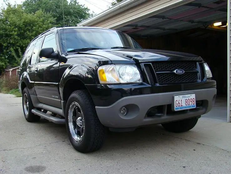

New addition to my truck...
