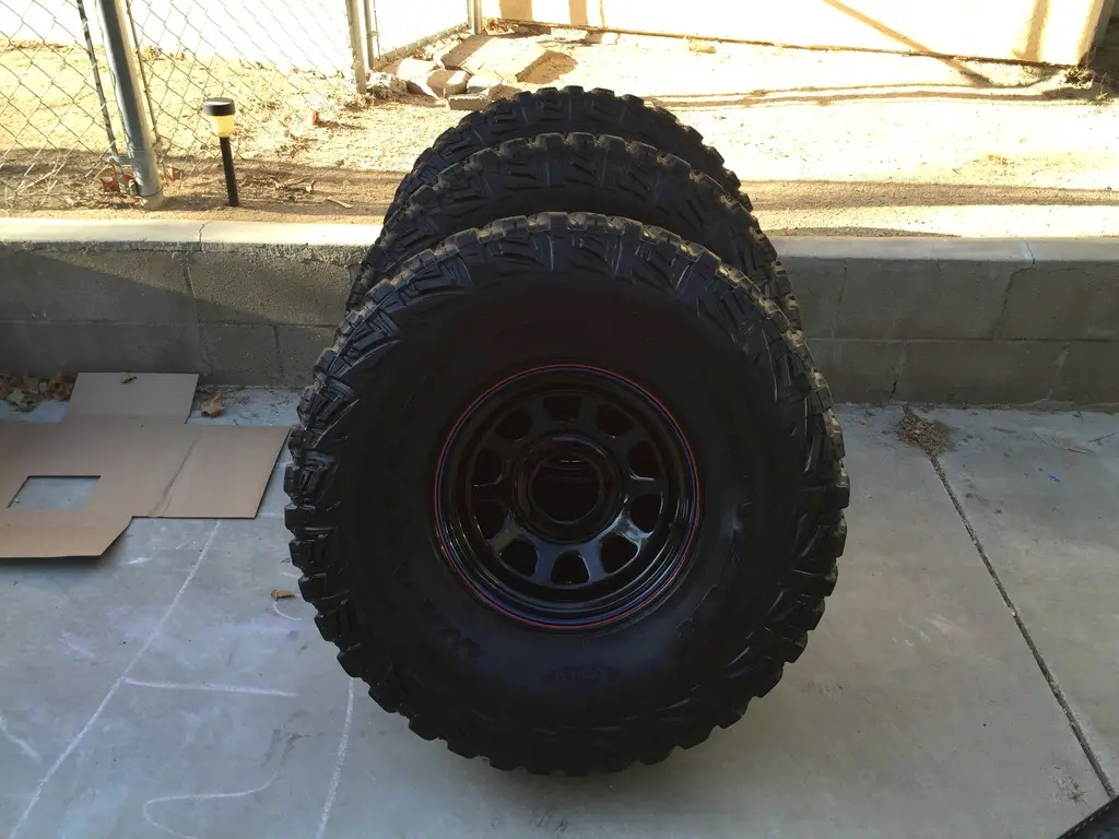

So for some updates, I decided to get new wheels since the ones on the ex are 15x10 3.75"bs and I wanted 15x8 4" bs. I went with Crager d windows.

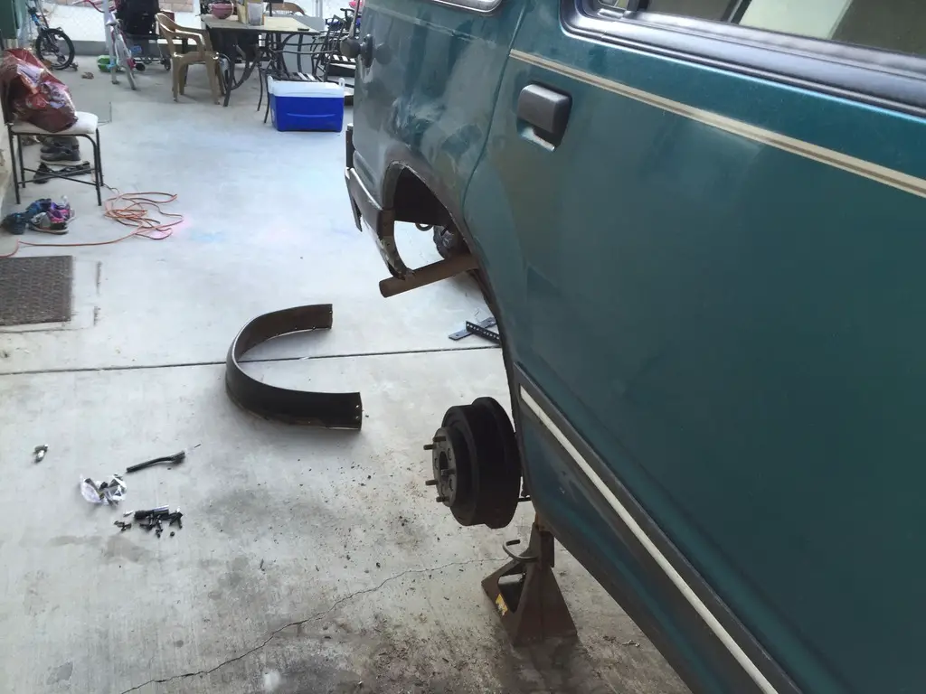

Look what I found when I pulled the drum off to check the back brakes. Funny thing is that the brakes worked pretty good. I have all new rear components, master cylinder, and I am going to do front brake pads while I have the wheels off. Do you guys think I should run the green stuff pads up front. I have never used them but I would like to try them. I will post pics of the new back brakes tonight. Thanks.
