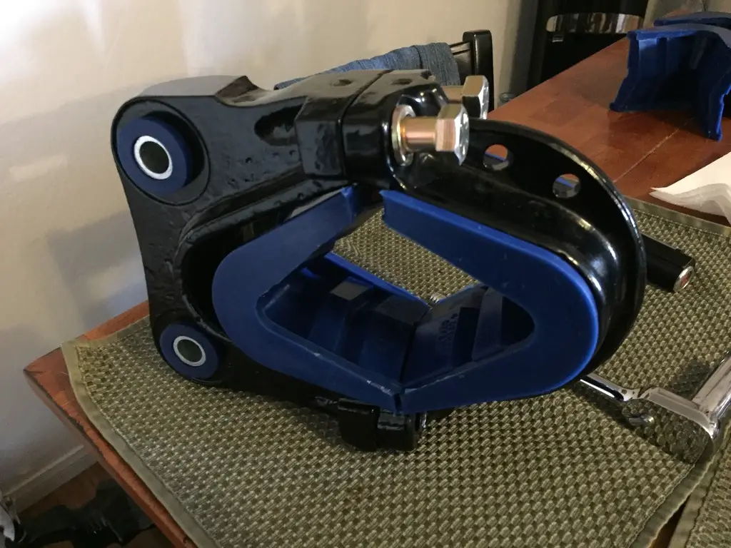

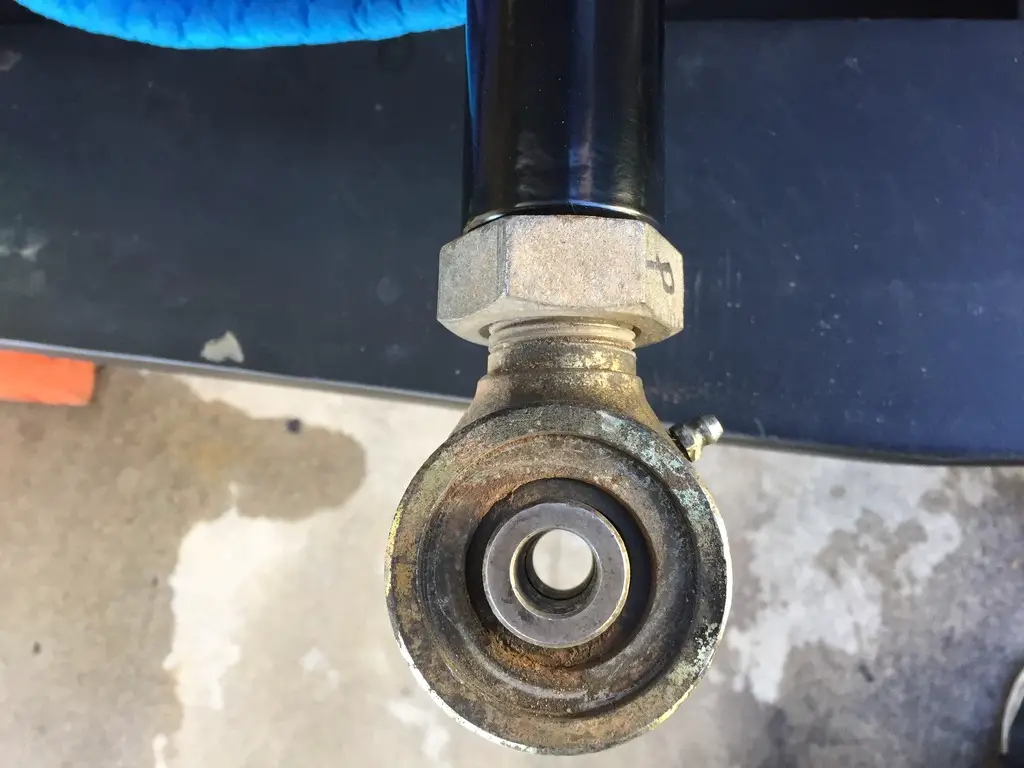

The cage head unit with new hardware and 4 degree James Duff bushings.

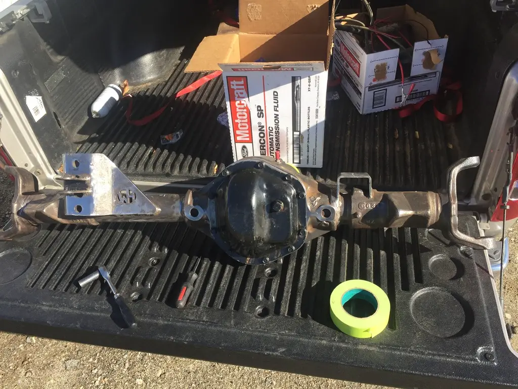

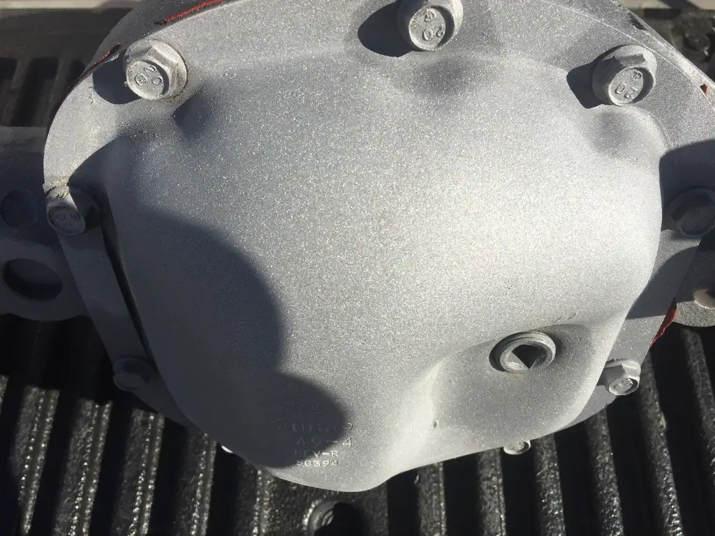

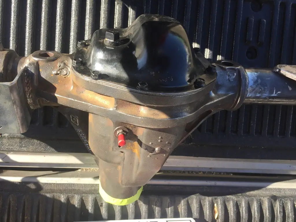

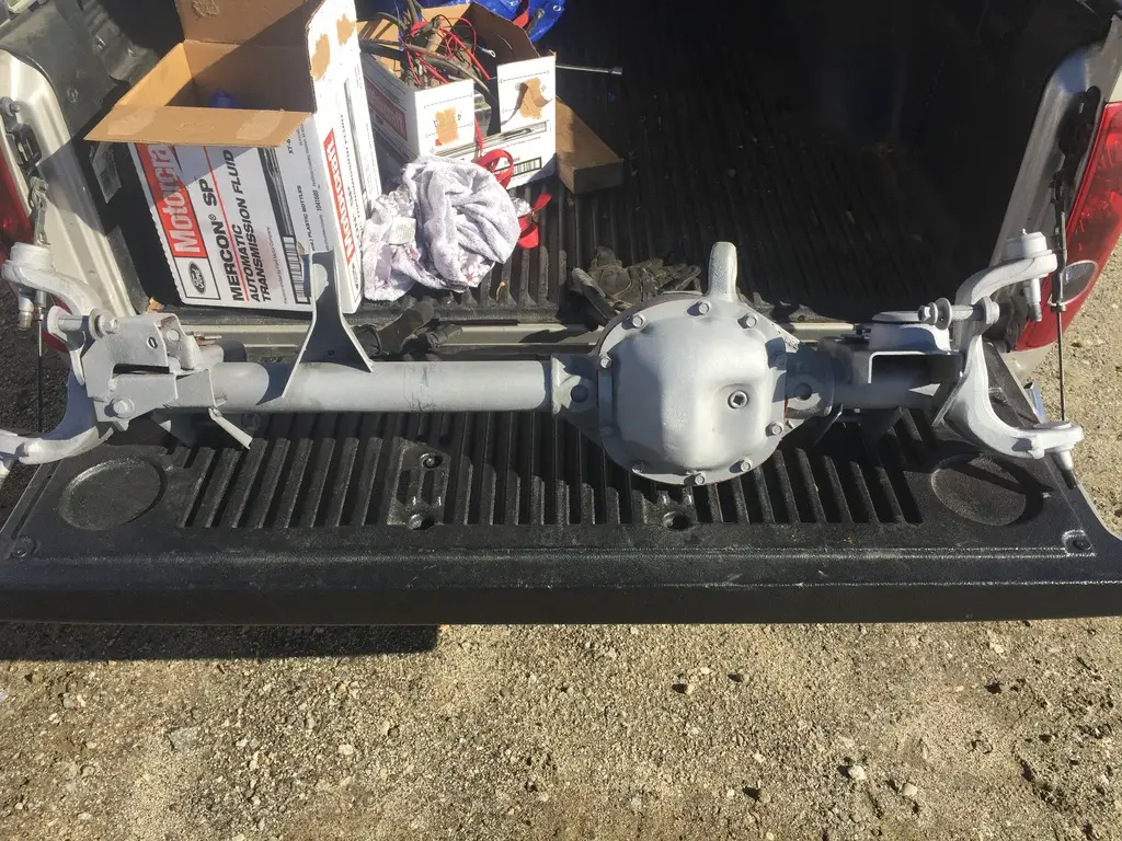

I have had my front axle back from getting repaired for a while now and I finially got around to getting it cleaned and painted. I took the housing to a place in bakersfield and had the housing dustless blasted. They did my axle and my friends Dana 30 for $100.00. This was so much better than wire wheeling it. These are before and after pictures. The axles look they were painted grey but that is just bare metal.

Good luck, the 30 is ok. My friend has 35's 4.56 and lockers in his XJ and his axle seems to be doing ok. He is a much harder driver than me also.

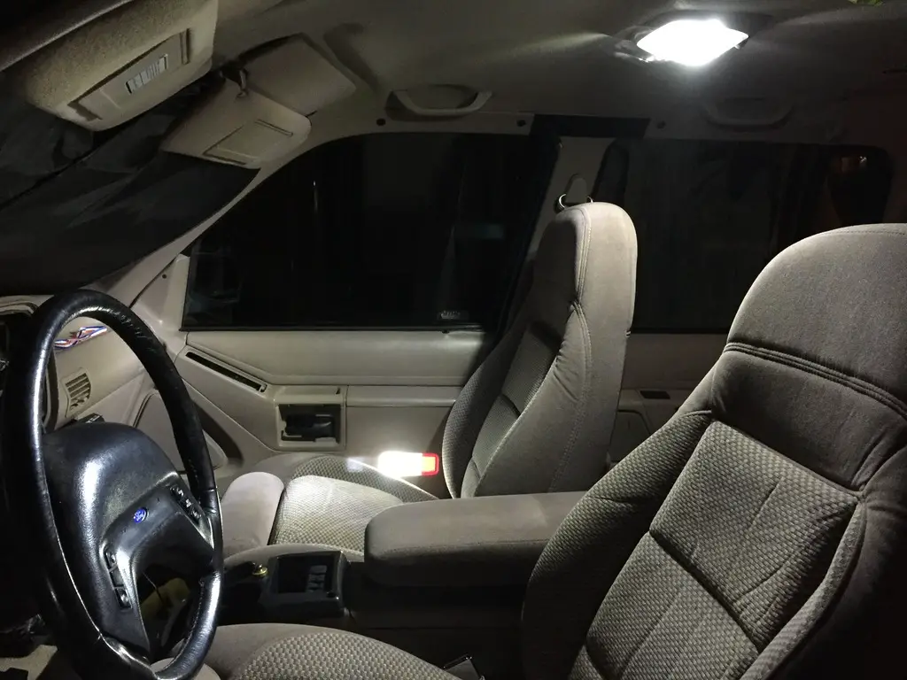

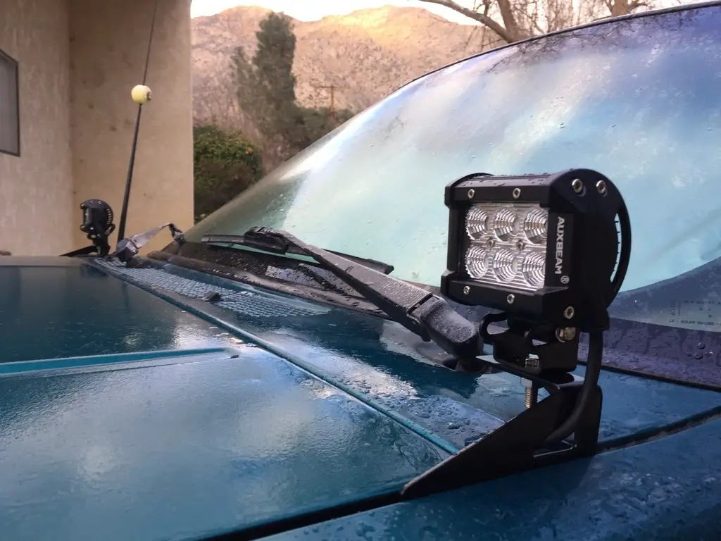

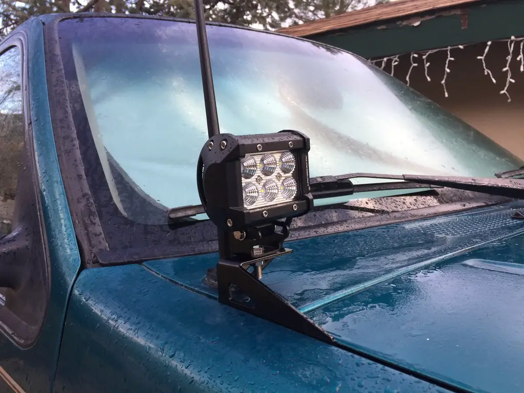

Did some light upgrades this evening, I had already done the interior lights with led bulbs which made a huge difference. I also got around to installing the Brian1 pod brackets that go behind the hood. I will take pictures of the lights installed tomorrow when there is more light.
Links to lights I used:
Interior led bulbs
https://www.amazon.com/gp/aw/d/B00MAG6RMM/ref=mp_s_a_1_1?ie=UTF8&qid=1486100165&sr=8-1&pi=AC_SX236_SY340_QL65&keywords=194+led+yorkim&dpPl=1&dpID=51ukdo0+lAL&ref=plSrch
The light pods I used for my hood mounts. I may buy two more sets of these for rock lights.
https://www.amazon.com/gp/aw/d/B00T...ds=Auxbeam&dpPl=1&dpID=51ihCg6IDsL&ref=plSrch
DUDER 1
September 11, 2009
416
68
Nomad
94 XLT

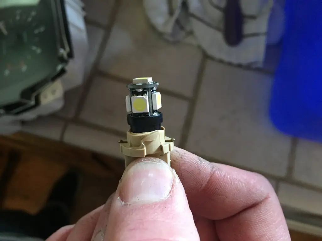

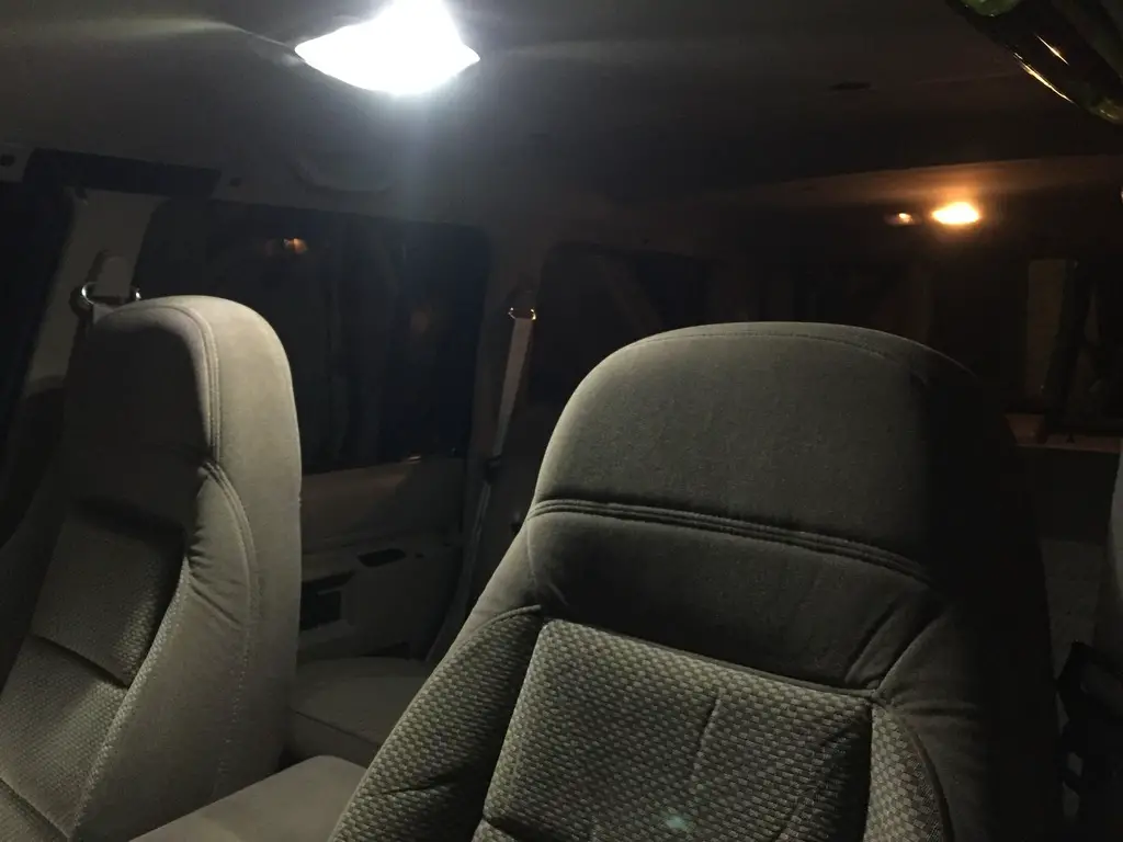

The first two pictures are the interior led bulbs and the third is the Auxbeam light pods. Those little lights are pretty bright.

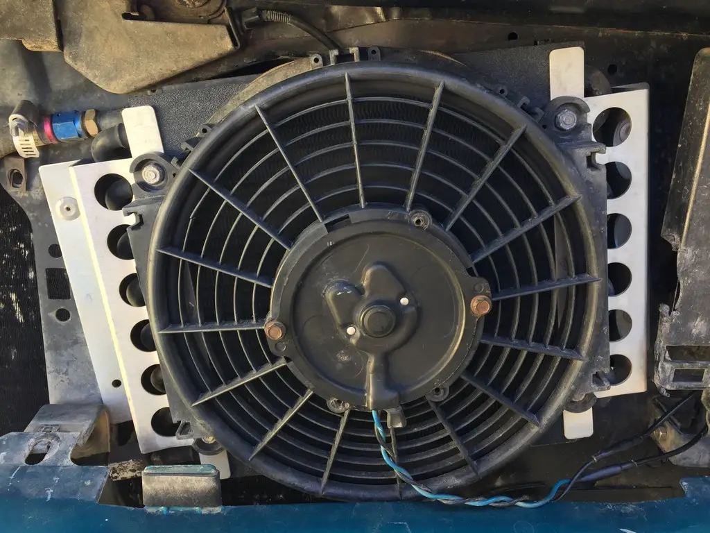

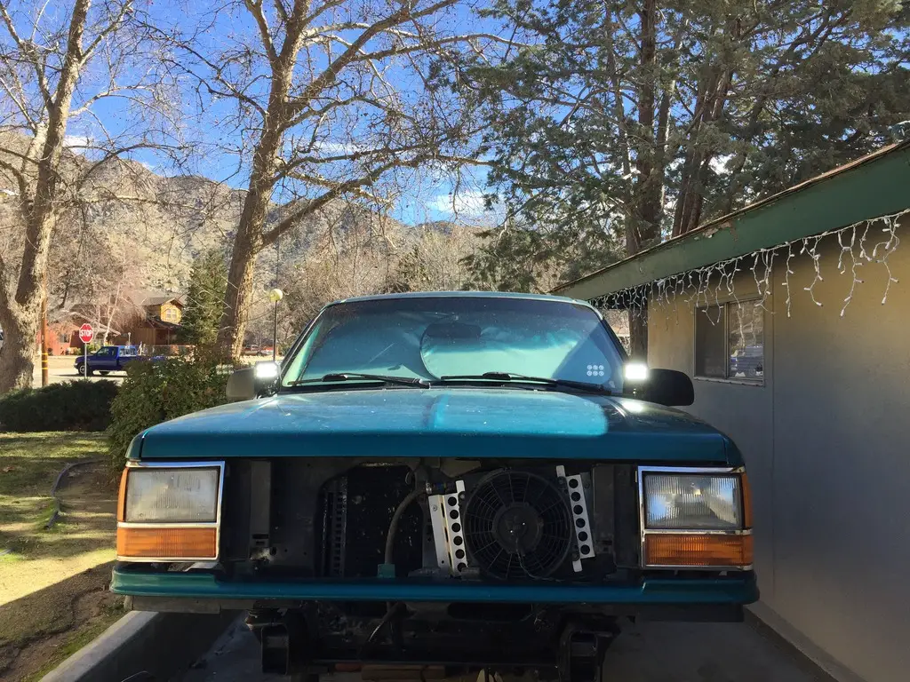

Made some progress, I made sure my lights worked lol. I re wired my transcooler fan motor because I think the previous owner had it wired to pull air not push it.

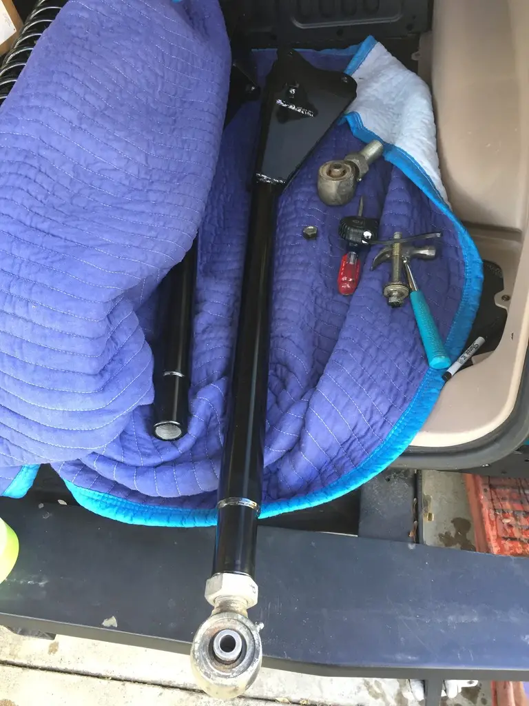

I also put the passenger side coil bucket on and the passenger radius arm. I reused the Johnny joint because it was still very tight. These joints are very tough. I also put led lights in my instrument cluster which I will take pictures of later.

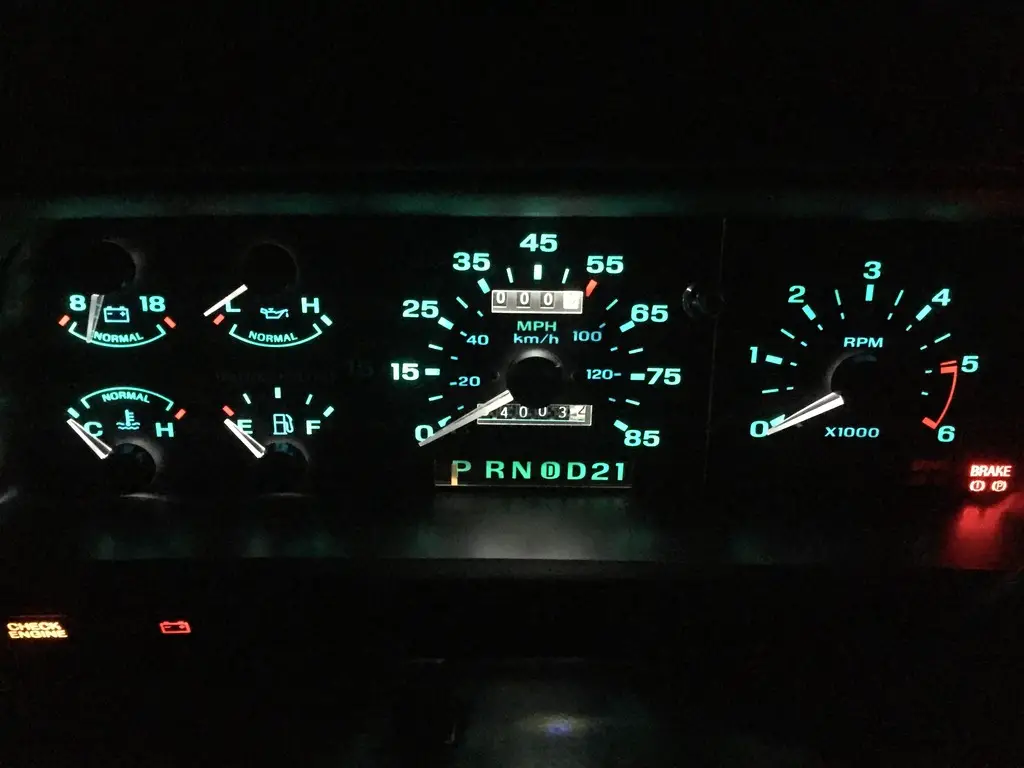

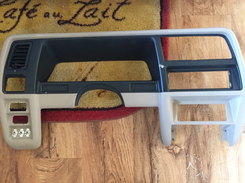

Worked on the dash a bit today. I put a new speedometer in while I had the cluster out. Napa had one for about $20.00.
DUDER 1
September 11, 2009
416
68
Nomad
94 XLT

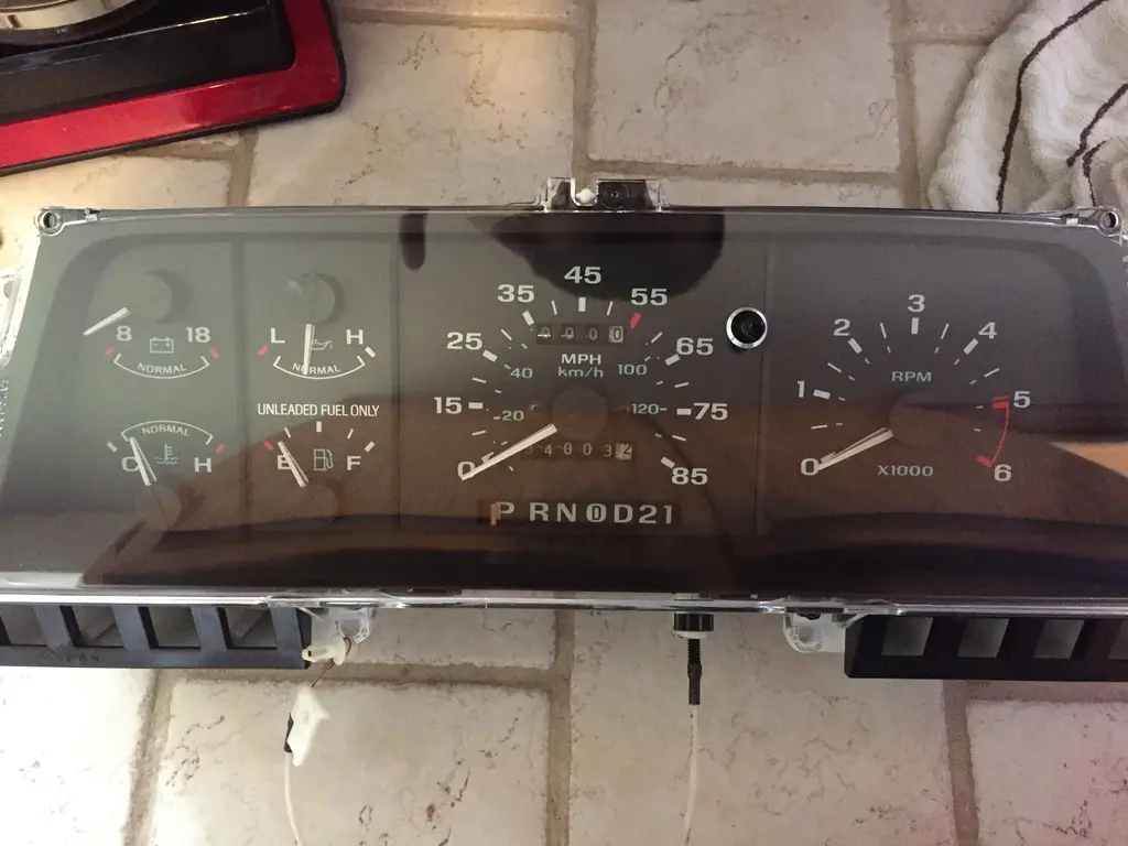

Here is the cluster with the new led bulbs. The gauges are much easier to read now. I had at least one bulb out before.

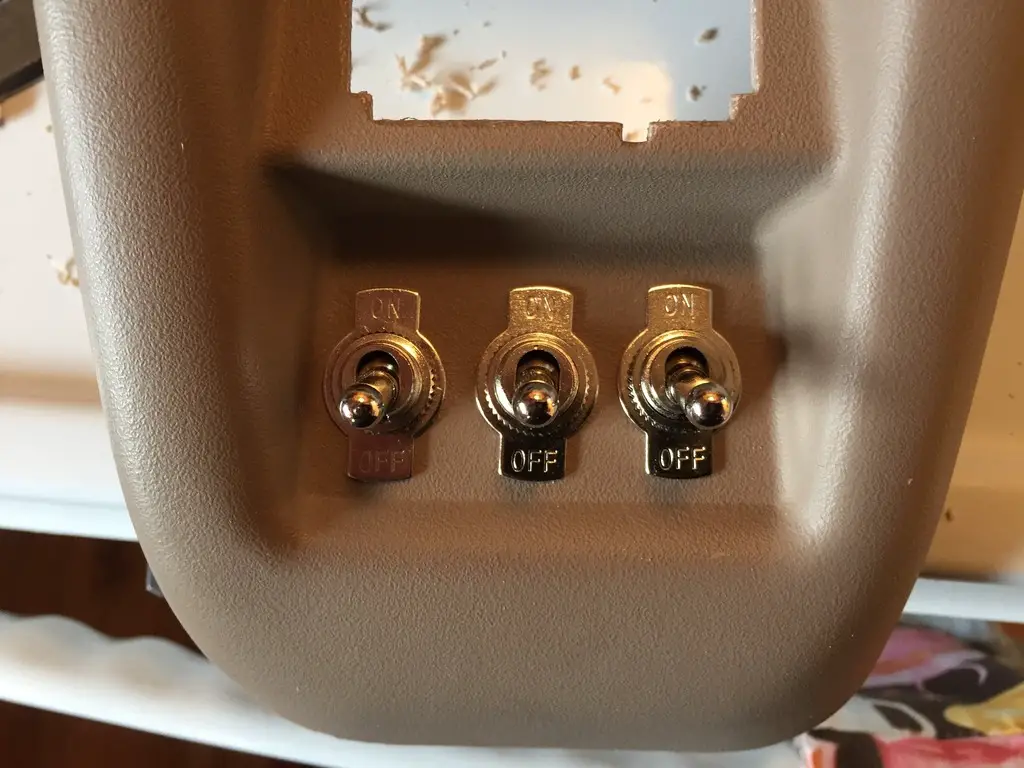

Added some 3m Walmart switches. One is for the light pods, one is for rock lights in the future, and the last one is for a future light bar. I did this mod the other day and it took maybe 20 minutes.
