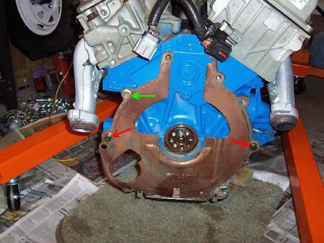

Take a look at this picture...
Does your plate look like this one? If so, this is not as bad a situation as you might think...
You will need to remove the engine/tranny bolts and loosen the tranny crossmember mount bolts and use a prybar to seperate the two pieces to slip this plate into position...
I fought this POS while installing the shortblock and wished I had left it off until I had the two together...
It can come in from the bottom of the engine and opening up the space to get it over the dowels with a prybar will get it into position...
Damn I am sorry to hear that though...But this is a minor deal.. Really it is...:D

I disconnected the exhaust, starter and engine mounts. Removed the tc nuts and engine/tranny bolts and lifted the engine a few inches up and back. Put the **!!@@** plate in and put it all back together. The worst part again was getting the engine lined up and mating the bushing and tc studs.
I am pretty happy that it only took about 4 hours and I'm back to where I was....well almost. Still have to torque it all back up and connect the exhaust.

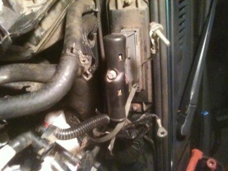

help...where do ground wires go
One of the first things I did was disconnect the pcm and remove the hood. There are 2 ground wires and I can't remember how they go.
1. Short black ground wire that comes out of the pcm harness.
2. Long Braided ground strap attached to the passenge side head.
The reason I am confused is that the long ground strap has a stud with a double bolt on top. It looks like it would be used to hold down the pcm connector. The short pcm ground wire only has a term lug so it "appears" to be made to attach right near the pcm.
There is also a loose nut on the wiper mounting stud which has green (electrical) lok-tite on it, like it would accept the term lug.
PICS below
Seems the opposite of what it looks like.
Could I have mistakenly put the stud with the braided ground strap?
Does it really go with the short pcm wire harness instead?
Is there a regular bolt for the pcm mount bracket?
Does the braided ground strap mount on the wiper stud?
And finally, doesn't the hood have a ground wire?
I'm so confused!!!!!!!

Awesome. Thanks
