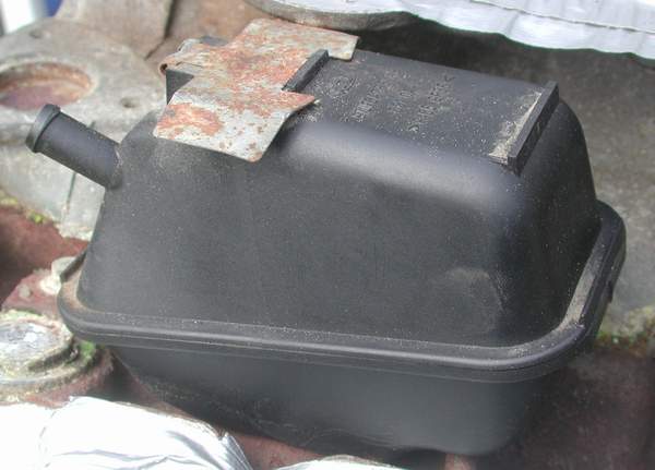

mustang vs explorer breather
I doubt that the Mustang has the crankcase breather shown below.
I believe there's a plug in the Mustang where the breather attaches.
Is it possible to utilize the mustang valve cover with the breather on the valve cover instead of using the EX breather?

breather on mustang motor
It's a real easy fix if you just use the explorer valve covers.
There is a plug in the mustang block where the breather goes. Just punch a small hole and pry it out. the breather box fits right in. If I recall (but my memory is getting weak with age), there are other fit problems if you try to use the mustang valve covers. I think the coil support for 1 thing. I would use the ex covers and breather box. Best fit. That's what I did.
1 year in and still going strong with the pony motor.
Good luck
Good luck
This is what I was looking for, I wasn't to concerned with taking the freeze plug out, i was thinking about keeping the stangs covers, no biggie- scrap pile:D
I hope to have my motor here in a week so in a couple of weeks I will be rollin pony style.
Great write-up! Thanks for the support.
