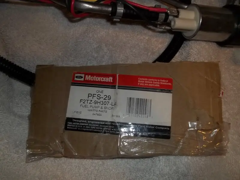

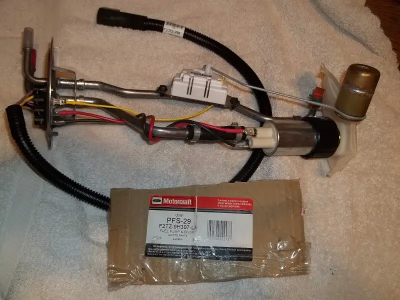

Thanks everyone. Is there a big enough difference in buying the motorcraft pfs-29 over one of the cheaper ones?
