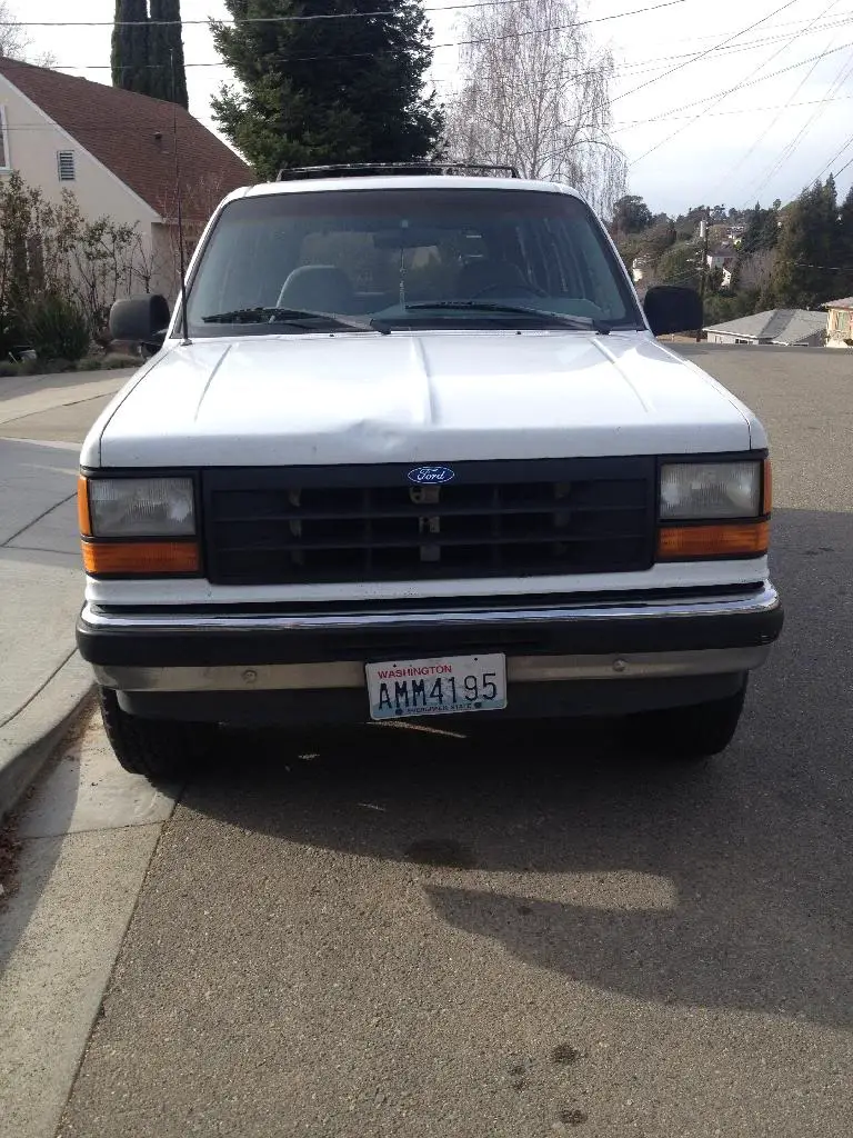

Also here is a pic of yesterdays project of blacking out the grille and headlight trim
