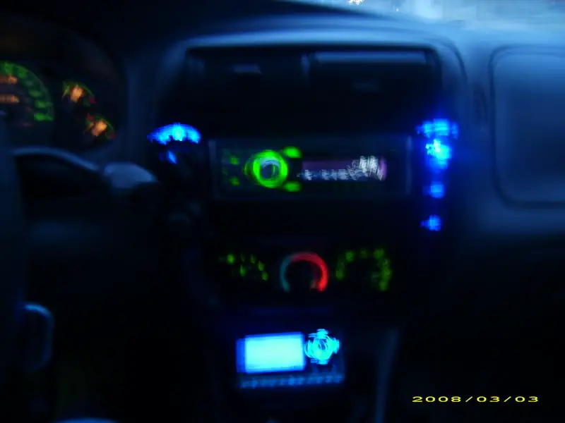

actually you will not hack up you switches at all unless you are a complete knob. here is the led conversion outcome i did the defrost but it was done after these pics. i know they are not the best i will work on it....

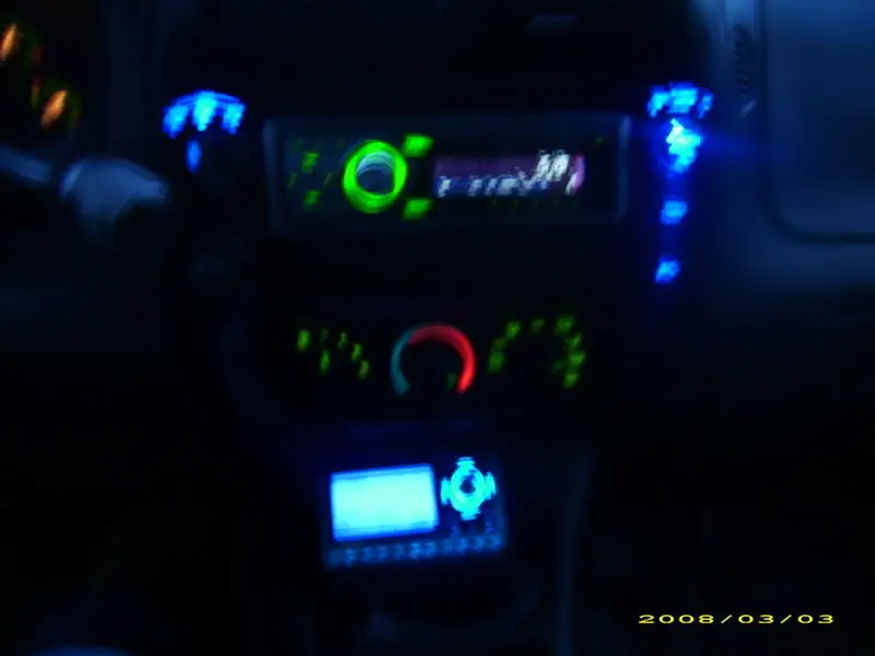

just did part of mine heres the pics
little camera tip when taking pics like this, turn the flash off and have the camera sit on something steady so it doesn't move, put on the 2 second timer so when you click the picture and take your hand off it'll give you a few seconds to move your hand, also go in the "tv" mode (full manual) and change the shutter to 2 or 3 seconds and see how the pics turn out.
hope this helps some of you guys
Looks good.
As for the camera, increasing the exposure time is one good method, I would recommend setting the F stop to the lowest number possible, this increases the cameras aperture, and lets in more light.
looks great keep up the good work.... did you grind the heads of the leds
i do not grind my tips off, i cut the tips off with dikes, because grinding leaves the top kinda hazy looking where as cutting/snapping it off with dikes makes it clear.

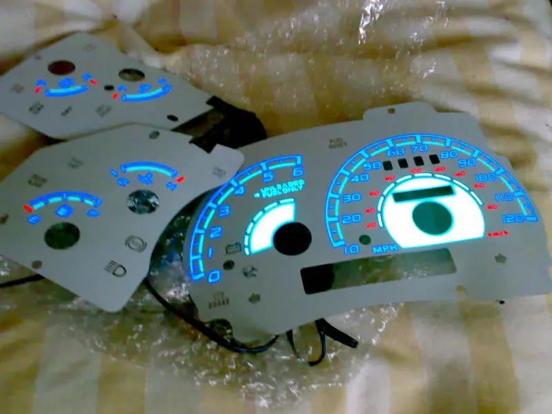

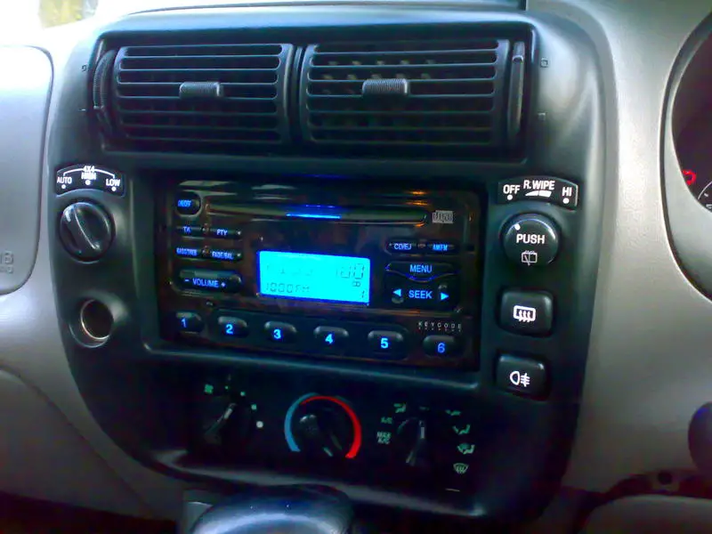

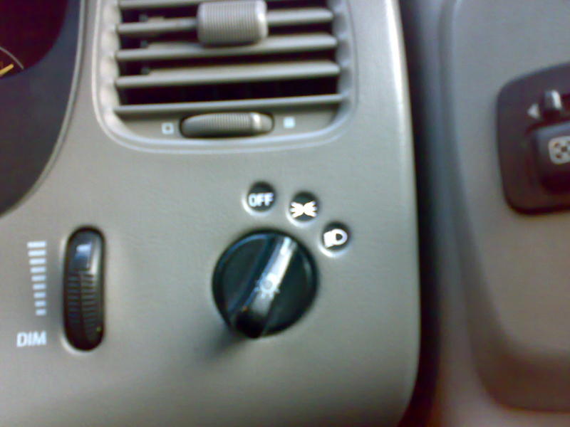

heres mine in white, yet to finalize the heater controls and shifter lights (UK spec) iv bought white dials that glow in dark to solve trhe green film issue and look much better, dont foget the bulb in the headlight switch.
