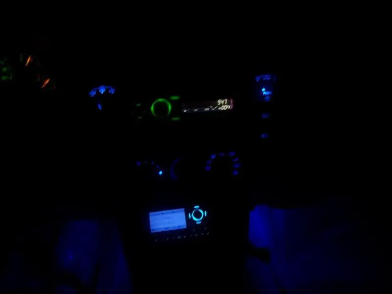

Just an Update for everyone

looks good...my only problem with changing my gauges i want all blue but i cant do it with out buying indaglow gauges

i didn't even know that the headlight switch lit up. mine's been burnt out since before i bought it.
now that i have that bit of info i think i might have to give the led conversion a try
btw those blue switches and needles look pretty good
btw those blue switches and needles look pretty good![]()
Haha same thing with me, I had my explorer for almost 6 years when I read that the headlight switch was supposed to light up. Never realized it.

so where did the wires from the led for the fog and defrost run to? i can't figure it out so p51 if you could help?
I got power from the wire that use to power the bulb inside the rear wiper switch.

I don't have any pictures of that. If you look at the harness that plugs into the rear wiper switch there will be 4 wires (if I remember correctly) one of those wires will be red with a black stripe. That is the wire that you need to cut and then wire the positive leads of the LEDs to. Then Just ground the negative leads of the LEDs.
