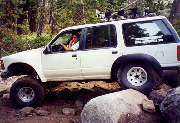

A 4" with 35s is the way to go. Just be sure to get some sliders made or you'll bash the rockers.
This is my old one with that setup. I took both sway bars off and it was my daily driver/froader for 3+ years.
With trimmed fenders (I had fiberglass and the rear doesn't need it), it will work great.
Thanks for the info and cool pictures froader.

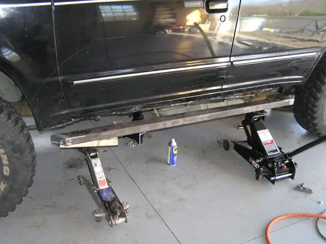

Rock sliders are "basically" heavy duty nerf/step bars that protect the lower body panels between the wheels from rock damage.
Rock Sliders being installed:
Fully installed but not painted:
the very bottom trim of the body between the wheels, below the doors is called the "rocker panel" I don't know why except that they often get bashed buy rocks. So thats what froader was talkin about
