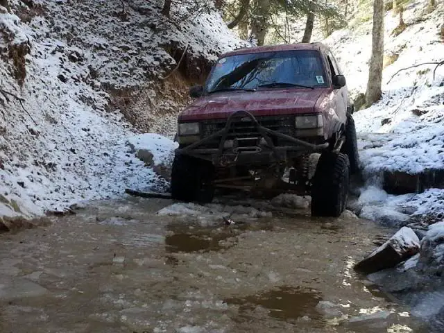

winter wheeling in West Virginia..

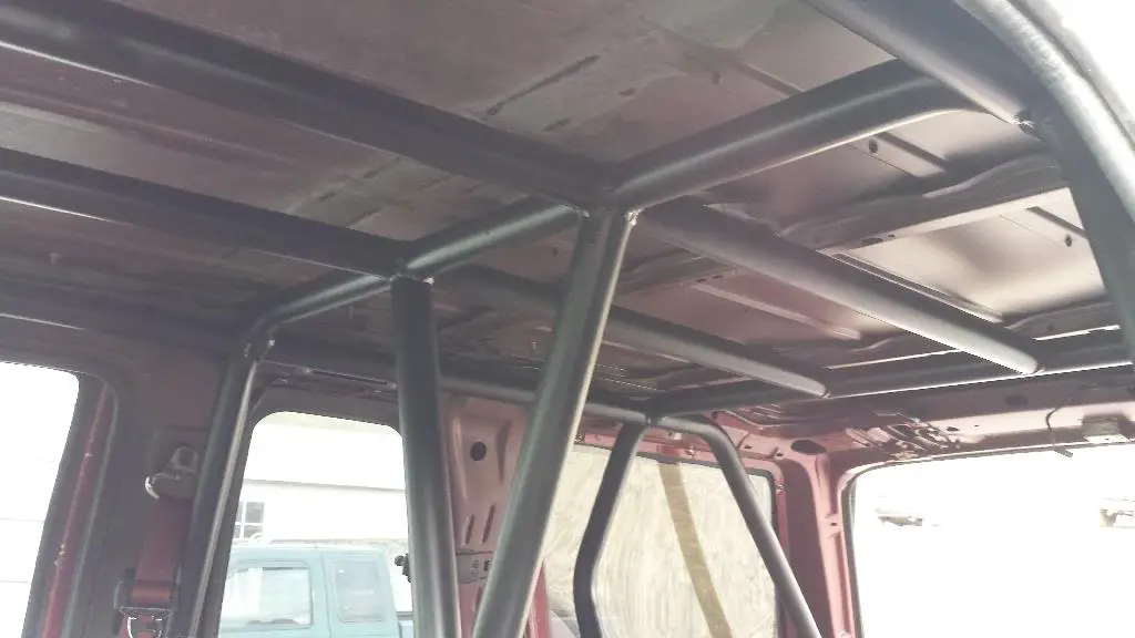

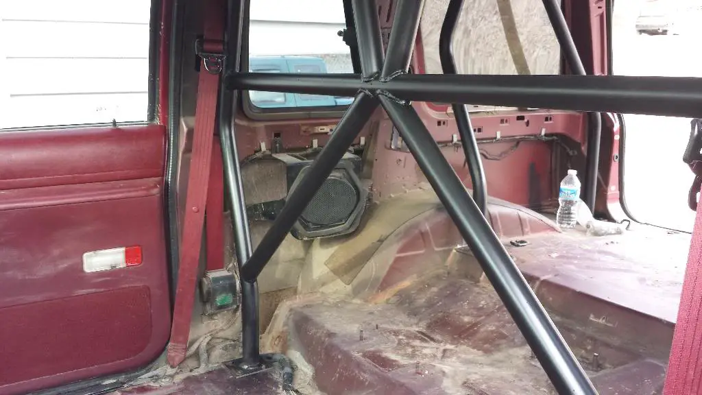

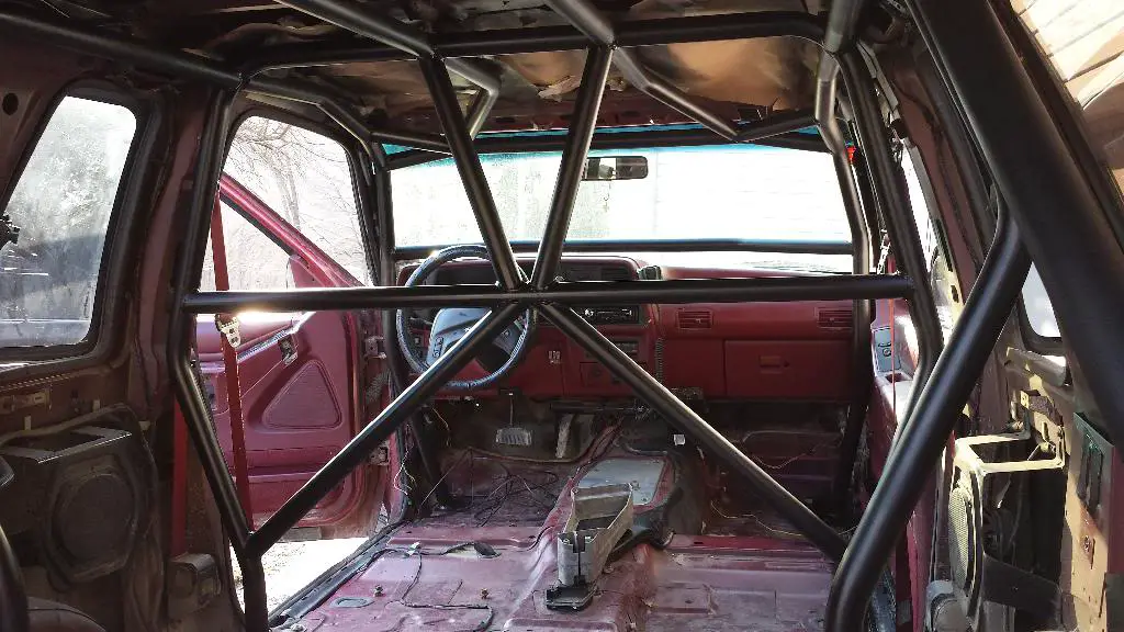

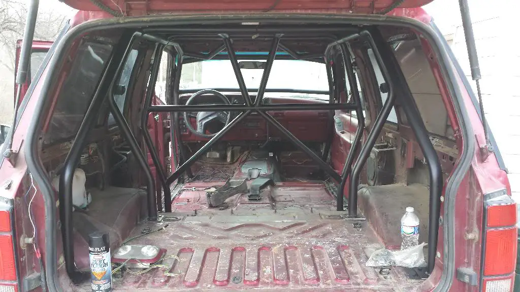

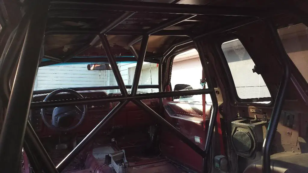

I havnt forgotten about the cage.. fab guy was backed up. goes down this weekend. all i need to do to get it ready is get the pass side seat belt anchor bolt out. tried everything.. not the head is stripped.. stupid torx bits
Pipe wrench
I use a cut off wheel and a grinder to cut the head of the bolt from round to square sides to get a wrench onto it., try this and a small propane torch from underneath to heat up the factory loctite.

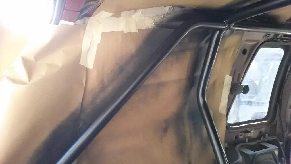

used a cut-off wheel, cut the head of the bolt off.. carpet was only on fire once, luckily theres 6 inches of snow outside so putting out the flame wasnt hard. shes empty.. shop vac tomorrow
Yeah you might wanna remove the carpet before welding in there. LOL
carpet was out of the truck all night.. on interior whatsoever.. opened the door today and the truck reaked of a burnt match smell. nothing was cut, burnt, other than the carpet which was removed. hmm

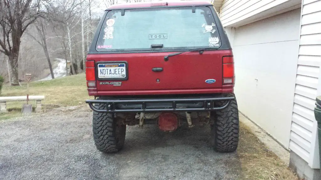

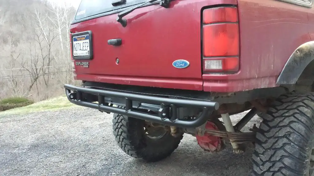

i do not miss the swingout rear bumper at all.. its so nice to look back and actually be able to see out of the rear window. i am also a fan of not having to open the swingout to get raise the hatch or glass.
hopefully this fall the piece of junk will get 2 more cylinders in the engine.
small update.. just noticed yesterday that the only panel on my truck that is NOT dented, rubbed, or pushed in is the rear hatch. then i realized that was because of the rear swing out..which is gone now.
