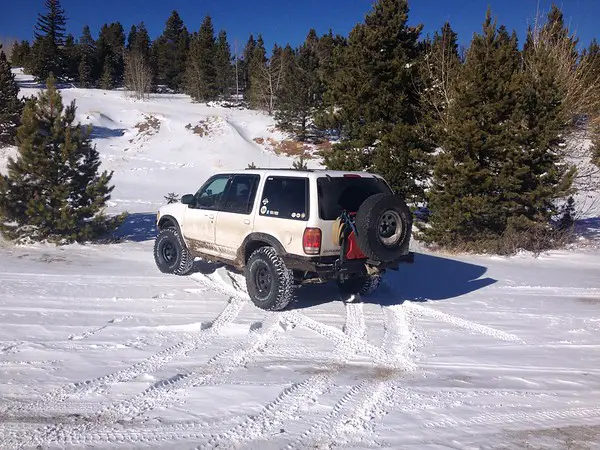

Put a new set of BFG All-terrains on the Ex, here it is in it's natural environment.

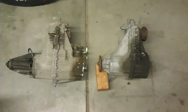

Transfercase swap
I finally dug in. Low range here I come.
Will it fit?
Interior prepped.
Hole cut in the floor for the shifter.
Trimed and cut and used the factory F150 inner boot. Had to add a strap to keep the rubber from pulling out but works well.
Reinstalled the interior and took the Ex out and the swap is complete!!!!!!!!!!!!!!!!!!!!!!!!!!!!!!!!!!!!!
Not sure if this was asked but was this a direct bolt on or was there something that was needed to be completed?
By the way love how it looks. Will be building my 96 soon.

How are you liking the new BFGs?
I think they are better in the snow than the KOs, It always feels so good to have new tires.
If you do a search for "4406 swap" you will find many writeups, It is a direct bolt in with the appropriate Ford parts. I couldn't be happier with this swap. I've been running and wheeling it for 3 years now without an issue.

@worms92explorer I could be wrong, but I believe the 4406 only bolts to the auto trans behind a 5.0, which starkman has. If you're asking about it for your 1st gen, you want to look for a BW1354, or a BW1350. Either one drops in and gives you a manual shift tcase. I did this swap with a 1354 on our 94 sport and it works perfect. Some Bronco II's had the BW1350 but yo need to watch the front output on them. You can however use a 1354 and 1350 to make a doubler.
Thank you si for the help. I have a 96 not a 92. I got rid of the 92. But thank you for the info. I will be on the hunt for either a 1354 or a 1350.

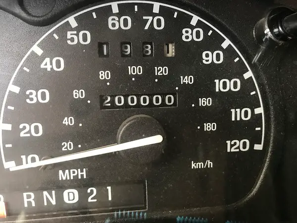

Y2K 200K Father's Day
I think its fitting to turn over 200,000 miles on an off road run. This vehicle has been the must enjoyable vehicle I've owned!
Congrats on the milestone!! Clean up run next Saturday with Front Range 4x4, just up in Idaho Springs. You should join us if you're not busy, would be cool to get a bunch of Ex's on that run and rival the heep numbers. And would be great to see you and run a trail again.
Looking good for that many miles on her. :-)
