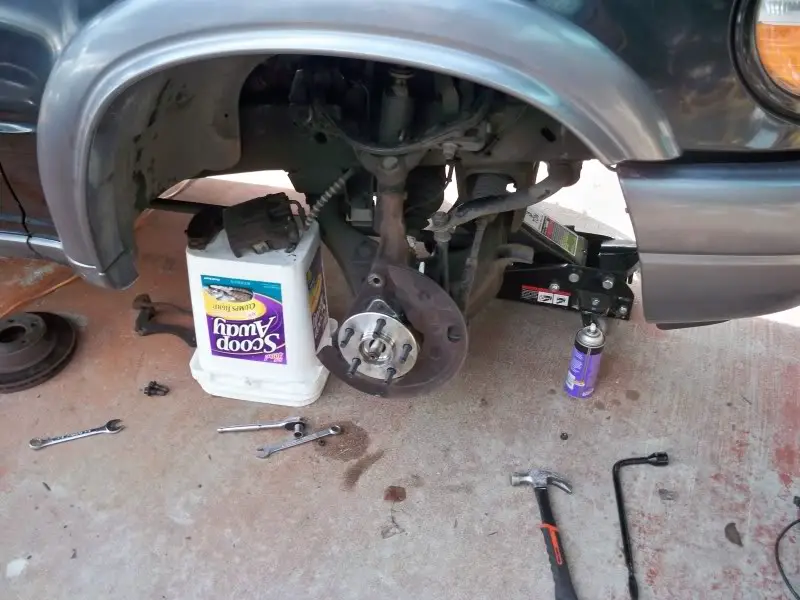

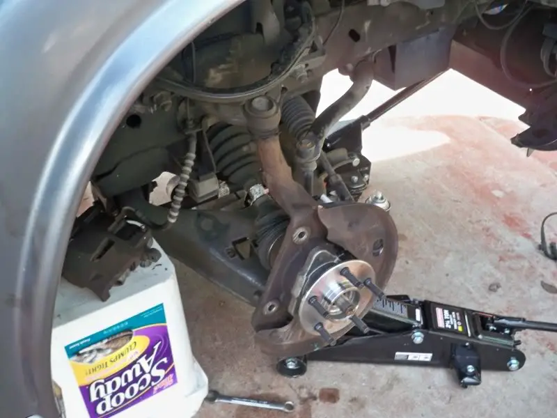

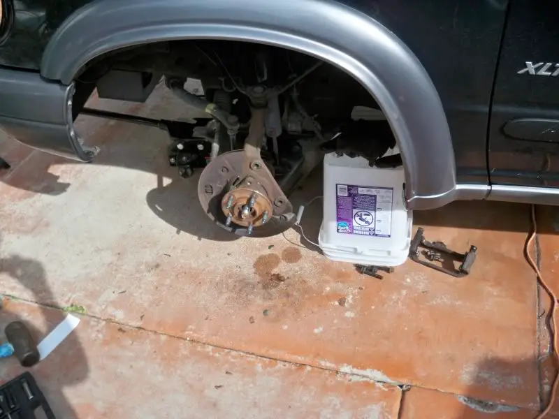

Finished getting the brakes bled with the help of my Dad (gotta love Engineers). Brakes are better then they were before. Got the new wheel hubs on, swapped front shocks. I'll be posting pictures when I get home.
