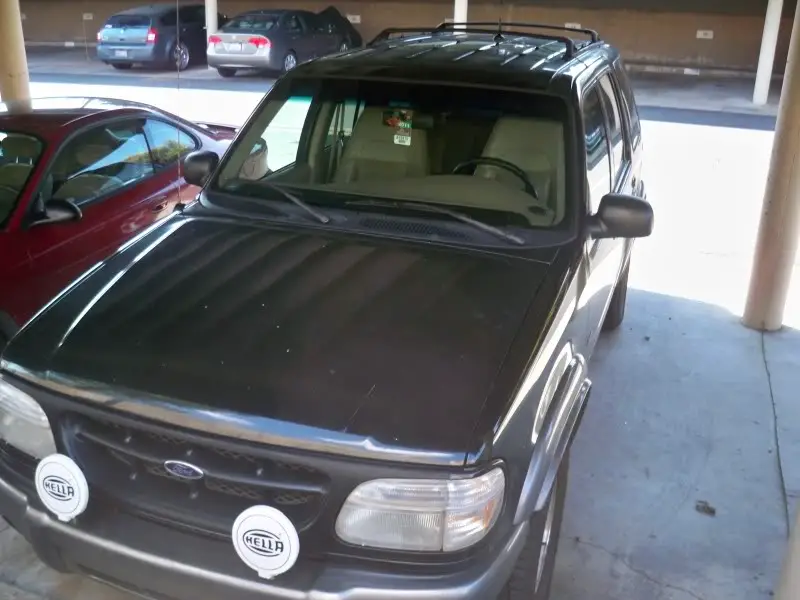

Welcome to my new registry. This is my 2000 Explorer XLT. Bought it from the original owner for $3,400. Came with the owners manual, and the paper work to prove it's been dealer maintained. When I purchased the Ex, it had 111,000 on the odometer, a small tear in the leather of the drivers seat, some sand in the back( take it the guy was a surfer, found a few surf board fins in the jack storage area). Gonna do a alignment when I get the chance, and start transferring all my mods from my Sport into this.
As she stands when I brought her home.
How she currently stands.

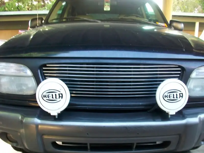

Got myself a set of Hella 500's wired up and working. I've got to get them aimed properly, but the mounts they are on are slightly angled, may have to do a little bit of work on the body of the lights. Right now I've got the switch taped to the side of the CB in the dash. Right not I'm thinking that I may get a piece of sheet metal and cut the appropriate holes for my CB and switches.

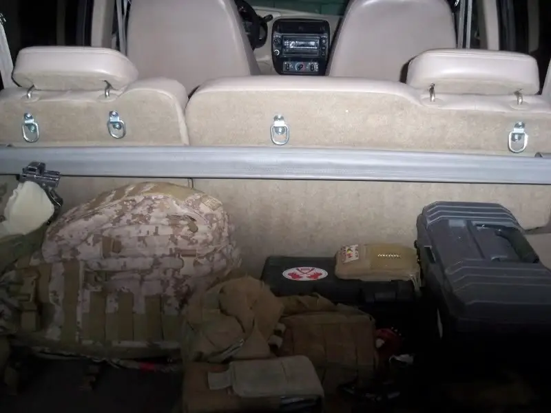

Also went to Home Depot and picked up a set of four 300lb anchor points and some sheet metal screws for around $7. Gonna pick up another set and set them up on the flap that folds down over the space after the seats fold down.

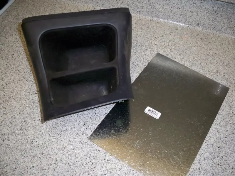

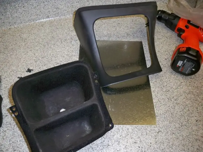

Getting the stuff together for the rear sway bar disconnects. Having a hell of a time pulling the bolts out of the damn thing. And I picked up clivis pins that are a bit to big. I may just widen them a bit, and go from there.
Also got a billet grille in there, and the beginning planning of my center console/switch area cover.

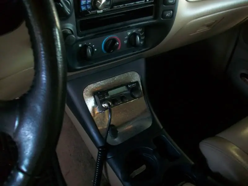

Did a little work on the console. Helps clean it up a bit, looks good with just the one switch and CB.
What I started with.
The console actually comes apart with a couple 8mm screws.
You will then get something like this.
Unfortunately my camera died at this point, and I could no longer get the pictures in. Basically I cut the sheet metal to fit under the frame of the cubby thing, and cut the back side out little cubbies and mounted it all back together.
End result is something like this. As of now I think I'll be leaving it as is.
I also picked up a grill insert from Ebay a while back.

I like the insert inside with the CB, but I think you should paint it.;)
CB look's great mate:thumbsup::thumbsup:
Cool that's the cb I had in my 95, Except I went the cheap route and unbolted the cubby hole and cut the back side out and had the cb snug inside the lower part. Your setup looks nice though, now a section for toggle switches :)
Thanks gents. I may be making another one as I learn quite a bit from the initial insert. So there may be a better idea of how things were done.
If you look a few pages back I had a similar set up.

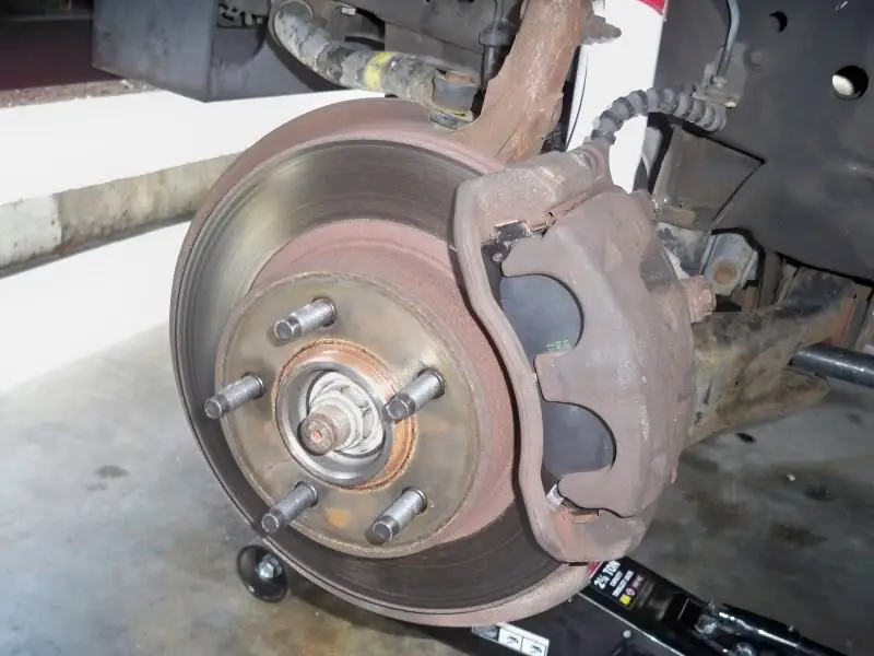

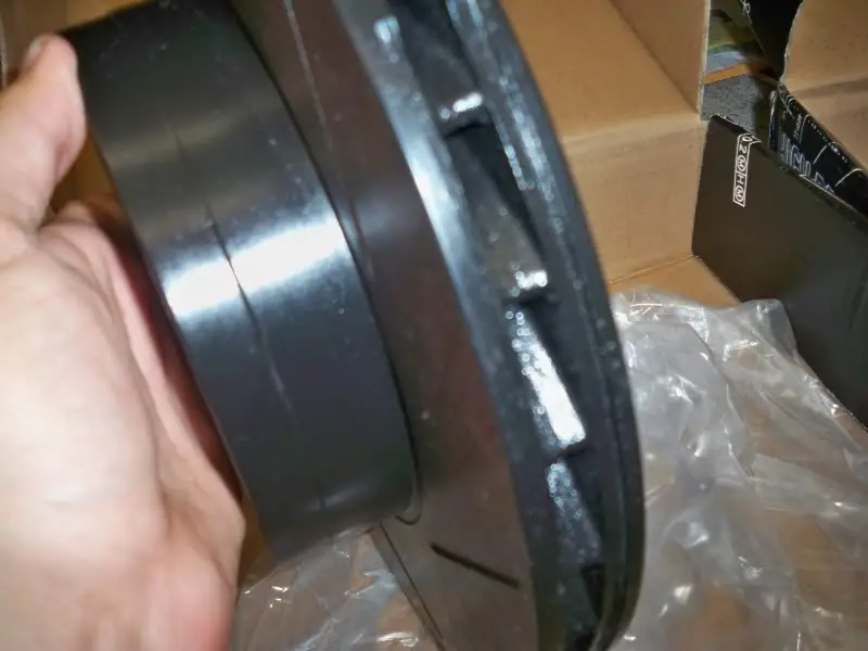

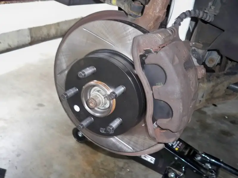

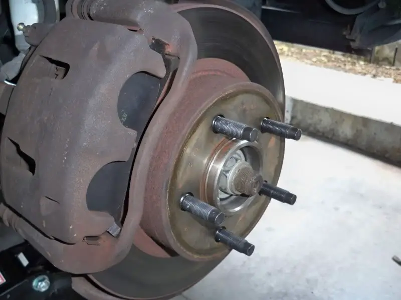

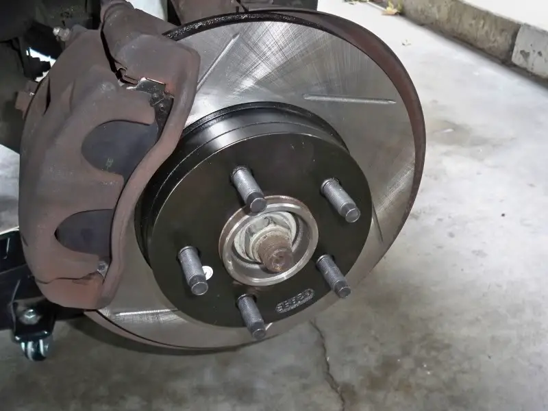

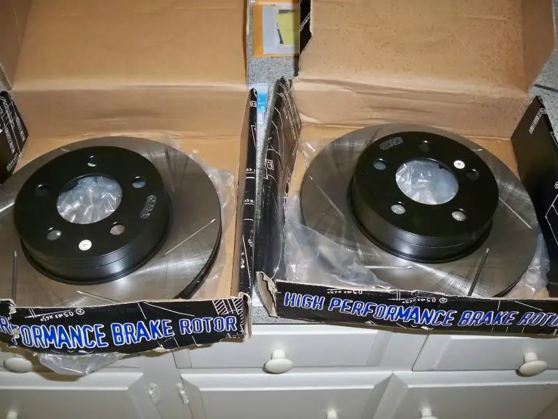

Well I've got the front brakes done. I've got Powerslot rotors and Hawk ceramic pads up front.
I'm not going to cover the Hawk pads as we've all seen those.

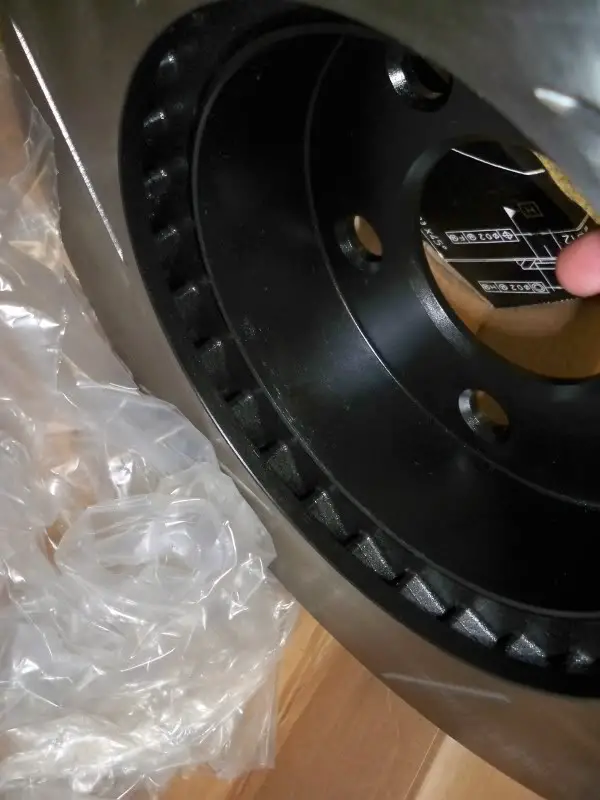

Here's when I got the Powerslots in the mail.
The pads are marked with their respective side.

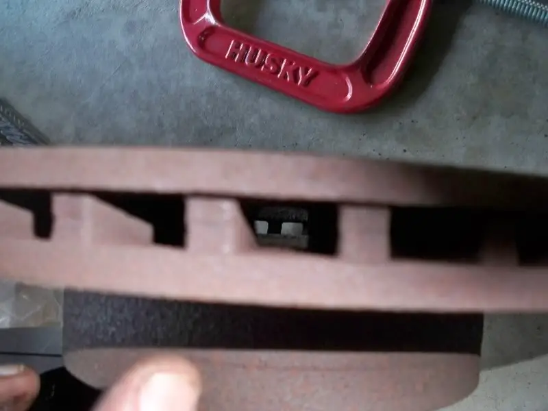

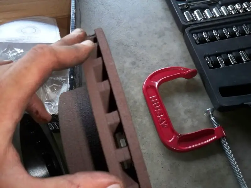

Here you can see the venting on the OEM rotor.
Now compare that to the Powerslots.
Before and after pictures:
Left side:
Right side:
The stopping is dramtically improved with just the front brakes up graded, once I get some extra cash I'll be getting the rotors for the rear, and put on the Hawks.
