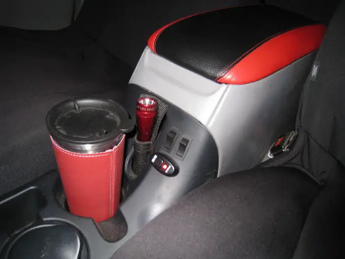

Two black rocker switches are for my 4 roof rack lights. 1 works the outer two, one works the inner pair. The round one with the red LED labeled "PIAA" is, shockingly, for my PIAAs.

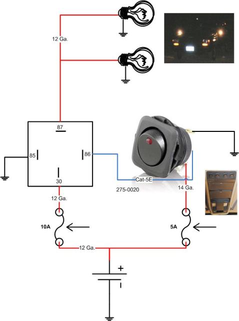

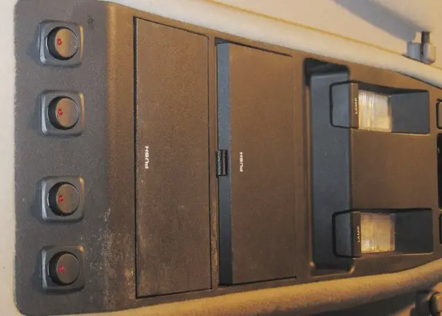

Right now, I have 4 switches installed into an overhead console. I am only using one for my experimental set of Arc Lights but the other three are in place and wired down to the relay location for future use.
I used Cat-5E cable for the control voltage from the switches to the relays. I used a pair of wires per switch but could split it out to run 8 switches/relays if needed. The control voltage is fed by a 5 amp dedicated line up to the overhead. (No need for mega amperage switches when running as control voltage to relays)
Using Cat5 cable for the control voltage to the relays allows you to fit several switches into a tight area without having too much bulk from the wiring needed…
The circuit feeding the Arc lights through the relay is fused at 10 amps for now. Now that I know this set up is working the way I want it, I will look for better lights and fuse them appropriately…
The next time I visit the Bone-Yard, I plan on trying to find a rely/fuse center like the stock one so I can make this extra clean looking…
The swithches from Radio Shack are lighted when on, afordable and compact in size so they could be used just about anywhere...
