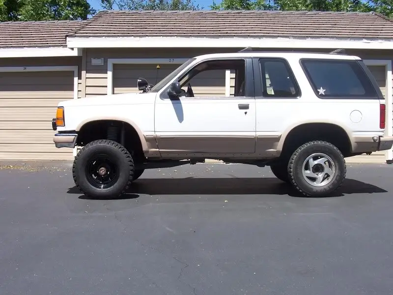

it sits the same now as it did with the d30. and i wanted to run 35s, the tires in the pics are 30's and it just looks funny how wide it is with about 5" of lift lol

well drove around the complex today and forgot to take the wrench off the brake bleeder and it broke off. lol and then i broke a bolt extracter off in the bleeder:rolleyes: so it looks like i need to get a new caliper. o well. hear are some pics :) hope you guys like
ur bumper makes the truck look really pissed off...
Looks good! You'll have room for at least a 35" and probably more if you just trim the front of the front fenders, no need for a body lift.

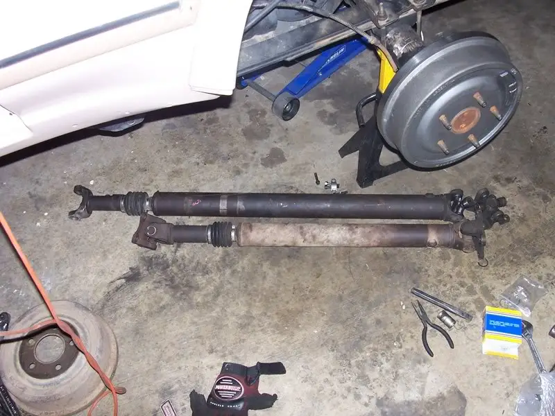

so hears are some pics of where I'm at now. i have the rear axle in and centered.all i need to do to the axle now is set the pinion angle. i am having an issue with the drive shaft. i remember seeing some people had theres lengthened around 4-5" so i went and got a 4 door shaft to see if it would work, but it seems to long. dose anyone have a pic of there new shaft next to the old one? this is what mine looks like.

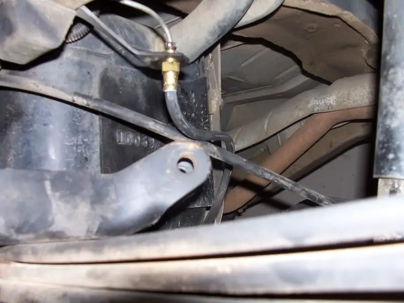

i used a 79 bronco rear break line and it works perfectly

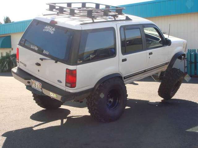

and hear are some pics of trying to see what it could do in 2wd.
