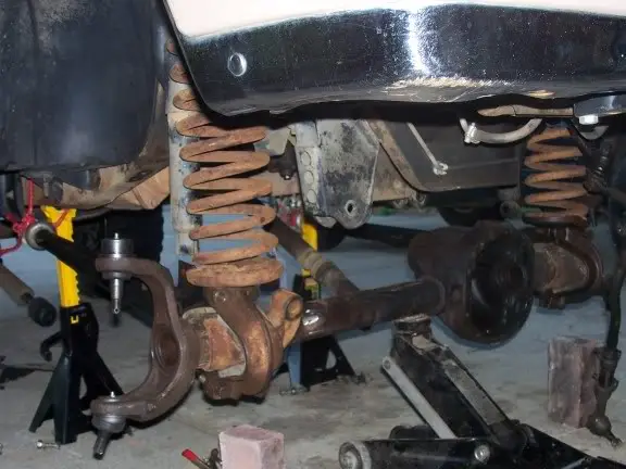

Ok, so since my car was towed home yesterday with no breaks i will be starting my sas. :D i am using a d30 front end with RA's that my buddy gave to me when he put a hp d44 under his 97 yukon :cool:. so since i have ben buying barts for over a year now i have almost all the styuff i need. there will be no guts in the axle for a little bit since i had to start on the swap eraly and need my truck back on the road. so on with the pics . i have goten this far in a day and a half. :D
i went thrugh 2 grinders cleening this thing up. lol good thing they wher only $8 from harbor freght
still need to weld the perches and set the pinion angle. anyone know an esay way to do that?

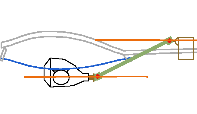

Most people just set their new perch angle to their stock perch angle. However, with an AAL and Warrior shackles, this angle was too much on mine.
Courtesy of IZWack in my thread :D
You want the angles to be pretty damn close in relation to eachother.
sweet. thanks that helps alot. :D and i now have the frunt end out. i will post pics later cuz my camera died. :(

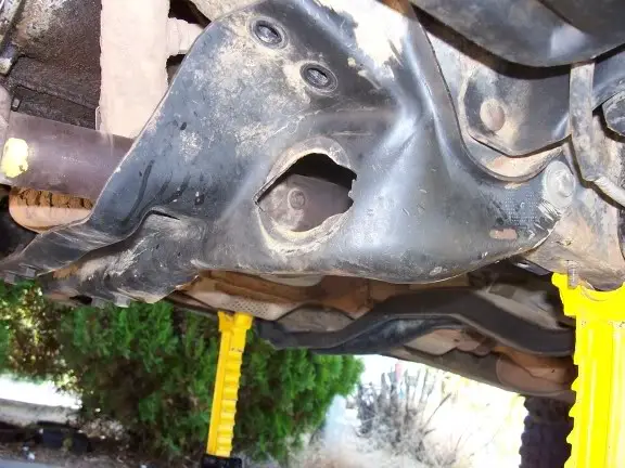

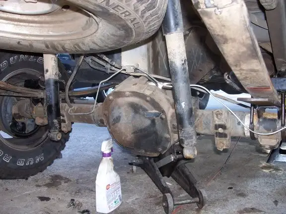

i can see why my breaks went out. the pad was spit right out of the caliper. good thing i was in a parking lot when it hapind.
and i also know why it woldent keep an alinment.
anod now its all out. :D

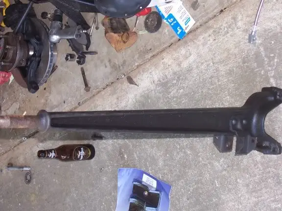

Were are the bearing caps? Please tell me they are marked and you know exactly which side and which way they go back on... if not this housing is trash.

That makes the housing trash? I took mine out and replaced them. they seem just fine--i mean the axle is so scraped it looks like trash now but i dont think its trashed........yet
why do they have to go back the same way? i took them off about a year ago, when i got the axle. o well i gues i will just have to go to the junk yard and get a new one when i have money for gears.
I've heard this too... and instantly drew a map of my axle in a piece of cardboard and stuck the caps in it. But what is the theory behind it?
Is it the same theory behind keeping the pushrods in the same place you removed them from? What is the deal King James?
The bearing caps are line bored with the journals. Get them mixed up, and it will eat carrier bearings like nobody's business. You can have a machine shop re-bore a new set, but it will cost more than a new front end.

Find the old caps or get another axle......

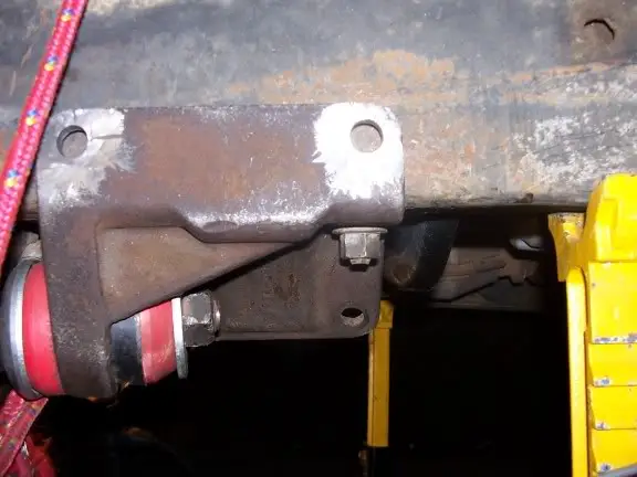

:D well i kinda got it siting under it oun weaght today. kinda. nothing was welded in just wanted to see where the springs wold sit. i think it looks ok for now, just the stock springs that came with the RA's.
And i got the RA mounts wher i want them. Any body know if the trany cros member will be ok like ths of will i need to make a guset for strangth?
