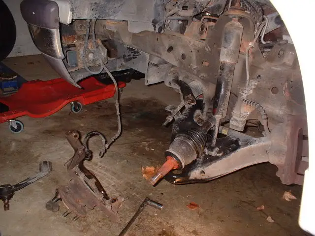

I'm working on mine now... replacing the upper control arms, lower ball joints, outter tie rod ends, cv shafts, and sway bar links. The floor jack trick worked awesome! One thing I done differently though was leave the ABS connector in the knuckle and just unclip the wire from the frame and sat the knuckle on the floor.

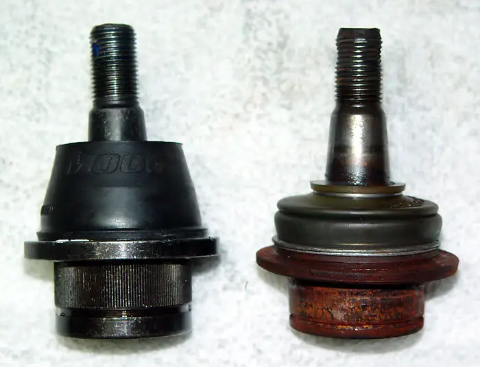

The LBJ will be the life of me. My question is this I was finally able to remove the ball joints after a week. The stock LBJ has a bigger lip than the new moog, am I missing something? Thanks in advance....
The new ball joints have a collar/lip which keeps it from going up any further. I think the issue of some joints not working in a stock arm has to do with the diameter of the joint. If the joint slid up into the arm with no effort that would not work. Nor would it be usable if the joint was too tight. Mine(Moog) appeared to be about the same, with the grooves/splines of the joint large enough to make a tight interference fit.
That's an interesting boot, is it rubber or what? That isn't the exact Moog joints I installed, mine had black rubber boots. The step on mine looked more like the stock ball joint, but that one you have may be fine. The section which goes through the arm is the critical part. That has to give some resistance to hold it in the arm, not too tight and not too loose.
Basically the short part before those serrations should be the same diameter as the hole. It should slip easily in until it reaches the serrations. Good luck,

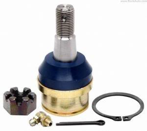

Ok am I missing something here or did I get the wrong part? :roll:
you got the Spicer Brand Ball Joint:

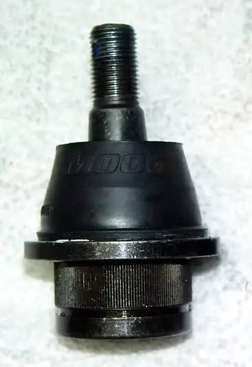

i installed a moog ball joint when i did mine..

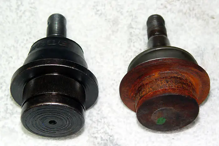

the lip/collar on the moog balljoint was pretty close to the size of the stock ones.. here's a comparison shot:
i think the difference between the two is that you can take the rubber boot off the spicer and not on the moog.. but the floor jack installation is a really easy and effective way to do it..
Moog has come a long way with their boots. I can remember when all of their boots did not seal well, they all leaked a small amount. These both fit very well, they will not leak a bit,they hold grease well.
