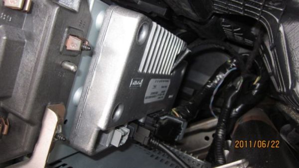

Sorry. Accessory Protocol Interface Module. It is the 'brains' of MFT (MyFord Touch). Do you have the 8" screen?
Yes I do. Is that I thing the cd would go in?
The APIM is a sealed unit attached to the back of the MFT screen.
