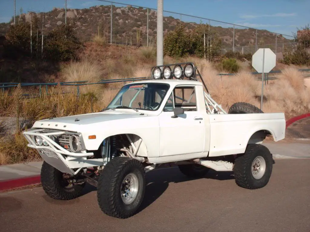

RJ, he's got another Courier race truck too, built in the nineties that used to race in the trophy truck class in SCORE. I'll post a picture later.

This is an old picture of the Courier race truck I mentioned. It doesn't look so clean now since my buddy rolled it on its side. He plans to race it someday.

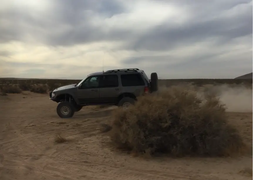

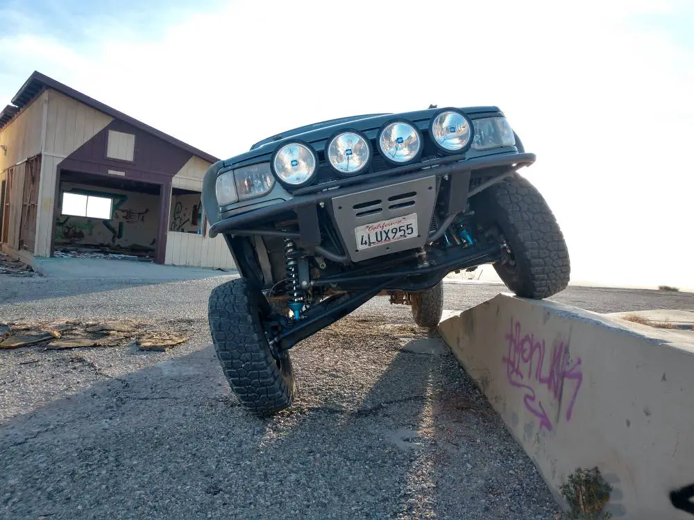

Maiden voyage to the desert was pretty much flawless. My battery tray rubs the steering fluid reservoir so I had to bend the reservoir bracket to get some clearance, and the hose for my windshield washer fluid disconnected. That's it. I drove it pretty hard all weekend, had to use 4hi for a minute to get out of a tight spot, and the front end felt amazing on the high speed stuff.
I'll try to post a couple short videos and pics when I get them from friends.
