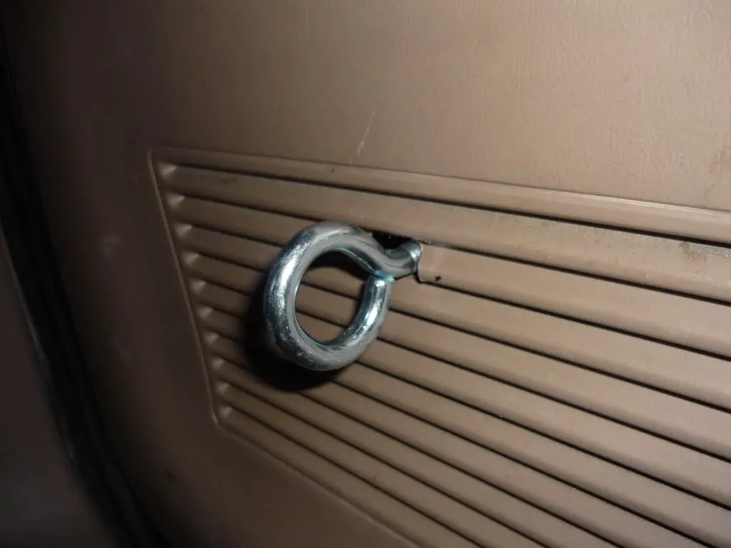

On another note, i added another little modification that i've been wanting to do for a while. I made a handle for inside the rear hatch so i can open it from inside when i'm sleeping in the back. It works great, was pretty easy and straight-forward to make, and only cost $8 and change.
Here's a picture, i'm gonna make a thread explaining it because i don't know of anyone that's done an interior hatch handle, but i know anyone who sleeps in their trucks would find it useful.

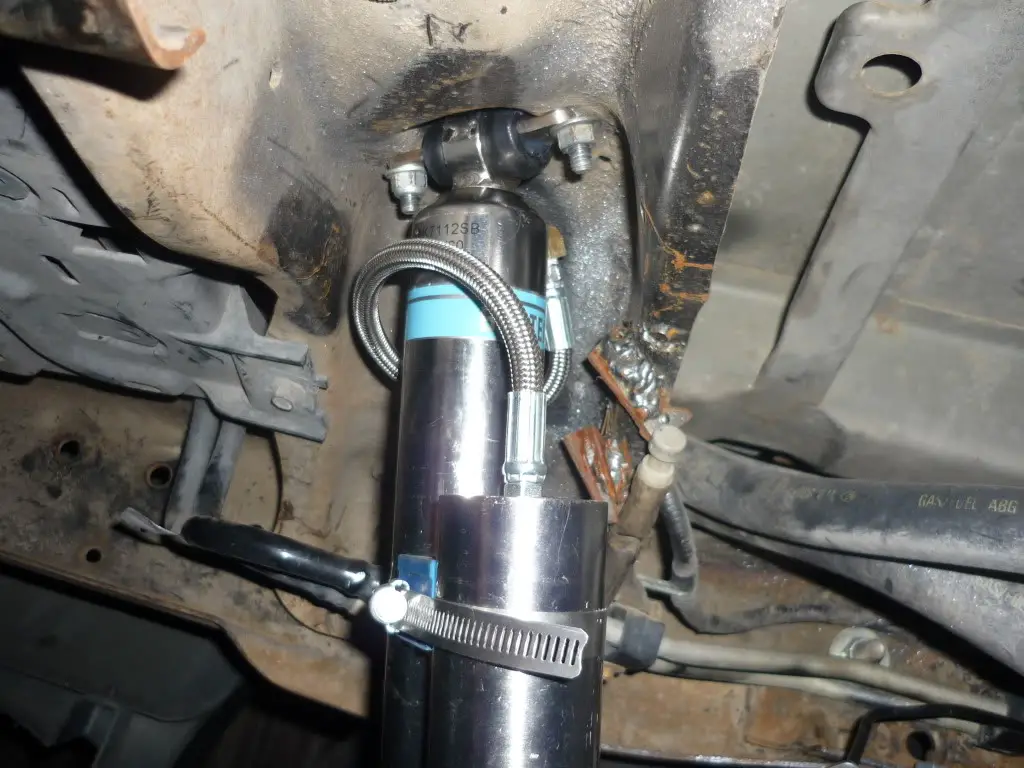

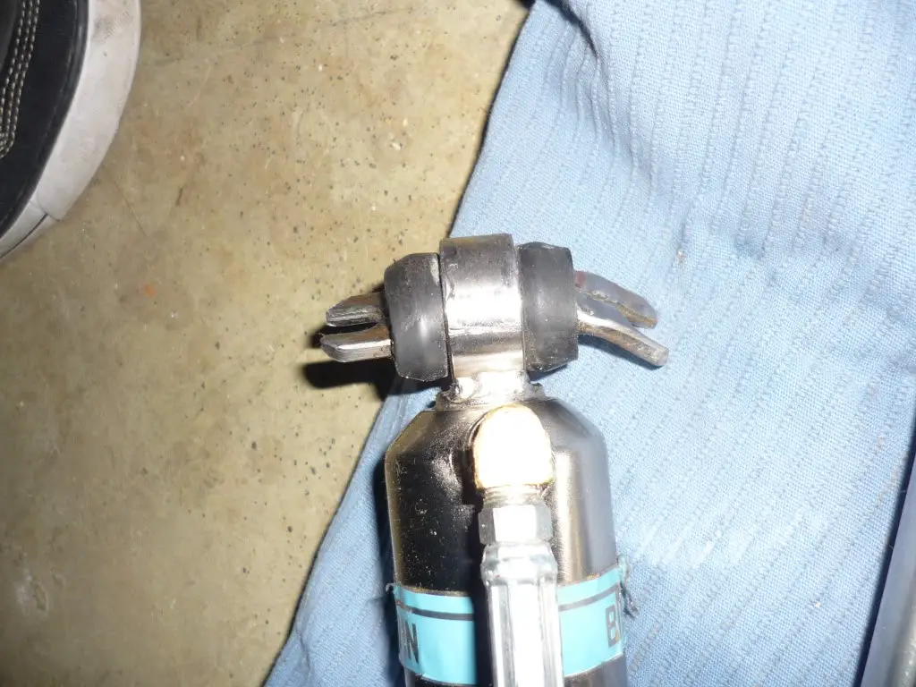

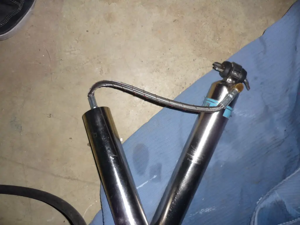

Just wanted to update with pics and my theory of what happened with my rear end...
Here's the upper shock mount that was damaged...
The bar-pin that goes through the shock bushing was too short to be completely secured by the two bolts that attach it to the crossmember. I negligently didn't really think too much about it and soon forgot about it after installing the shocks. I'm thinking that the bar-pin simply came loose from the bolts when going through the whoops, and when it was hanging loose the bar-pin was smashed into the bottom of the crossmember and bent at that point, as well as crushing the resi hose and bottoming out the shock. There are gouges and scrape marks all over the crossmember which presumably is from the bar-pin. There's no way that the shock could have bottomed out while still in it's mounts unless the frame above the axle severely bent, or the axle moved to the side, in which case the other rear shock would have bottomed out too. That's my theory.
Here's how it was mounted before, you can see the ends of the bar-pin are barely held on by the hardware. Carelessness on my part.
And here's the sad looking shock
I got a new hose a few days ago from bilstein, and i'm going to get some longer bar-pins so the shocks can't come loose again, and also larger diameter washers. Maybe i'll tack the bar pins to the crossmember just for extra security.

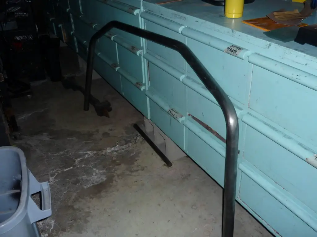

Progress on my front bumper!
Main tube bent today, still need to trim down the ends.

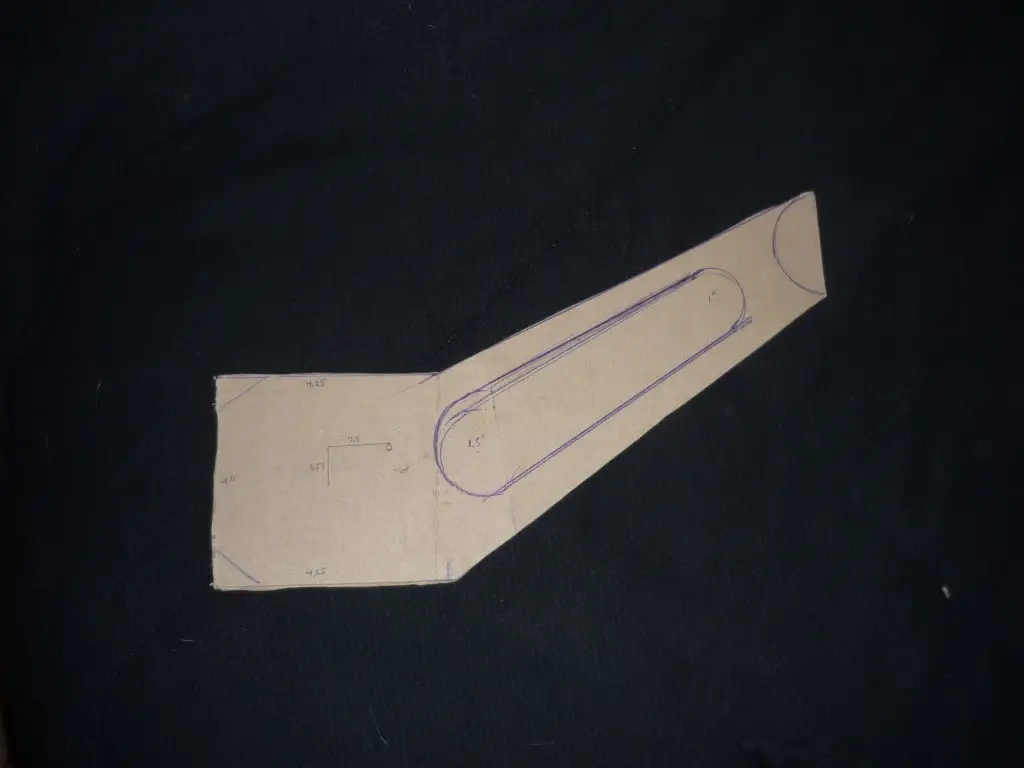

I'm getting these laser cut to do boxed frame horns, should have the pieces back tomorrow.
It's going to be bolt on, so the frame horns will slide over the frame, and it will also attach to the lower A-arm bolts.

Drawing of what you're going for with the bumper?

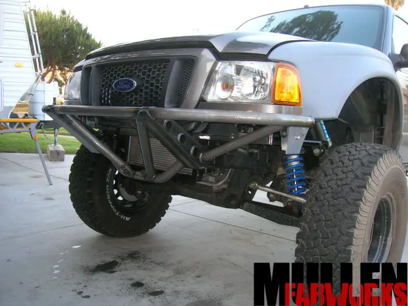

Here's a photoshop I did of the exact bumper i'm using for reference.
Unfortunately, the thread about that bumper build was on another forum and it was deleted. But to give you an idea, it will be boxed like this:
1640d1263167055-img_0349-jpg
This is the original bumper i used for the photoshop, i just can't find any close up pictures.
Thanks Ted, i missed that link you posted at first. I have a few other places i'm going to call.
Also, the laser cut pieces will be slightly different than that cardboard template. When I drew it in solidworks I tweaked some things slightly, but I used that cardboard to figure out where the main tube would be.

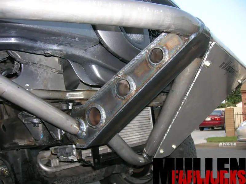

And i found pictures of that bumper, mine will have the top and bottom plates hang over the side plates like this one:
