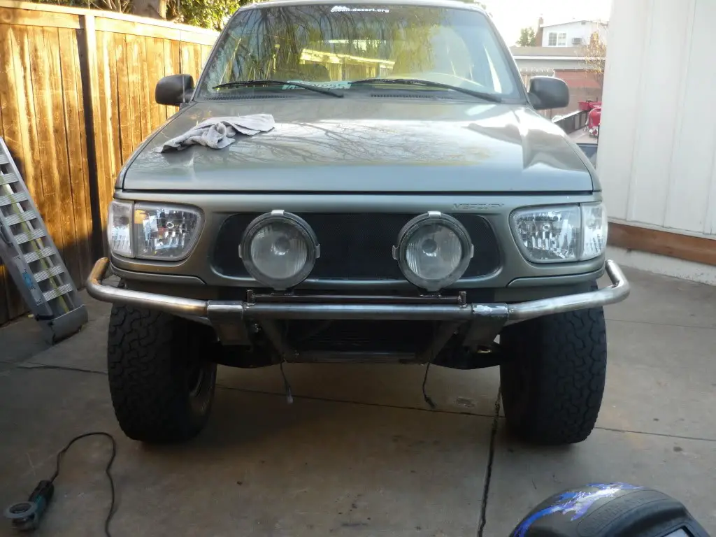

Came out awesome:thumbsup: Before you paint it up you should weld on some tabs for the skid plate and lights if you plan to put them back on
Ya i'll probably just coat it in WD40 until everything's done and i'm ready to paint. And thanks for the compliments everyone.

but a Suggestion for the front license plate mounting: Conduit Tube Clamps, they come in a few sizes readily available at Home Depot and are cheap too.
this was passed along to me by DB1
credit where credit is Due:D

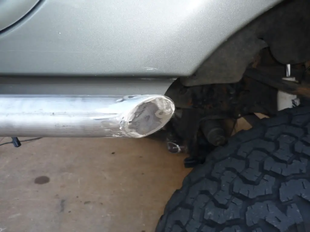

I got the ends of the main tube capped today and ground smooth.

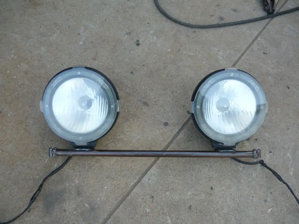

Also got the lightbar made today and the tabs on for the lights.

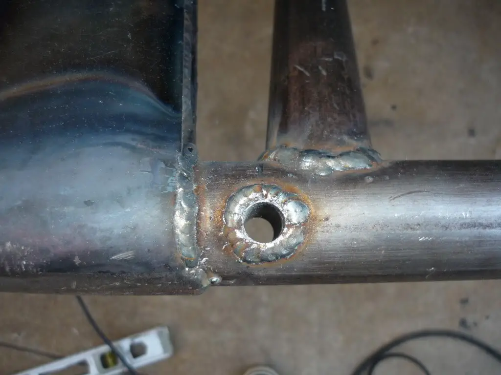

I was going to put the slugs through the frame today, but somehow one of the lower A-arm nuts cross-threaded the bolt and i can't get it off, even with heat and a breaker bar. So i have to cut it off and get a new bolt in the next couple of days. Besides that and the skidplate tabs, it's pretty much done.

Love the way you did the light bar:thumbsup: Instead of doing just tabs you made a separate bar, and it looks great! Well done:salute:
Thanks. I don't want my lights to be stolen so around town I won't have the lightbar on, just for desert trips.
