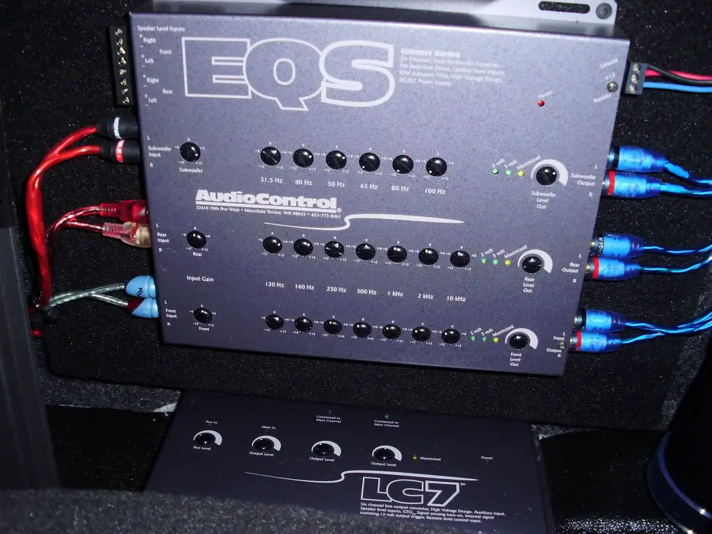

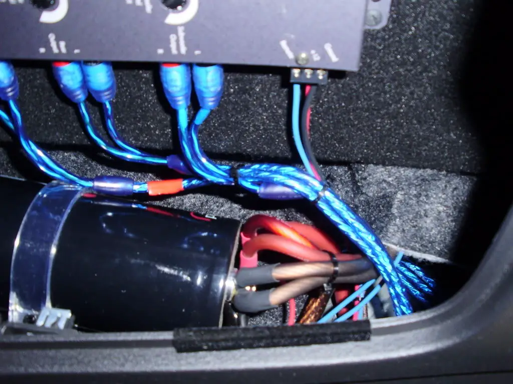

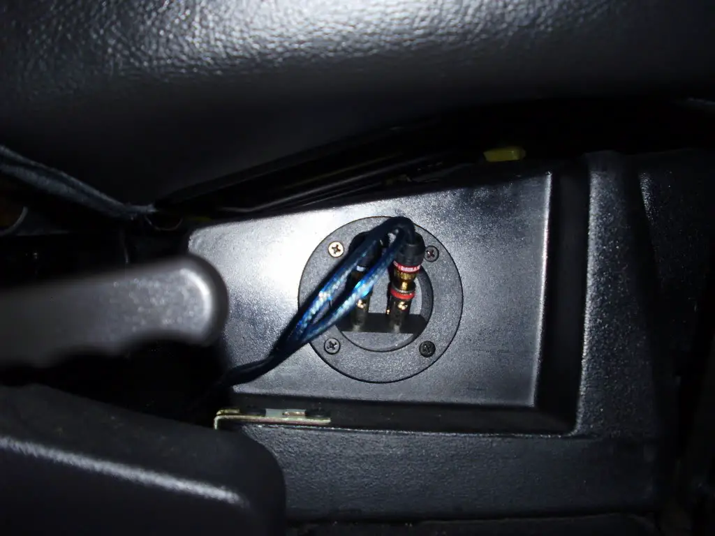

Pics of stereo
Here are some picturs of my stereo install.

chowman90 Thanks a bunch for those pics of your system. They definitely help me figure out where I can mount my amps and EQ.

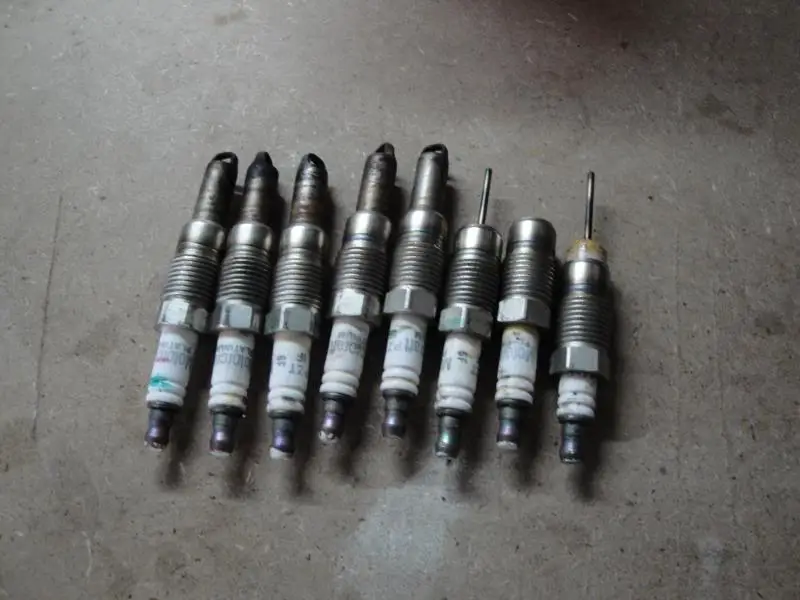

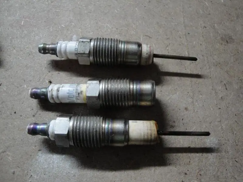

4) Replaced the stock plugs with Autolite HTs. FYI... 3 of my plugs seized during the removal process. The local garage had to spring for the removal tool to get them out.
Here's a couple pics of my old plugs...
Here's what's left of the 3 plugs that seized up...
5) Replaced the front sway bar links ...twice! The strain of the Truxxx lift caused the first two sets to snap completely apart. I purchased a Moog kit and replaced the kit bolts with some longer pieces of thread-all. Problem solved! Next suspension item will be to upgrade the upper control arms followed by a Rancho Quicklift kit.

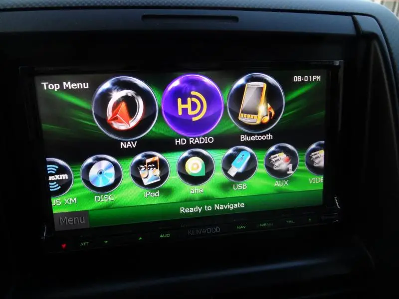

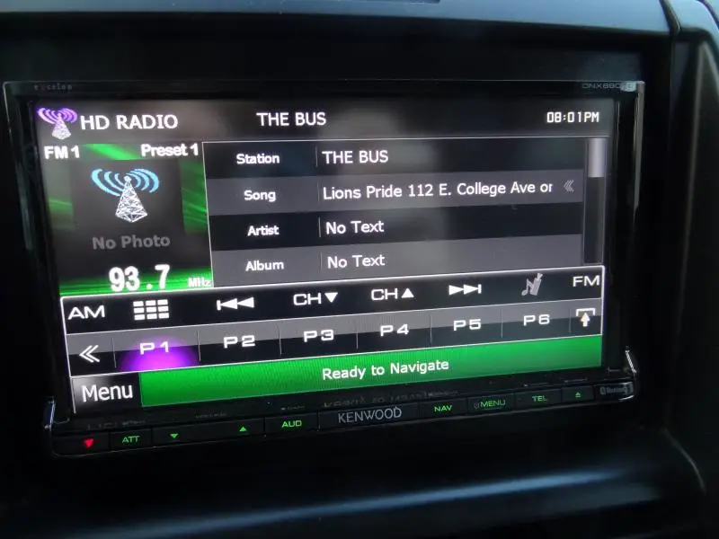

Well, I wanted to add some pics of my recently installed sound system to this thread, so here we go...
My new (refurbished) head unit. Kenwood DNX890HD. The full rundown of specs can be found here

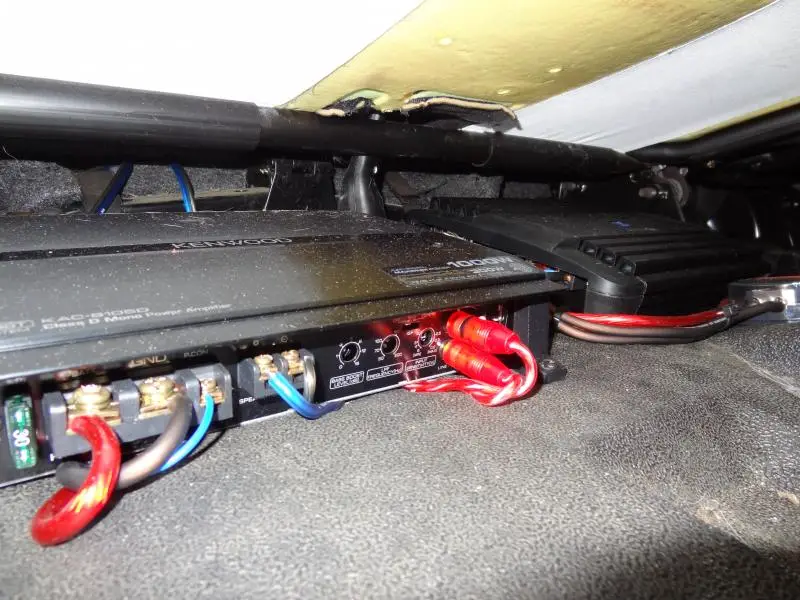

Amps (1kW Kenwood mono sub amp & 300W Alpine 4ch amp) mounted under rear seat.

Great update...I've been contemplating on upgrading my Pioneer Navi to a Kenwood setup. The interface seems a like more to my liking than the Pioneer. You'll have to post a review of the unit for us.
