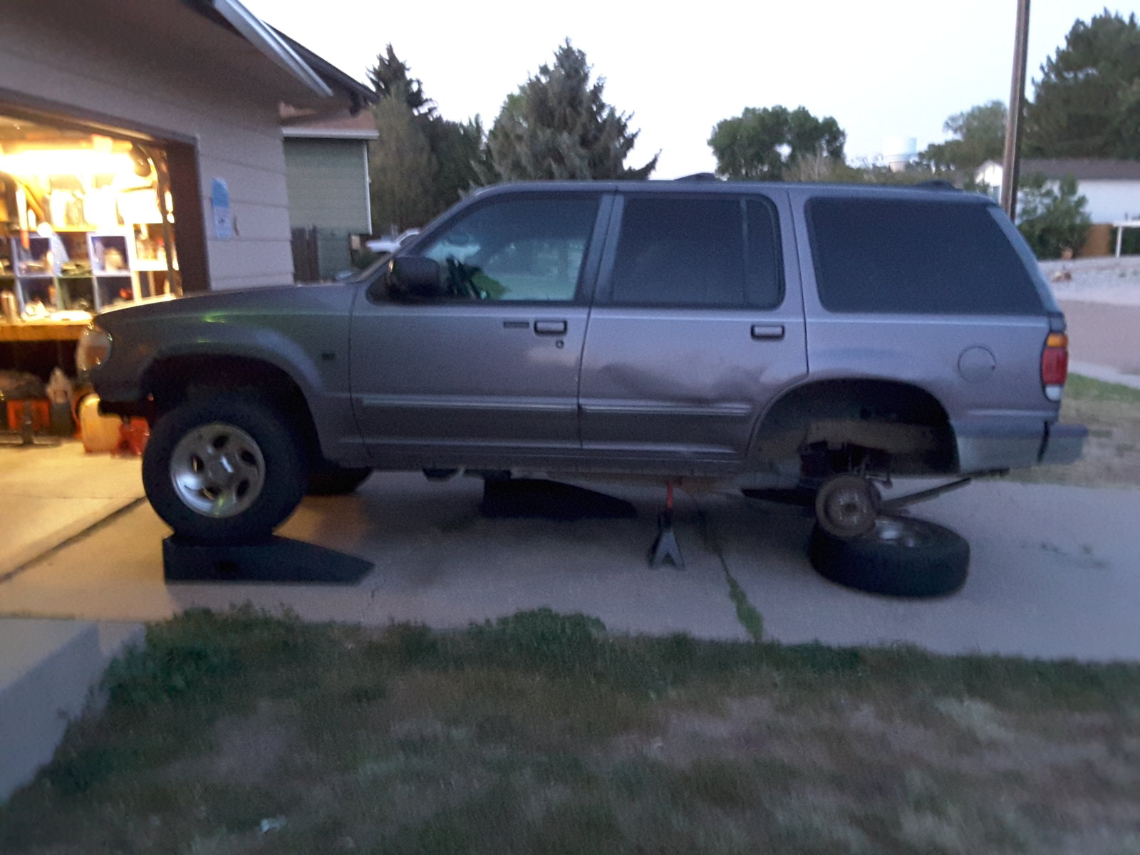

Well I did a little on my EX last night. I out the Drivers side up on Ramps. Yeah I know a lot of work LOL. With a Dog barking in the neighborhood some where and was also told that Dinner was ready had to get inside and get away from the noise. Was planning to get Running boards off and See about dropping my Gas tank to see what I can do about getting her running. Will see about getting more done tonight. Will see when I get home. Is there anyone around my area that has some head light assemblies for Passenger side. for a 2nd gen? :-) I live in Colorado Springs.
Well I did some work on my ex today. Got the gas tank skid plate off and took off drivers side running board. I also pushed the sent out a little on rear door. Also took off front bumper.
