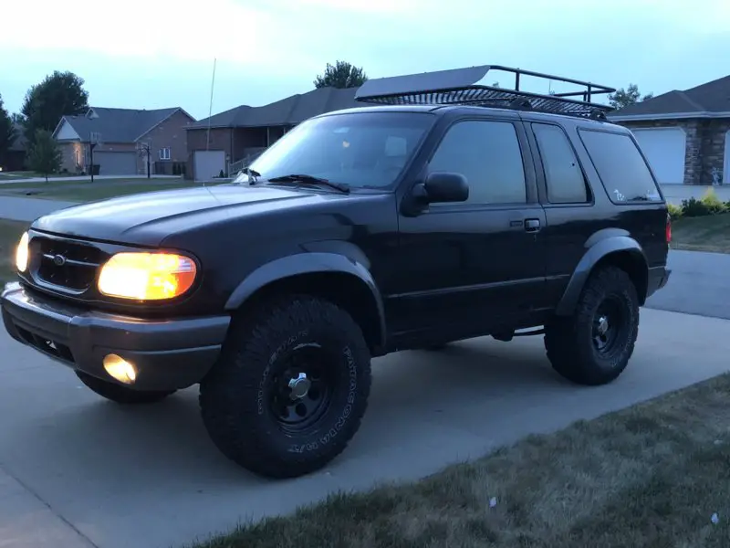

Looks great! There are a few of us Sport guys left out here!!

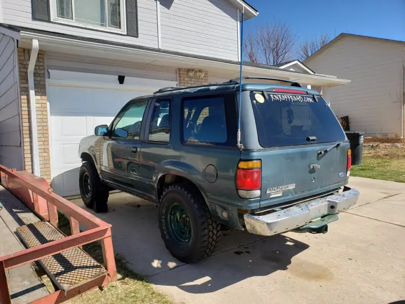

Thank you sir. Yours looks really good also. So with just a TT and Shackle you have 33's under her? Does she rub at all?
Yes, I'm in the process of extending the bump stops with ones a bit longer. It barely rubs at full compression in the front and the back so the bump stop extensions will clear it right up. It also rubs the sway bar at full lock due to the 4.5 BS rims, but I like the way they keep the tires under the truck. I plan on doing a steering stop when I up the bump stops. This was kind of an accidental build and now I can't get rid of it. I've had Jeeps and other 4x4s but this little "bronco" just gets me. This truck is going to do Black Bear and Imogene this summer much to my wife's dismay. She would rather take our 2018 High Country but that takes all the adventure of "will we make it?", "will we break down?", out of it.

Your truck looks great! I just took my roof rack off to fab up some lower, stronger, crossmembers for the RTT. Also just ordered a fridge for the back. My new interest is removing the back seats for a platform set up.
I also just installed new Rancho 9000s...They are incredible.

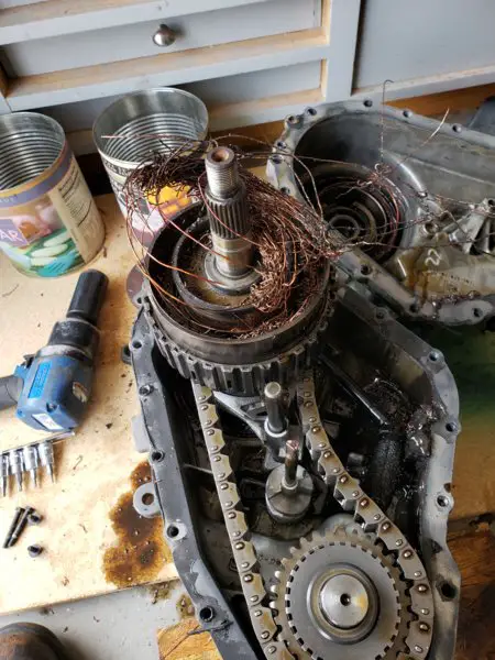

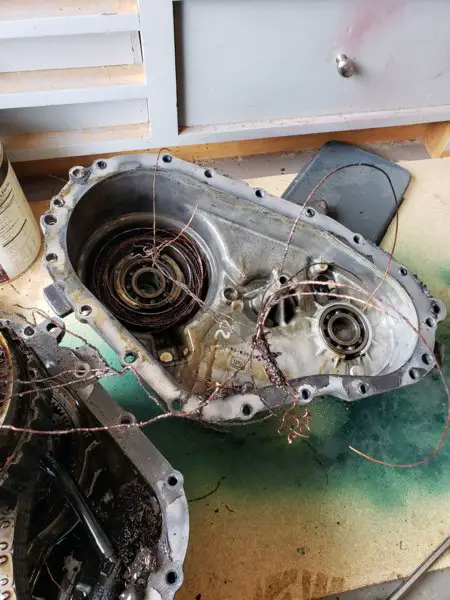

I hope that one lasts for a while, and now you know what's in them, you might build the spare sometime.
