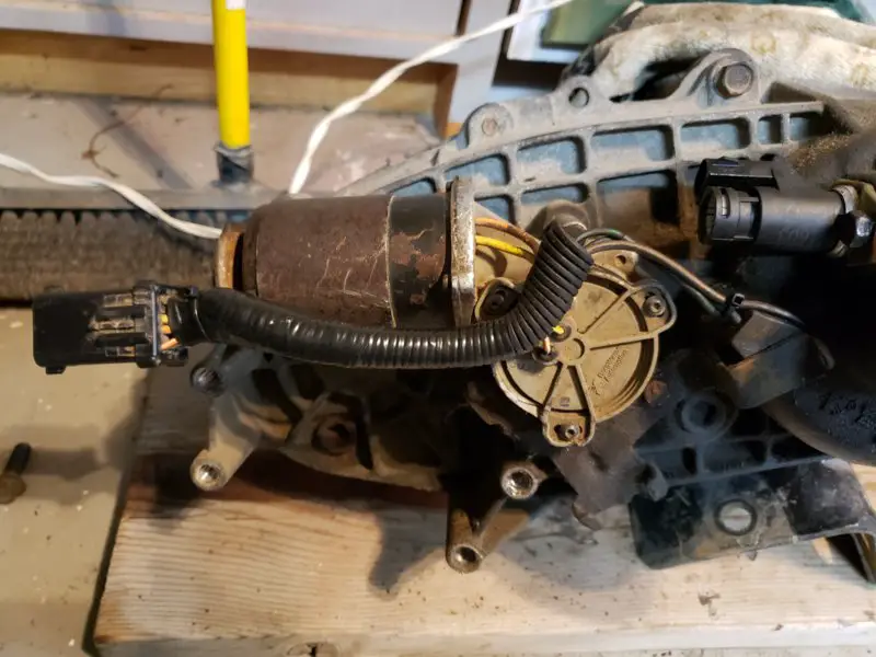

I installed a bw1354e into my 97 explorer sport. Used the shift motor from old TC hooked a green wire and a blue wire from 54 TC to the wire harness of newer shift motor. Hooked everything up and it works. It shifts into 4 hi and 4 lo. Not sure if I can shift to 4 hi on the fly. But that does not bother me at all. I am just happy that it shifts and it shows what it is in on my dash. Super excited. NOW to get a front drive line from a first gen Ex. PS brown wire is not hooked up.

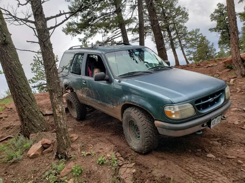

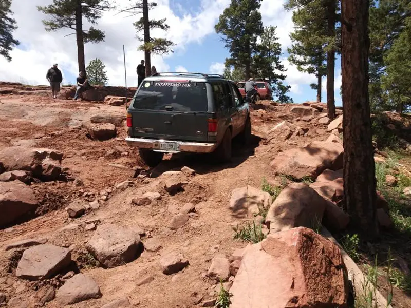

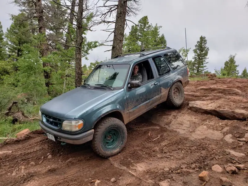

Well I was able to get her out to the Trails and WOW did she do wonderful. With out a locker or LS in the rear she sure did not get stopped to easily. Here are a couple pics of here out in her Natural environment.
Her Tires did spin a little in certain area's but other then that she did WONDERFUL. Love how the Front axle worked out and the 1354 was also flawless. Working on video tonight and try to get her posted up. This time there will be sound. :) Next on the list is Winch and Rear lunch Box locker. Also need to raise the rear a little. So gonna get either lift shackles or Add a Leaf.

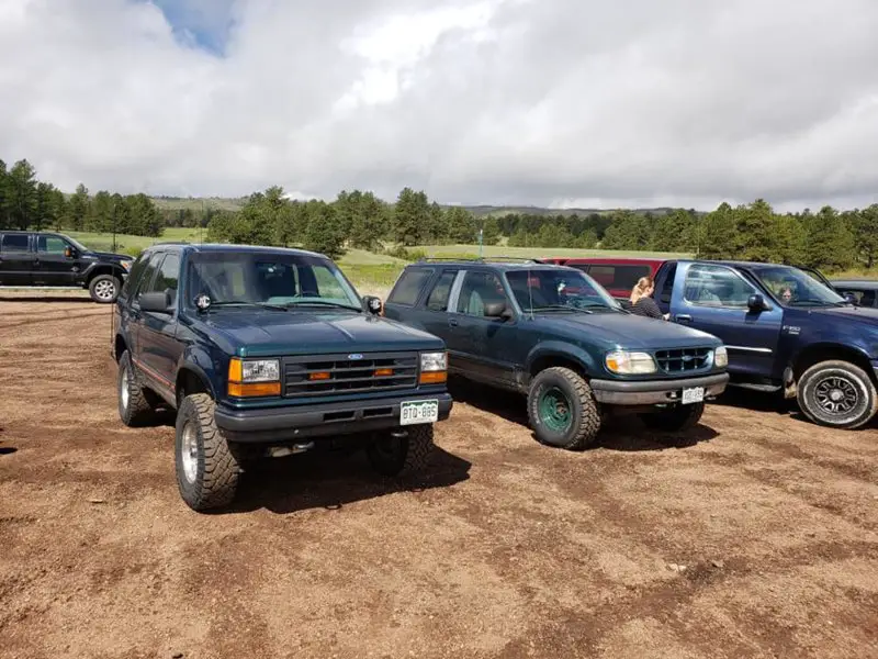

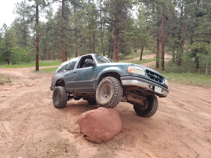

The wheeling day was a good day. I think this Picture was one of my Favorites. There were 6 explorers in Jeep Country and one F150.

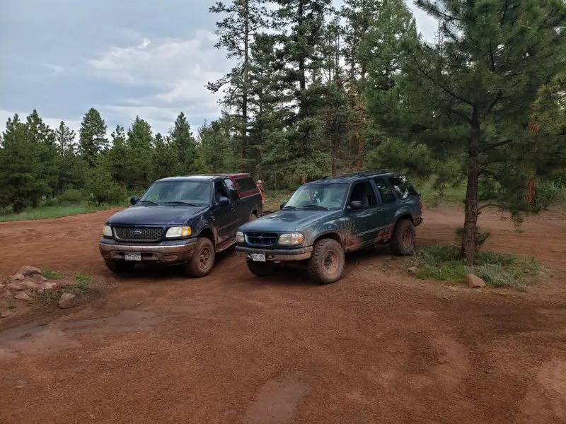

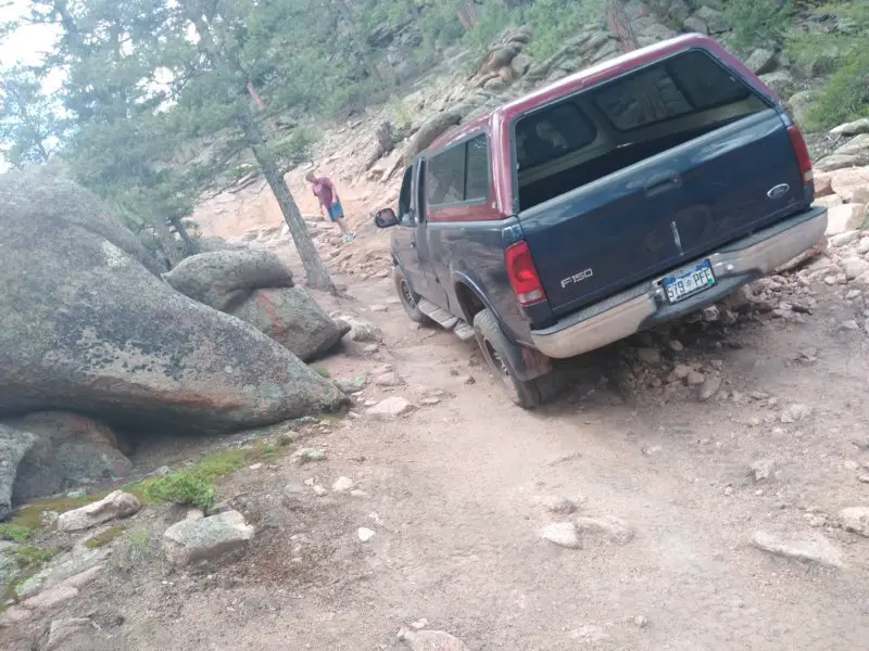

Well Saturday my wife and I went out onto a trail and had a great time. My in my EX and her in her F150. It was a much more difficult trail compared to Rainbow falls. WE went up to China wall. It was her Birthday and that is what she wanted to do. So who am I to argue about what she wants to do. At the end of the trailer down by the river we were eating lunch and it decided to start raining. So the sitting by the river for a bit got cut short. But that is ok. I have right now a couple pics and will get more as soon as I can.

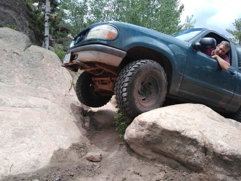

Looking at my Front end on this I need to do something about Swap bar LOL
Yes those side steps got ruined. But like she said its a truck. :) Love my wife.
Get rid of that sway bar!!
I have heard bad things about doing that also. I want to so bad. Just not sure about the CV joints just because of what you see there. They would be stretched out over this obstacle. I will have to do it then and get limit straps.
Swigin, you didn't get the part where I said budget. Lol
