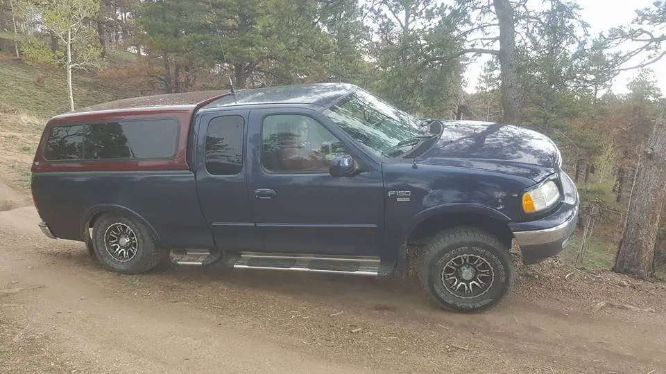

Well a little off topic but went up a forest road today with my tow rig. Was nice to get out to the mountains for a day of rest with my family. Was very impressed with my truck.

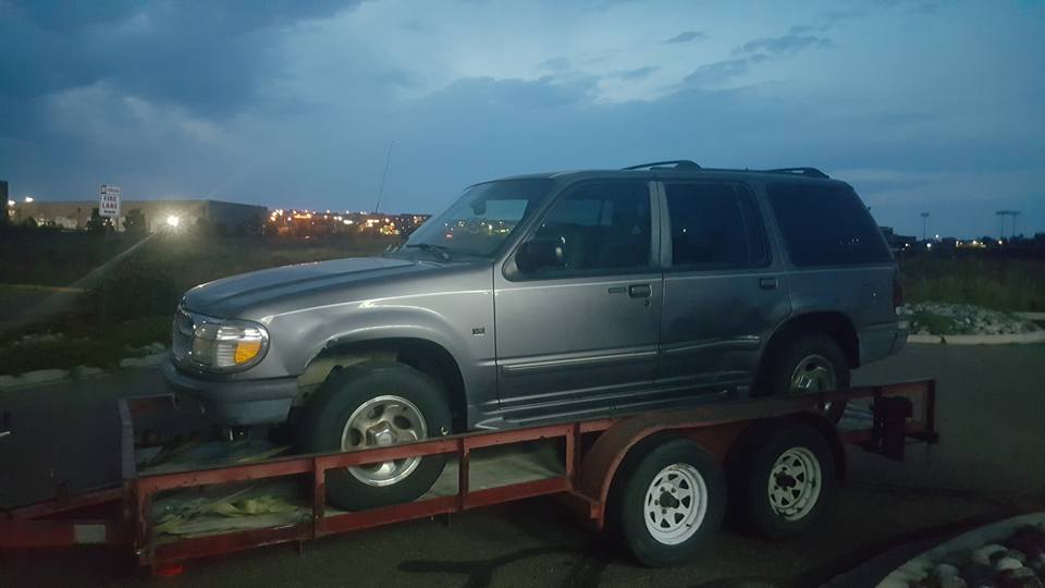

Well I could not pass up Buying a 97 5.0 4 door explorer. I was able to get her for $250. So Build is now gonna be on my 97. 96 is gone. My Daughter has the 97 Sport and I am gonna build the 5.0 97. Looking forward to the build that is gonna happen with this one. Just got to get her running first. Was told by previous owner that her Mechanic said it is the fuel pump. When I get a chance gonna look at all the fuses and relays and the Trip switch. Then I will see if Fuel pump needs replaced. Hoping it is one of the others and not the pump. We will Hopefully see this weekend. I will let you all know.
So here are a couple pics of her.

Check the relay sometime my fuel pump doesn't prime and it won't start until I wiggle the relay (it comes and goes)
Yeah that is what I am planning to do Saturday or this evening when I get home. I am hoping it will be something simple that a mechanic over looked. But we will see and I will let you all know.

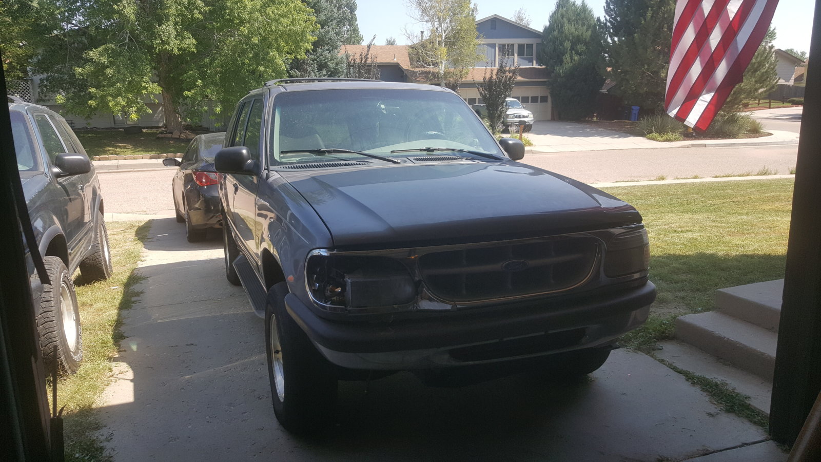

I Checked the large connector plug and it looked just fine. The one over the intake was not able to get it disconnected. I will try another time. I Checked fuse and relays all were fine. Stuck them in my daughters 97 sport and hers fired right up. If I remember I think the check engine light did come on. Will look tomorrow.
Well I looked at all the fuses and relays NOTHING. So I will be getting a fuel pump as soon as Money is available. Thinking about going to Pull and Pay and get one there. Will be working this weekend so Not gonna happen this weekend. Hopefully next weekend. Here are a couple pics of her in my Drive way. Yes that is my daughters 97 Sport next to her. She is stock with 30" tires on her from my 92 I had a while back.

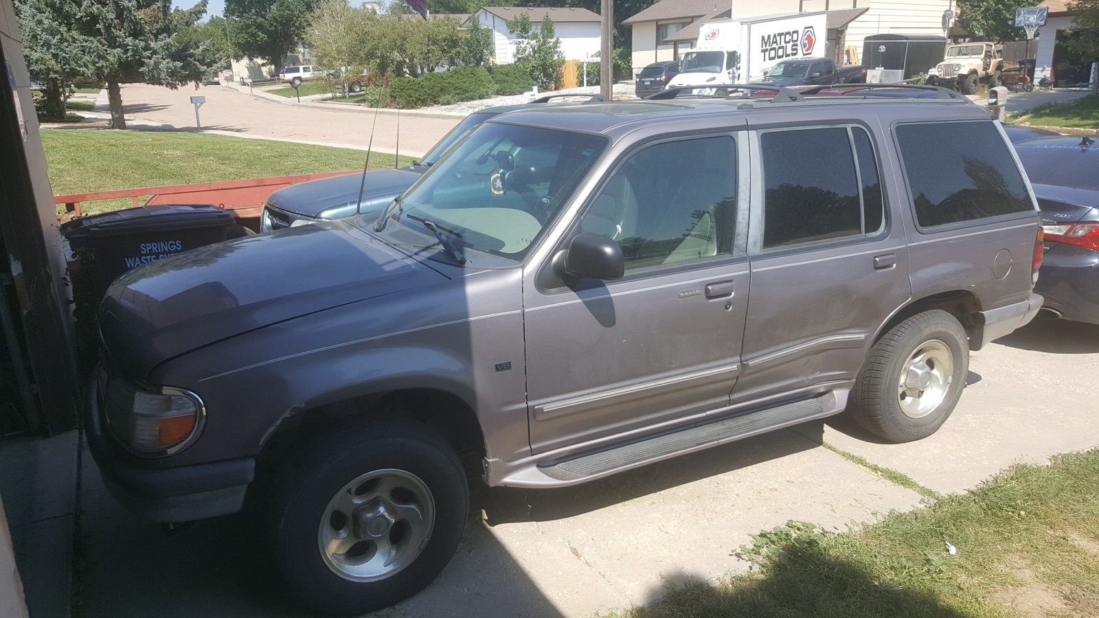

Here is my 96 Explorer. Right now she is stock minus the after market radio :) My plans are to get 35" tires under her. With a SAS and SOA. As for now will get a TT done and an add a leaf or Shackle and get at a minimum 33's to do some minor trails. I had a 92 and she was great. This one here I have had for about a year but have not had her on a trail yet. Hopefully in a couple months I will get her out there and see how she is. Need to get her registered then out to the trails I go. I already have a Dana 30 for the front just need to get fundage and more parts then the undertaking will commence.
View attachment 96769[/QUOTE. It looks nice
