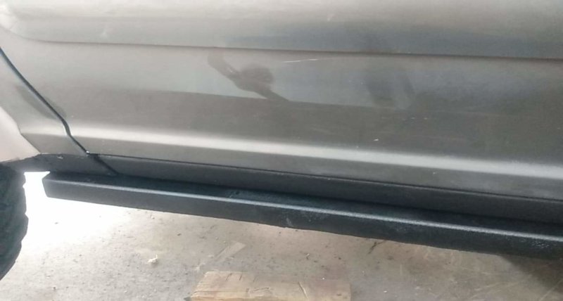

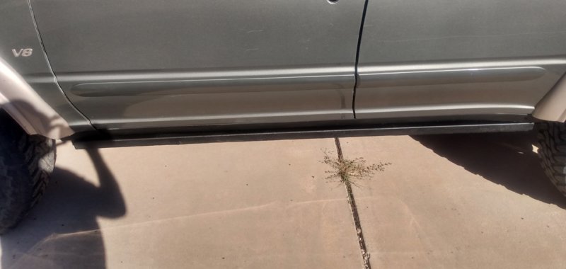

Spent 2 weekends working on a controversial project. I can't really call them sliders, but they are stronger than the pinch welds they protect, and they look better.
There is a 2x3 6ft piece of angle iron firmly attached to the pinch weld (and further up the body). Then a 1.5 x 2.5 6ft piece of steel tubing is placed between the rocker panels and the angle iron and welded to the angle iron.
That looks awesome. Do you have pics of underneath it? Thinking of doing something like this for mine.

I jumped up and down on the angle iron after I put it in and before I put the steel tubing in. They didn't budge. Still... In hindsight, I might go 3x3 angle iron if I were to do it again and if it'd fit.
Better pics all around
The angle iron is bolted to the pinch weld with 5/16 stainless bolts. Large washers on the pinch weld side to prevent pulling through. Before I drilled and welded I attempted welding them, but I dont have faith in my welds or the fact that I realized I was "welding" to sheet metal. So the holes were drilled through the pinch weld and the angle iron and the bolts went in.
I first placed the rectangular tubing on the angle iron then test fit it up against the rocker panels, holding it up there with a jack. Looked for anyplace that might not fit. (Brackets, bolts, etc) any "conflicts" I saw got a clearing cut in the tubing. Then the tubing was placed up against the rocker panel again. The angle iron was placed against it and everything was held up with a jack. I used a couple c clamps to keep the parts together as I "attached" the angle iron (the aforementioned welding). Following that the tubing was removed leaving the angle iron right where it needed to be. That's when i decided to drill and install the bolts. I welded end caps on the tubing, also filled any place that got notched. Then painted the tubing and the angle iron (except where they would be welded together) placed the tubing as tightly into the angle iron as I could then welded the edge of the angle iron to the edge of the tubing. Then painted everything again.
Thank you sir. That helped a lot. I like how it looks
I made the bolts extra long because I thought I might bolt bars to the angle iron and run them to the spots that once held the running boards in place.
I really need to get some paint up in there. Might have to use a brush, don't know if I can get a spray can up there. LoL
Also, to make it easier to reach everything I drove whichever side I was working on up on ramps. In hindsight, I would drive all four wheels up on Ramps at the same time as I tended to work on both at the same time. Saved time while waiting for paint to dry, metal to cool, etc.
Decided to go out and test the rails (sliders).
There was a group from Mesa4Wheelers doing turkey creek so I joined them. The results are shown. Some damage but nothing even near the rails.
Not complaining. It was fun and nothing I can't fix or make better. Since the bumper is damaged I can cut it with a clear conscience now. And I've been wanting a different set of tail lights.
