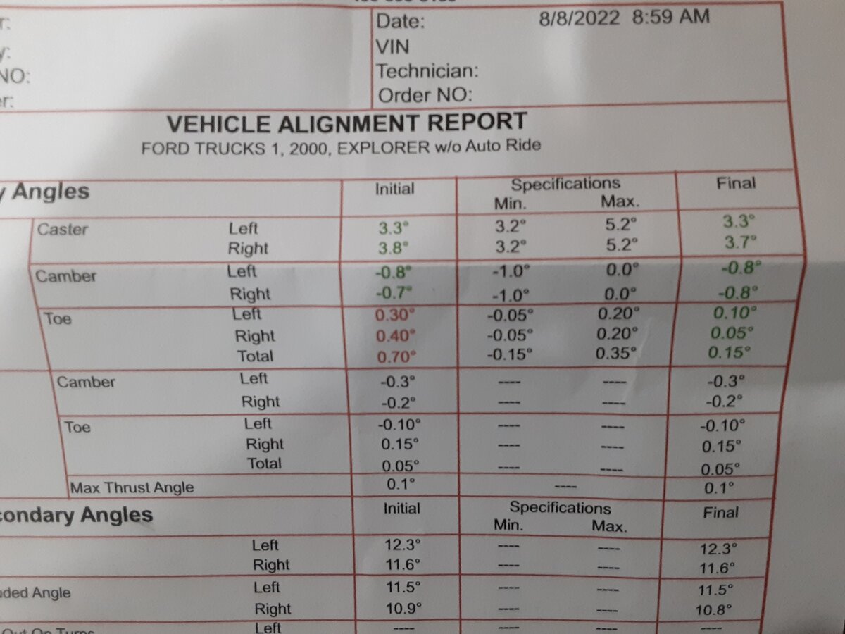

I think the outer tie rods are good. But.. following the advice of those on here whose opinions I respect, I went ahead and ordered new outers today.
The outer tie rods were actually pretty tight. But since I bought new ones I put them on along with the new inner tie rods. Saved the old but still good outers in case I need one on the trail to get home. Got it aligned today and was amazed that despite the cranked torsion bars they got all the specs in the green. Castor, camber, and toe all good. Drives great.

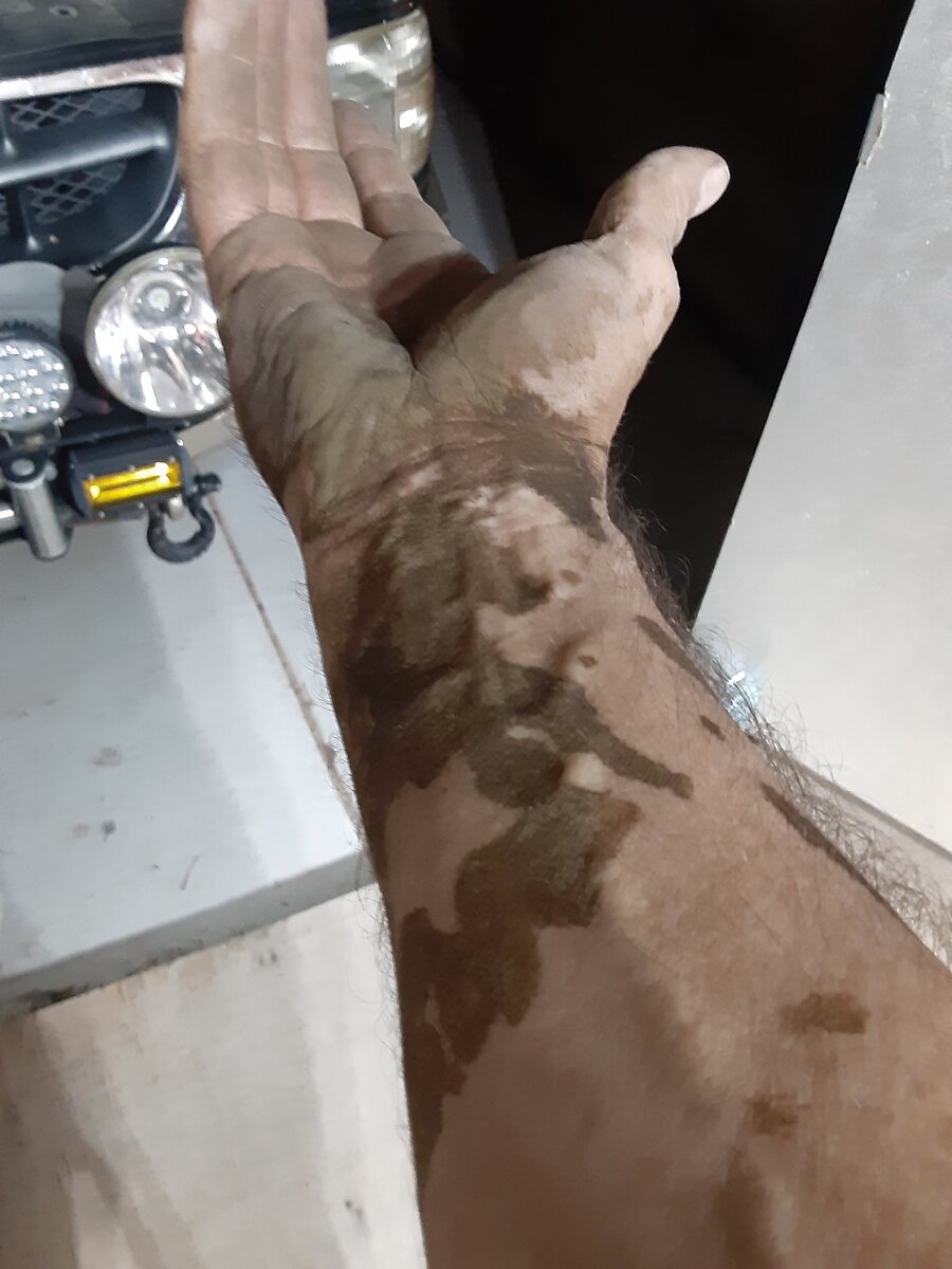

Decided it'd be a good idea to change the fuel filter as it's been acting funny, like starved for fuel. I still can't get the second connection off. (There is a small dent in the connector that I suspect I keeping the fuel filter from coming out). But having had one connector off and had the fuel in the filter drain all over me I can say that the fuel filter was a problem. The fuel that came out was dark and look at what it left on my arm!

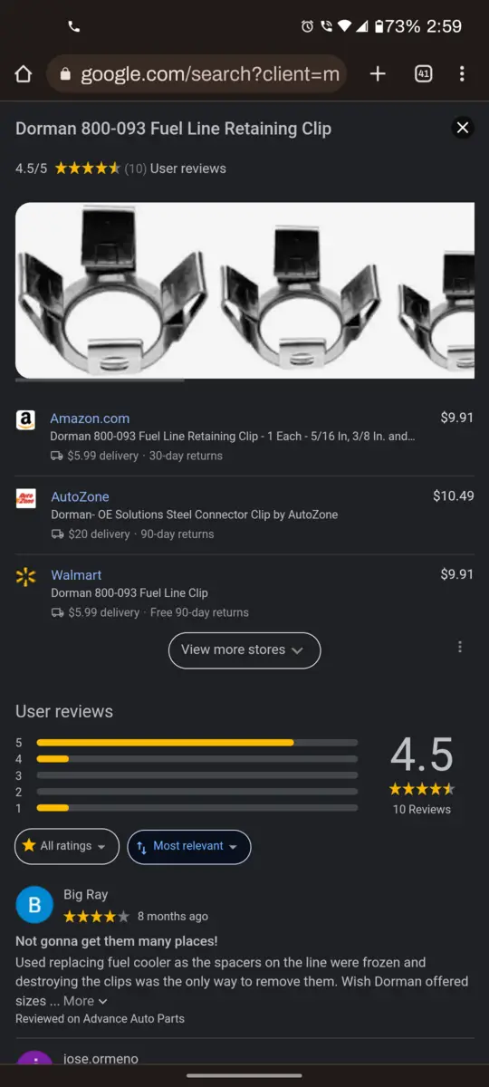

These metal clips are a pain in the azz. You can get new ones at your local auto parts store.
If they are rusted or full of dirt they won't come out. But you can get a pair of needle nose pliers and rip them out. New one just pops in there.
Pulling as hard as you can, prying the hell out of the filter usually does the trick then just replace the metal clip
