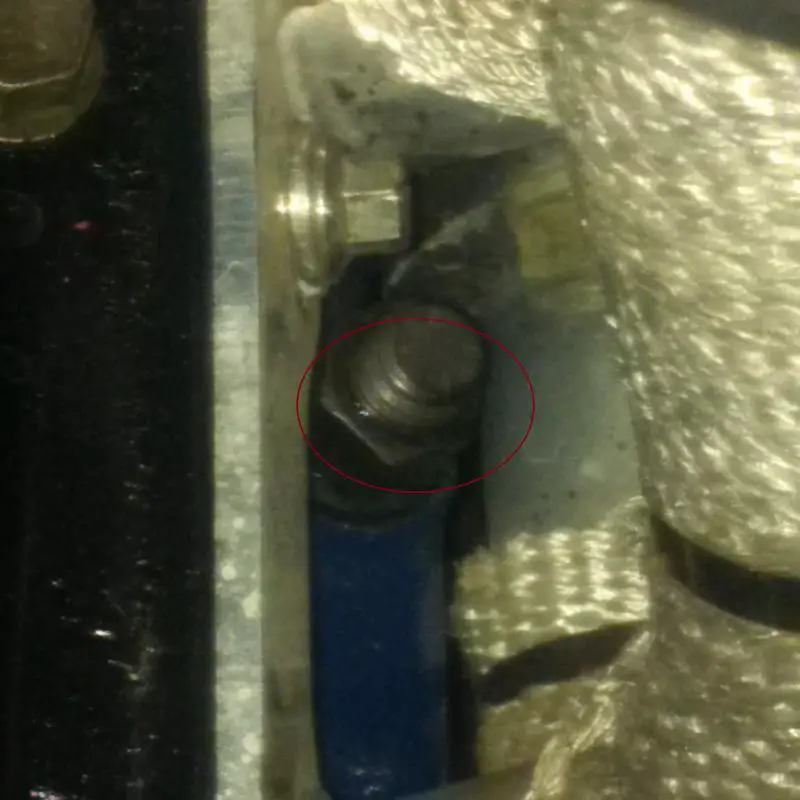

I tracked down my leak to the drivers side.
I 'think' its either head studs or the head its self.
The lower intake is dry and tight. Dripping is clearly on to the drivers side exhaust manifold.
I snapped a pic of what at least two head studs look like on the drivers side.
The dripping happens with the rad under pressure and its a slow drip.
I did use pipe joint compound on the bottom of the studs before inserting them, but maybe not enough?
What do I try next? Million dollar question. Pull the header, then one stud at a time and try more pipe sealant? Thoughts any one?

Dont head studs need to be re-torq after so many miles??what type of head gaskets did you use??
Head Gaskets Fel-Pro 9333PT1
Im told no re-torque necessary. I did retorque them a bunch of times before the motor went in. I did find after installing the lower intake that the out sides of the head has loosened some.
Very strange. I have emailed Ford Strokers. There might be some words of wisdom there.

Swear ive always redone them after heat cycles but may have been do to copper gaskets tho..they seem to be famous for small leaks around water jackets. .
Swear that was they whole good point to TTY bolts on stock motors
There is so little room in that engine bay. Retorquing heads would be a major undertaking.
Ooo i know..when my builder reminded me of that i wasnt happy because removing my sc and mount is NOT easy..but know 100% with head bolts and copper,they need to be done
As for pipe sealant try using some Loctite 567. Expensive, but we use it in the field all of the time.

You can remove a head bolt, or stud, one at a time if needed. Let Woody tell you that and how he suggests resealing things. It's odd to have a leak like that, but hopefully you can get to it.
If it is adding thread sealant again, be careful and don't use too much, it only takes an amount to coat/seal a couple of threads or so. Don't get it at the bottom of the hole, hydro-locking is possible for any bolt. I've only done that on a couple of stock valve cover bolt holes before, with too much RTV.
I'm thinking I didn't use enough sealant. That seems to be the issue.
There is nothing else on that side that can cause an issue like this other than a frost plug. Cracked head is a possibility, but a coolant port cracked to the outside?
Seeing the head studs wet like that makes my conclusion the most obvious, but not necessarily correct.
