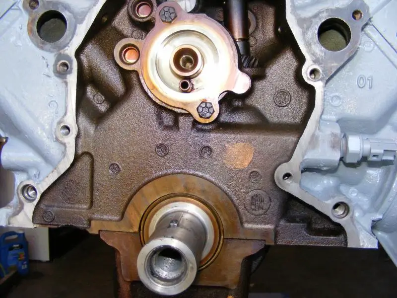

As seen here, the gear is behind the timing cover, so I can see how the teeth could get into the timing gears-

Thanks for the pic Turdle.
It looks like the teeth are more than likely in the timing cover, and that's where they are going to stay. Looking at the pic, I don't even see the path for oil to get to the pan.

Some of the pans were steel and some were aluminum. I agree the timing chain area and the little shelf there is the hardest place to get to if any debris didn't drain back down. That front surface leads straight down into the pan, but the tiny particles Don's worried about could have just stuck to any surface.
Being oily and not weighing much, they can be gently setting anywhere around there. But still, as small as they should be, and few, I believe the only worry is if enough exists to reduce flow at the oil pickup screen.

Not much to look at really. 4 teeth are torn off. I knocked another tooth off trying to get the gear off. The tooth didn't shatter, it broke cleanly off in one piece. Im betting that when the teeth came off, they came off in full pieces.
When I did the nasty with the water, I did not point the hose towards the front of the motor, I pointed it as straight down as possible. That would mean i didn't even wash the area that the fragments are probably in.

Looking at the pictures in the previous post (#61) if you do get a hold of a bore scope it might not be a bad idea to inspect the cam gear face through the cam sensor mounting hole just in case.
