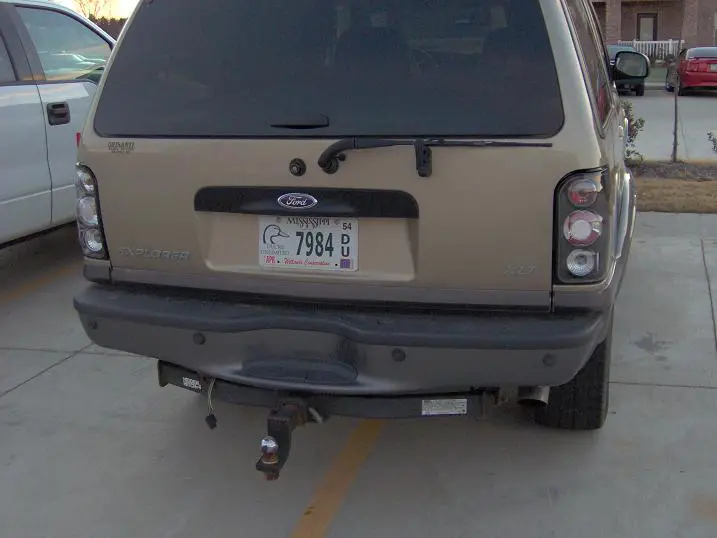

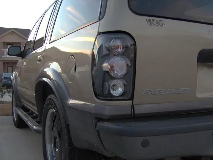

I got my new tails yesterday. I was happy to see that they came with red bulbs....so I went ahead and installed them before my LEDs came in. I was very disappointed when I found out that my red bulbs are more orange than red. So I went to Autozone to look for some cheap LEDs when I came across the little light condoms. Putting the red cover on the already red tinted bulb actually works pretty good. I am waiting on my 27 LED red bulbs to get here:) THey will look alot better with all LED lighting.
THe only problem I came across installing these is that the passengers side blinker hole was keyed wrong. The bulb socket makes a 90, and the way they were keyed, the tails wouldnt go on the truck. So I trimmed a little off of the smaller keyway with a raxor blade and flipped it.
Before anyone says that they aren't legal... I KNOW. I will be adding some red reflectors to my hitch as a temp until I get my bumper build. My new bumper will have some 18wheeler oval LED tails on it that are also reflective, and smaller amber ones on the sides.

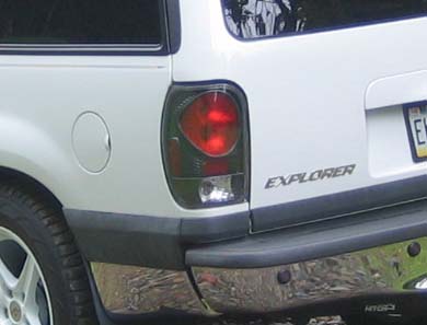

Not to steal your thread but I had these on and they're not to bad looking. They are the only ones I'd put on mine. But I'm really gonna looking into getting the ones above :)
Those aren't bad. Any close ups?

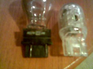

I got my bulbs today BUT they will not fit. They were listed as 3157 bulbs but they wont fit. These are the 27 LED capsule 3157 bulbs from eBay. DO NOT buy these because they will not fit. I got to reading the fine print on the auction and it says that these 3157 bulbs will not wit bulbs listed as 3157LL on the linked fitment chart--which is a Sylvania chart. To my knowledge all 3157 bulbs that Sylvania makes are LL(long life). ....unless there is a different kind of 3157 that I dont know about. These would work if the tab at the bottom was longer...the capsule part hits where the bulb normally snaps into before the tab is far enough in to hold the bulb. If you look at this picture (horrible phone pic) you see what the difference it. I will probably be modding these to work by adding material to the tab.

Again, sorry to hijack your thread. Best pic I could do, cropped from another pic....
