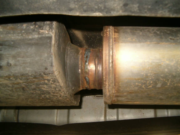

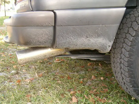

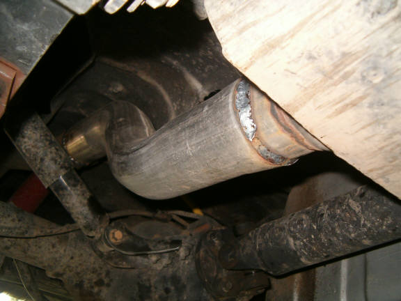

Well, here are pics of the exhaust on my truck. Yes it is dirty, yes I have washed it, yes it gets dirty again--
Dual 2.5" in single 3" out magnaflow in place of the rear cats-
Hooker Aero chamber 3" in 3" out stacked right behind.
3" tubing over axle
MAC tailpipe-with 3.5" tip. Not to crazy about the tip, but oh well. Still have a bit of track rubber on there--:cool:
It is still "loud" by any standards, but the highway sound is very pleasant according to my lovely bride.
