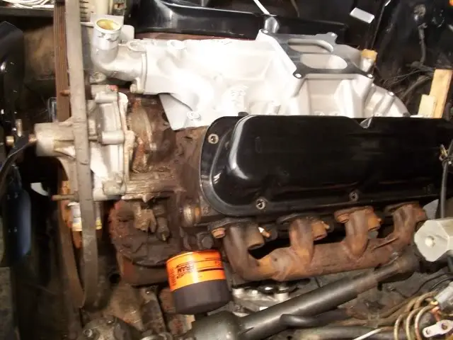

Some shots of the headers on the new truck
That's the other thing wrong with the TM design. They never intended them to be used for anything but a bone stock Explorer. They didn't care a bit about anyone else, plus they didn't give any concern for the other stock components nearby. Check out the clearance to other items, such as the AC box. They can and will melt if they see enough heat.
The factory collectors are located and oriented very poorly also. Any other possible header you can try will not work at all, simply due to the collectors. The collectors of the headers will have to be cut off, as well as the OEM cat pipe down pipes(collector connection). You will be fabricating some of the parts from the heads all the way to the cats.
I don't know that I have the answer, I just know that the original parts are awful, and removing them entirely is the answer. I will fabricate the exhaust completely from the bumper to the cat pipes, before dealing with the manifolds. I need to sneak up on that junk, and learn how to weld better.
Yes, on the stock heads there is a slight dimple which clears the #5 pipe flange. Most of us who used aftermarket heads, chose to remove a tad off the head, and a tad off the flange with a grinder.

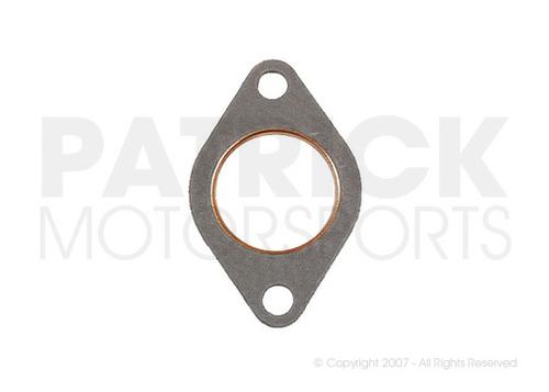

Do you happen to know where I can get a new donut gasket?

Donut gasket? Doesn't exist.

Talking about the round gasket for the #5 primary.
That's a flange gasket. I posted a part number and picture in the sticky thread.
This is a donut gasket
