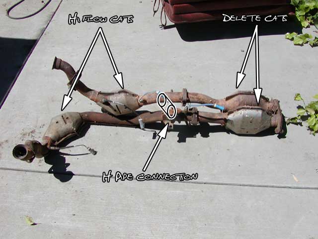

I just happen to have an Explorer.... )( pipe laying around. This is what I was thinking about doing:
Also, I have a tube bender and I have mad skillz... is this something I could totally replicate instead of altering this one?

Only do this H-pipe idea if you plan on running 2 seperate mufflers....
So if I was to only have a single muffler.. I shouldn't worry about connecting the two pipes before the muffler? Just remove two of the cats and slip in hi-flows?
Exactly.
ok well maybe you can help me.... I have FMS headers and true dual flowmart 40 exhaust with 2.5'' pipes. I am going to delete the last 2 cats and put in high flows for the first two. In the future I plan on being EE S/C so I want the full potential out of it. Should I stay true duals, X pipe or H pipe?
Section and Boomin, for a custom exhaust system, I would reverse your choice of cats to "delete." The front doesn't have much room for cats, and all hi-flow ones are straight in/out. They'd drop in where the rears are. However, keep the front O2s in the same position in the pipes. The rears can go anywhere after the cats, or be delted with an O2 simulator.
Also, I'd keep the front downpipe sections seperate, I had to remove mine and if they were one peice it would have been insane, if not impossible.
Just my opinion, and how I plan on doing it :)
