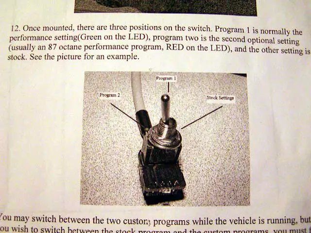

Brian did my chip as well. Maybe I'll pull the chip out tonight and see if I can tell a difference. My problem is that I had no 'before and after' to go off of when I installed the chip. I couldn't say, "oh yeah baby, this is much faster now," because I did the cam and rockers and chip all at once.
Plus I'll look at my chip instructions and make sure that the middle position is infact the high performance mode.
LOL, you've got it on the stock setting. :D

Is your chip a flipchip? I thought you had a standard chip? Make sure the chip connections are making contact to the PCM board also.
*******.. :p
Unless my instructions are wrong...
I have 92 and 87 performance modes, and the stock mode.
Sooooooooo.....
what was it on?
Straight up! Performance 1. 92 octane foot to the floor mode.
I don't know why that was so funny to me... I'm still laughing.... :chug:
Seems like something I would do I guess. A flip chip won't help me - I've got to run 91+.... :fire:
Does it do anything different if you run it and change settings? If not - either the chip isn't touching the board, or the PCM is bad.

I'll find out. I haven't really ran it on anything but 92. I'll pay the extra $2.00 at the pump for the good stuff. :D
