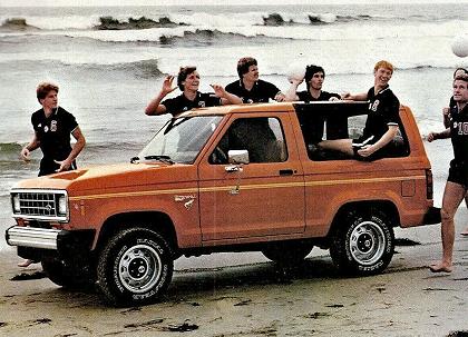

removable rear windows in the bronco II were also in the brochure, magazine adds, and the owners manuals..... they never made it to production
Super safe!!!!! HAHAHAHAHA
HOWEVER one truck with them is on Youtube
Lucky DUDE!!!
I think we could 3d print the hinges and latches....

OEM car manuals and brochures are very very often full of incorrect information. The earliest 2nd gens had a rear reclining seat option. But don't get your hopes up, they existed but the amount of recline was maybe 3", and super rare if you ever see one.
