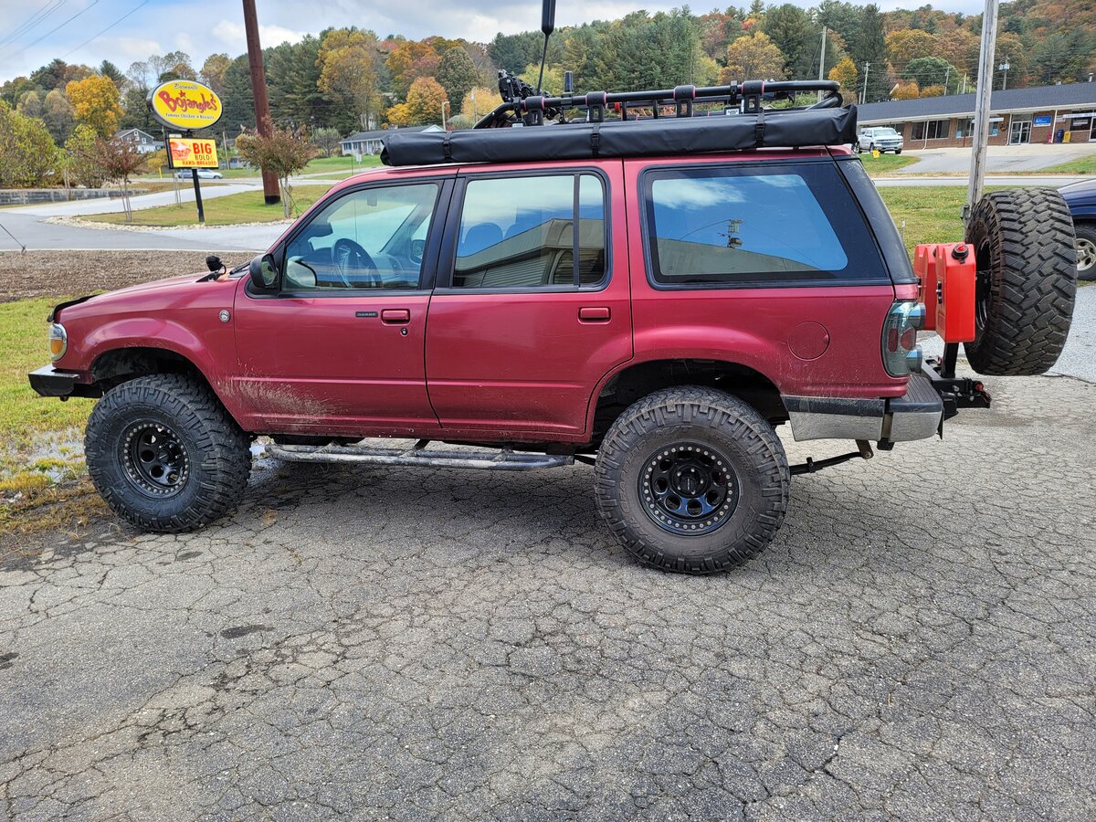

Right now I have reindexed (+3") keys, plus 2 inches or so of twist in the torsion bars. Slight trim on the bottom of the fenders. I used the tracmotive half shafts to handle the angles.
I also had BFT Fab make fully boxed uc's with uniball, 1" longer to remove the negative caster.

1" additional lift on the body mounts when I changed them all out.
No rear trimming, but I did flatten out the trailing sides of the front fenders. This pic was before. Also before the beadlocks.
The rear are sua, but ordered for a 1996 ford f150 with a 4" lift in them. 2" warrior shackles finish that off.
TT, as stated earlier, but only about 1/2 of potential, since I re-indexed the keys 3".

@Fix4Dirt , thanks. You asked in the pm about the spare carrier, but I can't add a photo. Again, with the old wheels but maybe helps a bit. Also a pic opened.
