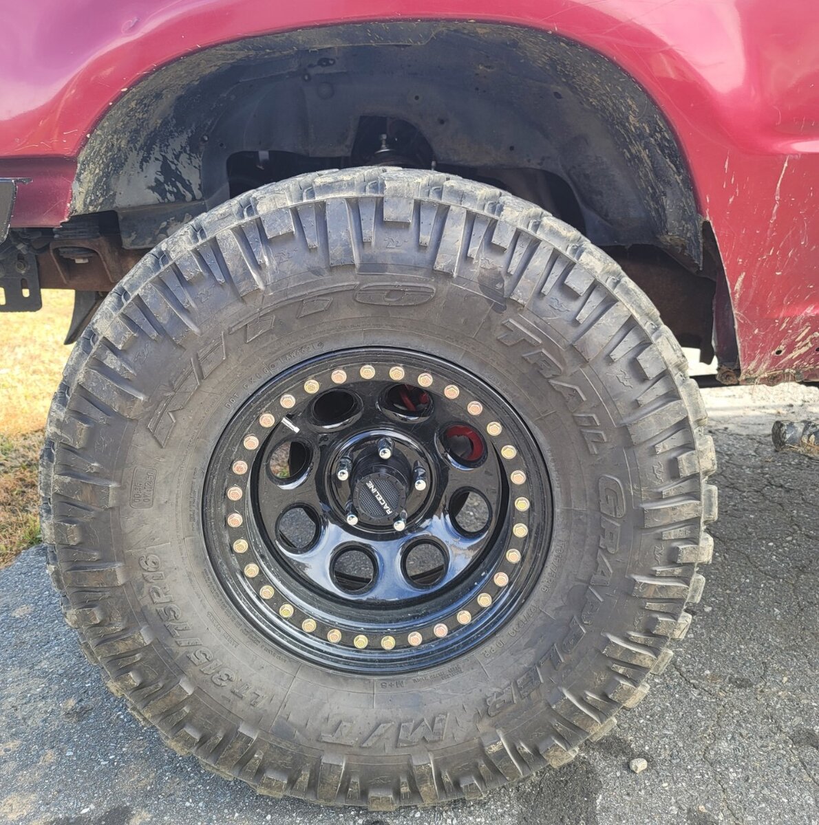

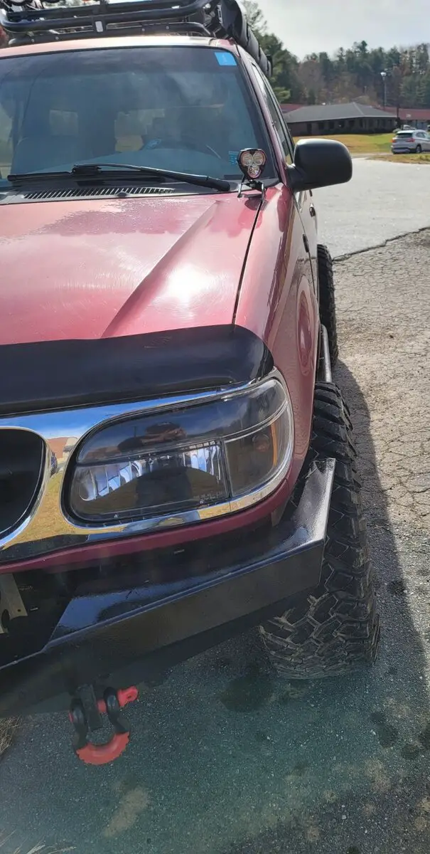

Not sure if you've settled on anything yet, but Raceline makes a -19mm offset, 16" steel wheel. I have the beadlocks installed with 3/4" spacers. Nitto 35x12.5 Trail Grapplers. Hope that gives you some perspective.
View attachment 436020 View attachment 436021
That is exactly what I want, but I'm unsure if those will fit with the RC 5" suspension lift installed. RC website says a minimum of 17" wheels are required, but a few of the guys mentioned that 16s might fit. I would buy that exact set right now if I knew for a fact that they would fit with the lift as well as the larger calipers and rotors I'll have to swap. There's only a 1/2" difference between the radius of a 16" and a 17" wheel, so I suppose it's possible. I'd just feel better with a definite answer before purchasing them.
