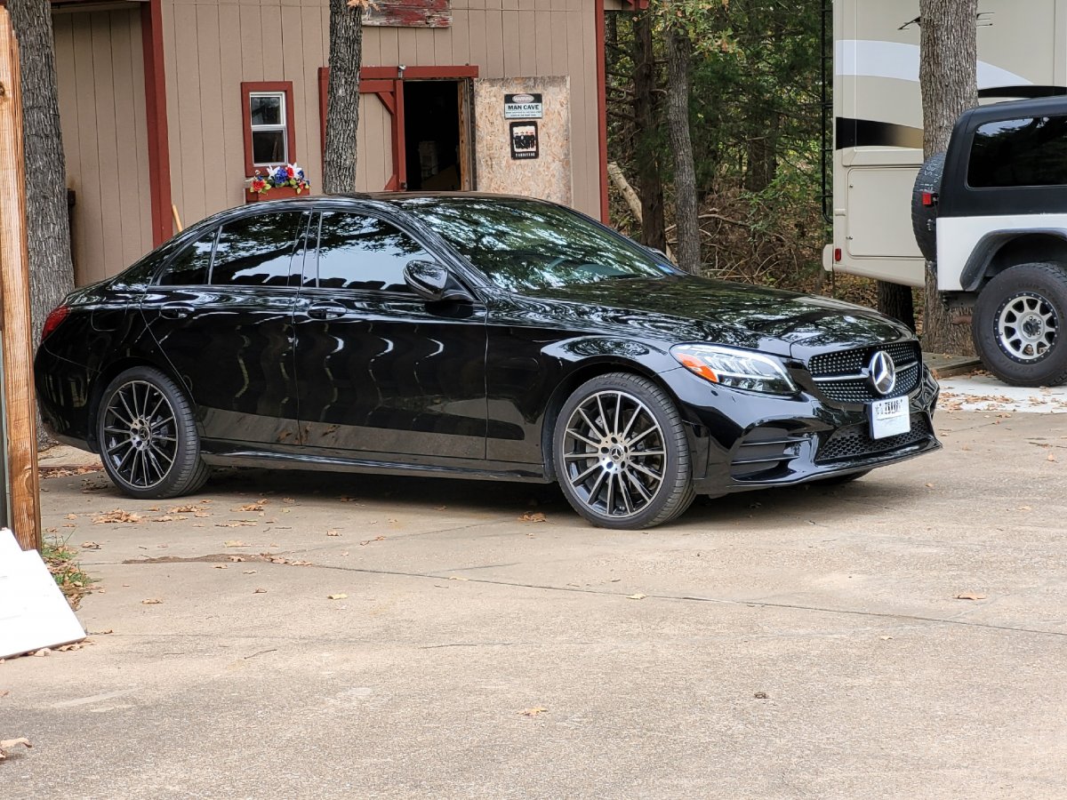

To avoid the confusion here's my C-Class lol

Haha thanks guys. Yeah small cars aren't typically my style either, but I commute a long distance to work and needed the fuel mileage.
