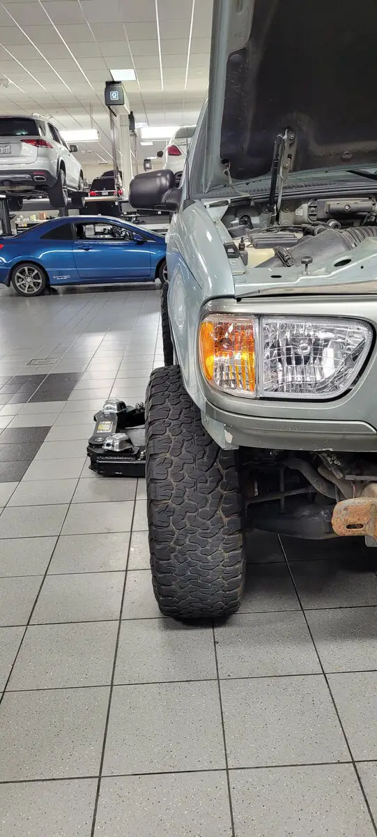

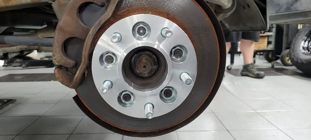

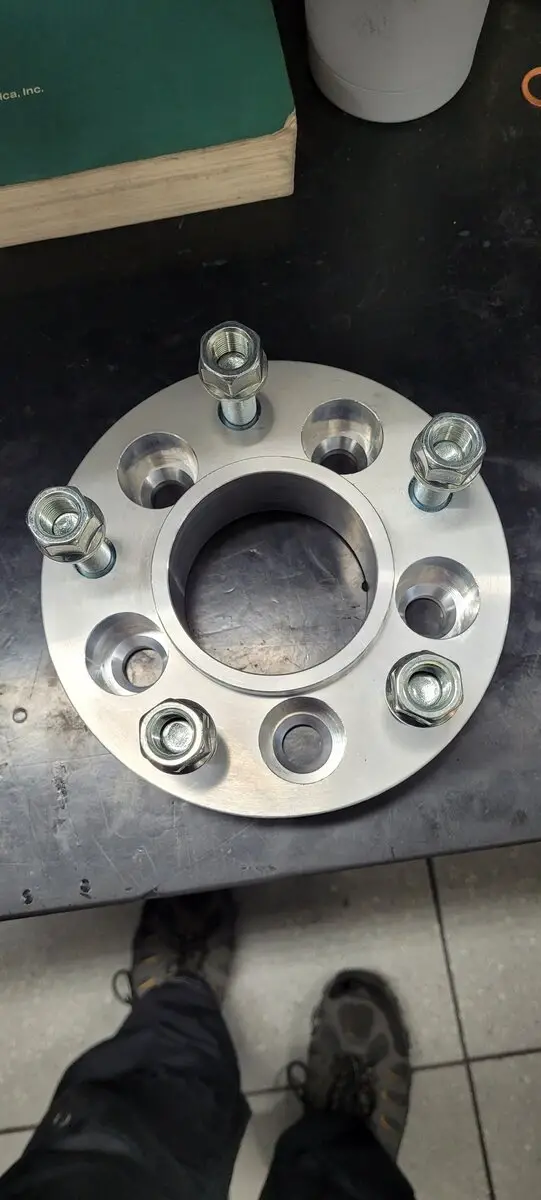

I got my custom spacers in today, and got them installed with the new wheels and tires. View attachment 437441It looks much better! Tires are 33x11.5 (temporary until I get the lift, then going to 35s) The spacers are great quality too. As previously mentioned they are custom built from billet aluminum. They are genuine load bearing so no stress on the studs. They are hubcentric and perfectly machined to fit my hub and these wheels. Got them on with the new wheels (17×8 -12 offset) so going from +12mm to -12mm offset gives me rough an inch plus the 1.5in from the spacers I've got 2.5 inches of width on each side. Looks much better and feels more stable.
I am getting some rubbing on the trim of the side steps so those will be coming off next to give the needed clearance.

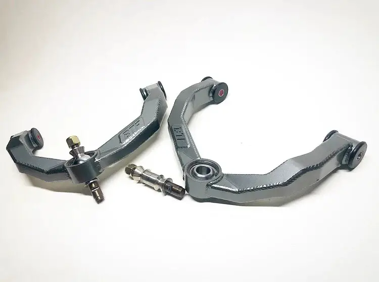

And these... love em...
I like those too, but I wish they made them with dust shields. The ball joints are exposed constantly, they will wear fast; they need seals on them, both top and bottom.
I've got about 15k on mine, lots of offroad in there. Seems to be holding up well. My alignment shop loves them. Says the hold alignment better than about anything they've seen.
No doubt they would last longer with some sort of boot though.
