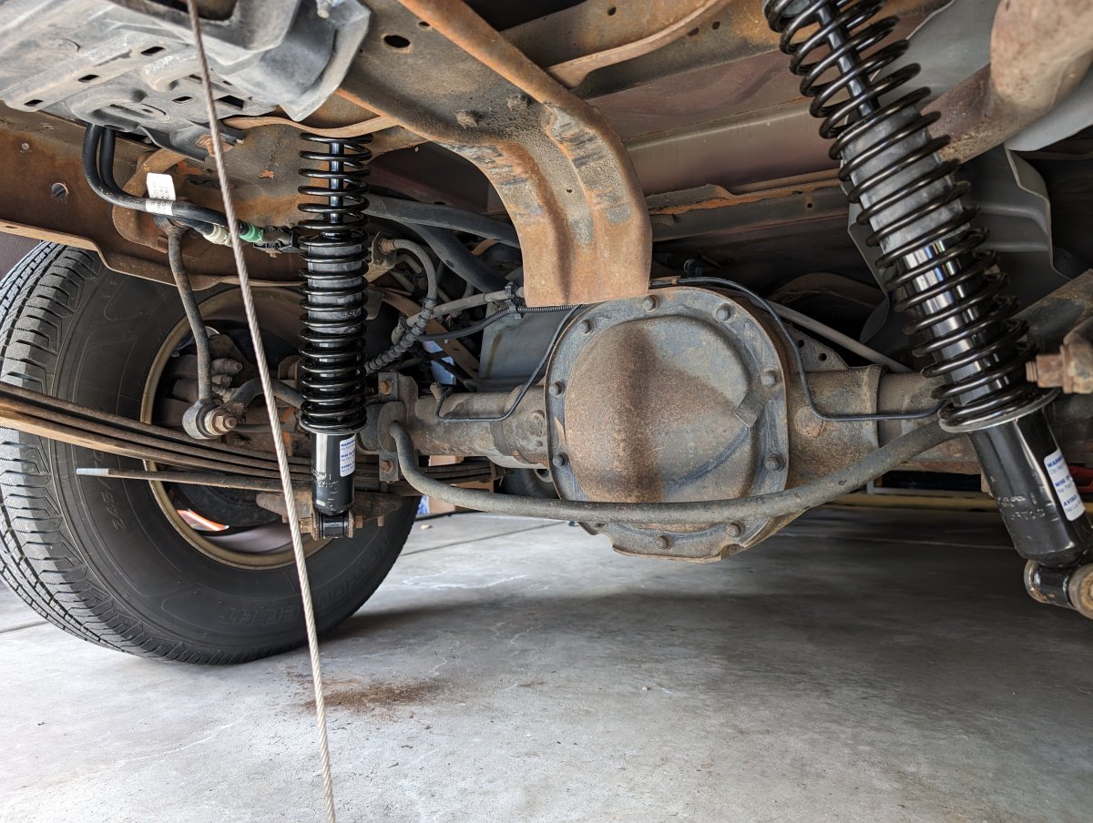

New shocks installed. Now it's level front to back. Rides pretty nice too!

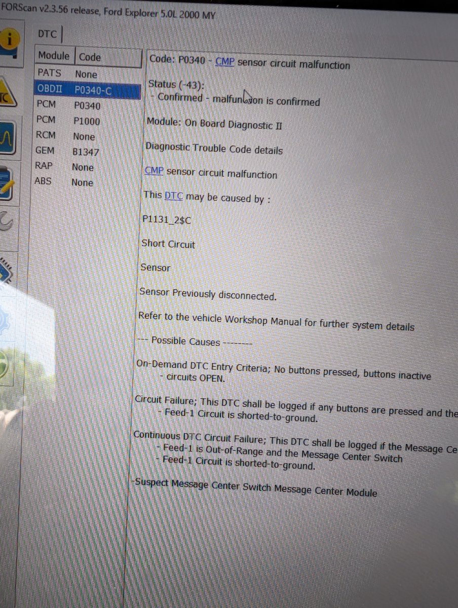

Now that it's warmer out a problem has popped up. When driving if you hit 3000 rpms the engine starts squealing very loudly. It also trips the the check engine light. I reset the codes and all was well for a few days, but then the cel came on again when the squeal started again. I'm assuming it is one of the idler pulleys as the noise changes with rpms but not sure why the cel comes on (honestly haven't read the newest code yet, I use forscan).
my guess would be maybe leaning out. but no clue haha let us know what then code is and we can help! is the CEL on only while squealing? thats new if it is
Read the codes. Looks like p0340. If I rev it up to 4k in my driveway, let off the gas it makes the noise and lasts a few seconds at idle then goes away. I cleared the codes and the cel and afterwards I can't rev it up and hear it. I know it will come back, but not sure what is causing it.
My research indicates my problem sound is most likely caused by the cam position sensor synchronizer. Cheap fix seems to be pop off the cam position sensor, blow out the area with air, then drop a couple drops of oil in to help lube the synchronizer. I'll try that this week and see if that solves my problem.
/\ Yep, squealing cam sychronzer....semi common........and 5.0 easy replacement on this unlike the 4.0 ohv, and I see the 2001 second gen they did a better job routing the brake lines, earlier versions they are close to the UCA on drivers side and make that job a headache removing / installing bolt.... so two positives on your 2001 V8 👍
The oil will only buy you time, but that is a great way to isolate the cause of the noise
I removed the cam position sensor today and blew it out then dropped some oil in there. This completely stopped my squealing sound (for now).
