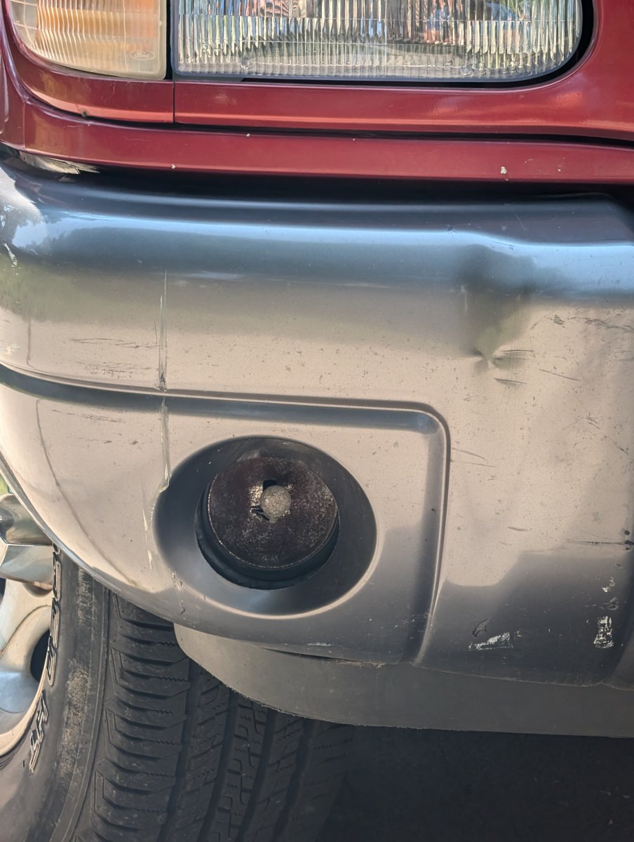

I replaced the headlights as the old ones were very fogged up and it improved the light output (of course). My question is it worth replacing the stock foglights? Passenger side is broken completely and driver side is pitted real bad. Electrical works on both but is the output on the stock fogs any good or am I wasting 60 bucks replacing them?
I replaced the headlights as the old ones were very fogged up and it improved the light output (of course). My question is it worth replacing the stock foglights? Passenger side is broken completely and driver side is pitted real bad. Electrical works on both but is the output on the stock fogs any good or am I wasting 60 bucks replacing them?View attachment 454792
the output is ok. for a while i just bought offroad pods and put them there they were amazon units for i think 20 bucks or less. much better.
