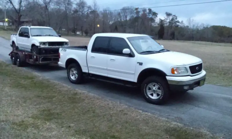

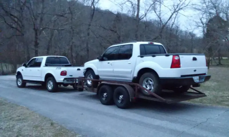

Loaded the white ST with the bad engine tonite. Picture is a little blurry because it was getting dark. Will be heading to Ricks to drop this one off and pick up the donor. I have the front bumper and headlights off to make it one less thing to worry about during the engine swap. Plus I didn't get the front lower painted yet. I think it looks a lot better with the semi gloss black on the sides and rear. The two trucks look like big brother/little brother.

Very cool guys, you know I love seeing these projects. I missed the past six months on the forum, but I've got my PC etc, back working again.
