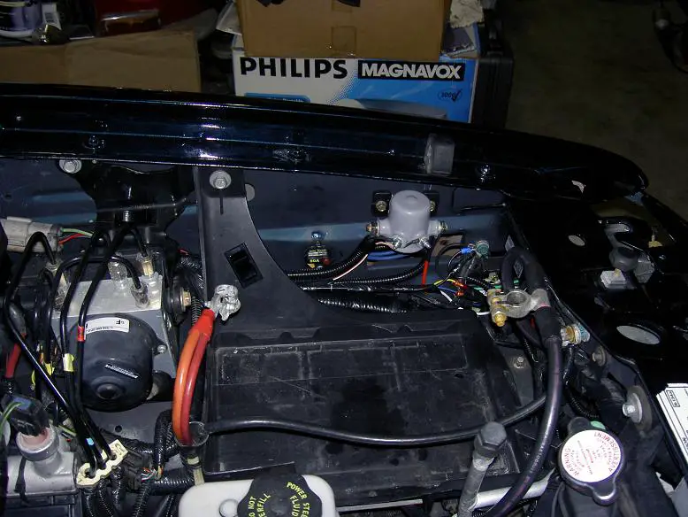

BTW, my 99 Explorer also had the battery cable ground wire cut due to the accident. I chose to alter the ground wires a bit, and I like it much better than stock. I made a new ground cable for the battery, but I reused the existing ground wire(cut).
I connected the old battery ground cable to the radiator support bolt, and to the frame near the fuel line area, on top of the frame, using an existing hole, with a self threading bolt. That gave my truck a better connection from the body to the frame. I was going to add ground circuits later to the frame, from an air compressor and a stereo amp. My truck got disallowed from work duties about three years ago.
