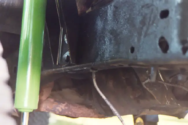

Left side brake line relocation

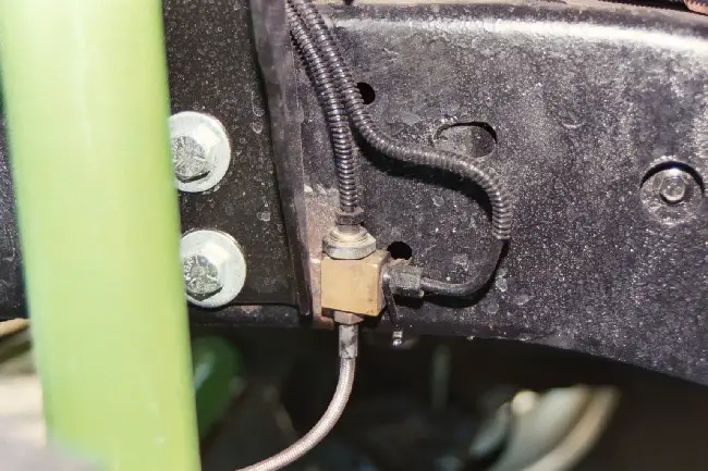

right side brake line relocation:
