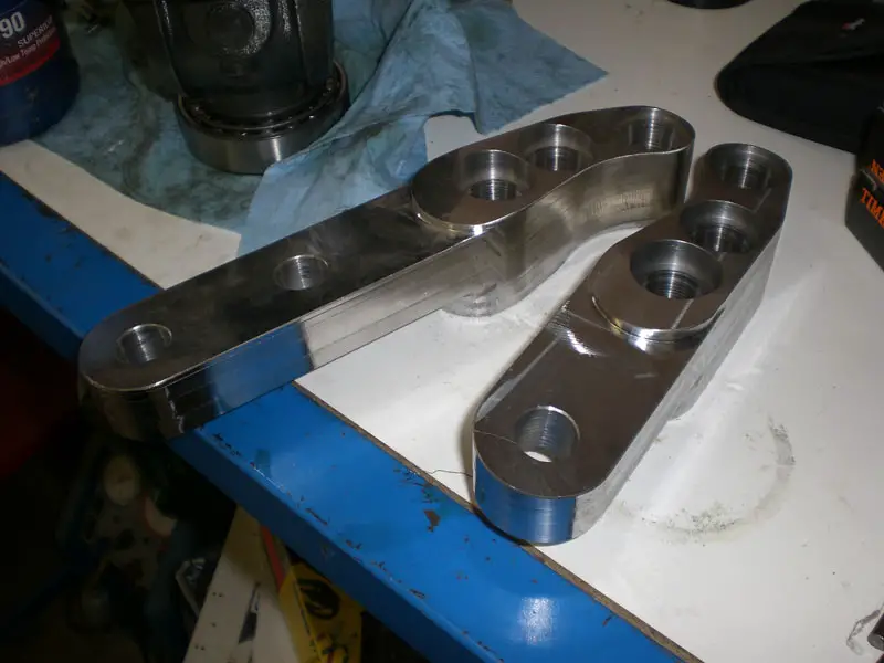

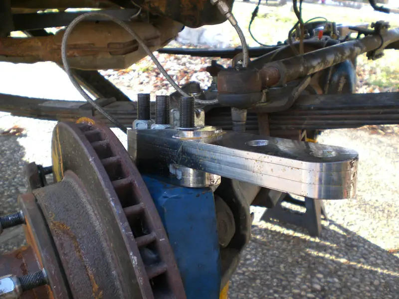

Its one thing after another with this project.
Rotating the perches really messed everything up. I have a great caster angle now, and a better pinion angle... but no steering.
So after rotating the spring perches, that pushed my tie rod right into the leaves. Great.
So after some research I discovered that my high steer arms were for SUA or coil/coil over setups. Not for SOA leaves. Great.
So I bought the correct high steer arms from Sky Manufacturing. Now, the arm studs are not long enough to get the bolts on completely. And my old TRE is permantly fused to the old steering arm. Siiiigh. I have more $ into this front end then coilovers and links would have cost. :(

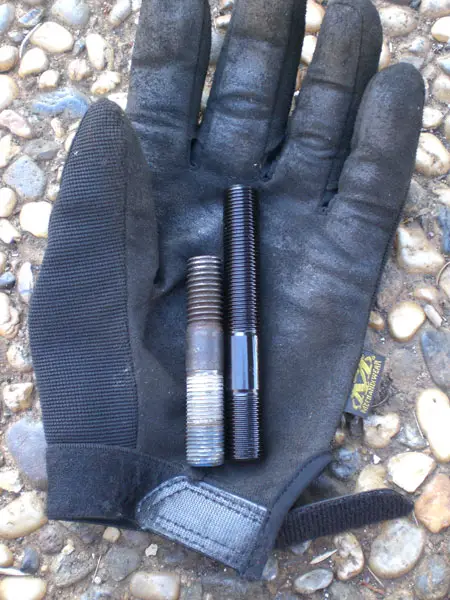

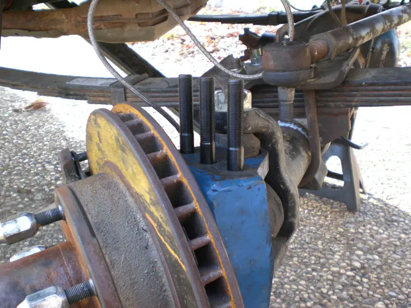

Studs came in. These things are both bling and enormous. Better too long than too short I guess. :p:

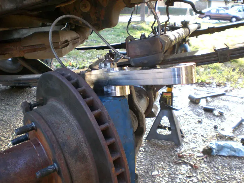

Are high steer arms an absolute pain in the ass to remove every time? It seems those cones get in there up against the threads, and even with the nuts removed, you still have to beat the shiz out of the arms with a rubber mallet. Hopefully my new hardware is a little more forgiving.
Goals for the day:
Both arms on and secure. Ream driver's side arm. Drag and tie rods installed. ARB compressor mounted and working. Re-fill front diff. Test.
