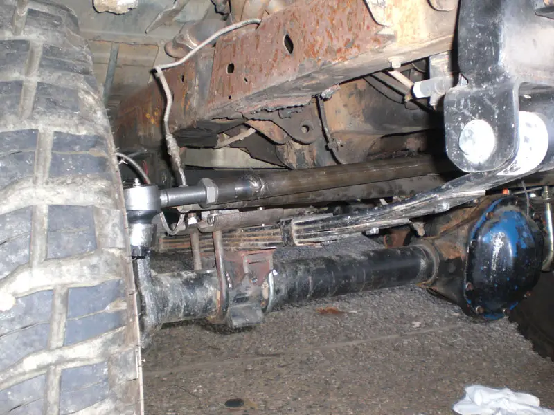

Yeah thats part of the cone's job -- its a 3 axis "washer" that pushes radially while it pushes down. So they actually bite into the threads a little bit when they are tightened down because the studs themselves dont actually come into contact with the arm -- so part of the torque from steering goes through the conical washer. The rest of the steering torque goes through the machined surface between the arm and the knuckle.
Here is where I am. Arms are on. I got a new TRE cause the other one was fused into the old arm. So now its all back together and steering again. Tires are on. Oiled up the diff. Battery is charging... :rolleyes:
Tomorrow, I'll mount and wire up the compressor. It looks pretty easy. Just finding a place to mount it. Everything else just snaps together like ice cream cake. I just don't feel like doing it in the dark.
The 7/8 of an inch difference goes a long way with the steering arms. I have all kinds of clearance now. :) Plus, the pinion angle looks much more tolerable.
So, where to mount the compressor?

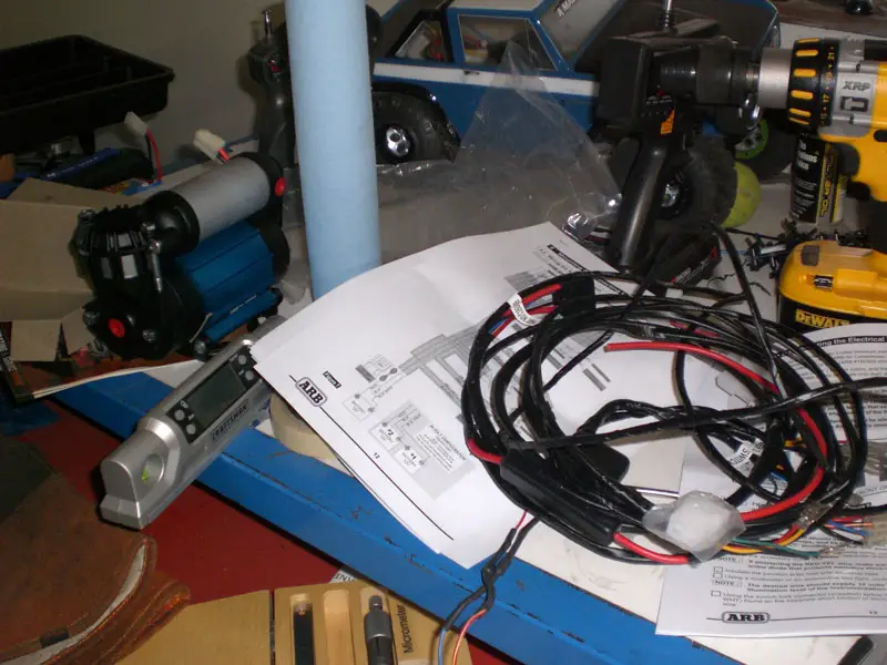

I need to clean up the garage too. Looks like a bomb went off. :(
I mounted mine on the drivers side in front of the front fender. There is like a little metal shelf.
You've got waaaaay too many goodies in that last shot Section. RC truck, DeWalt drill, ARB comp., digital level...:confused::p:

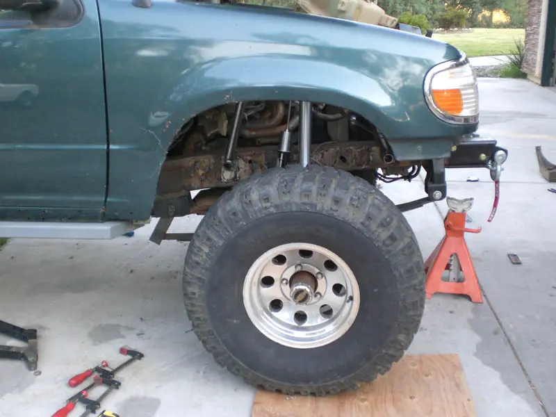

Dannyboy has been harassing me so much I decided to get some work done on the ol' Explorer. It's been well over a year since I bought my tube bender and I'm embarrassed to say that today was the first time I've used it. :(
Anyway, I went down to Pep Boys and picked up some shocks. Now I'm making some new hoops to make them fit (shocks are off an Aerostar). Got one side bent up. But I got in trouble since I have family over so the other side will have to wait till manana.

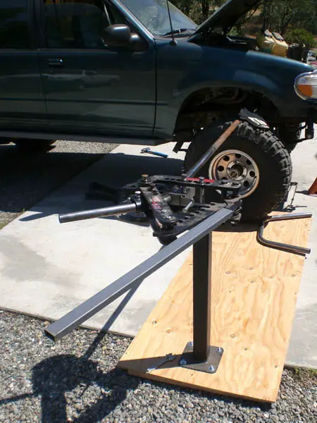

Okay.. so I got a little more work done on it. Here is a shot of my ghetto mounted tube bender. :D
My first bends and I do it like a Pro. Look at that consistency! :p:

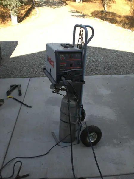

I had to borrow a 110v welder since I don't have 220 yet and my electrician is in Palm Springs for three weeks.

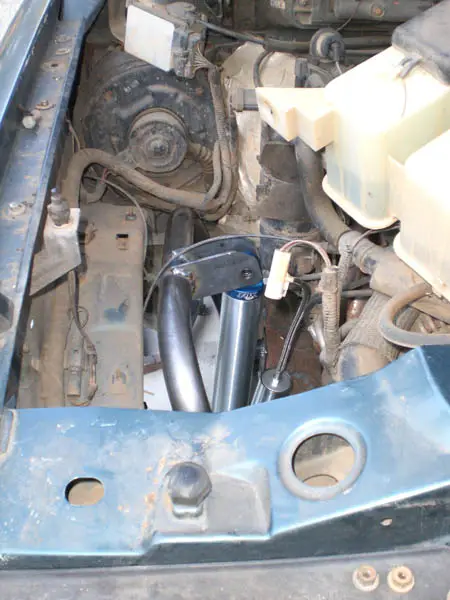

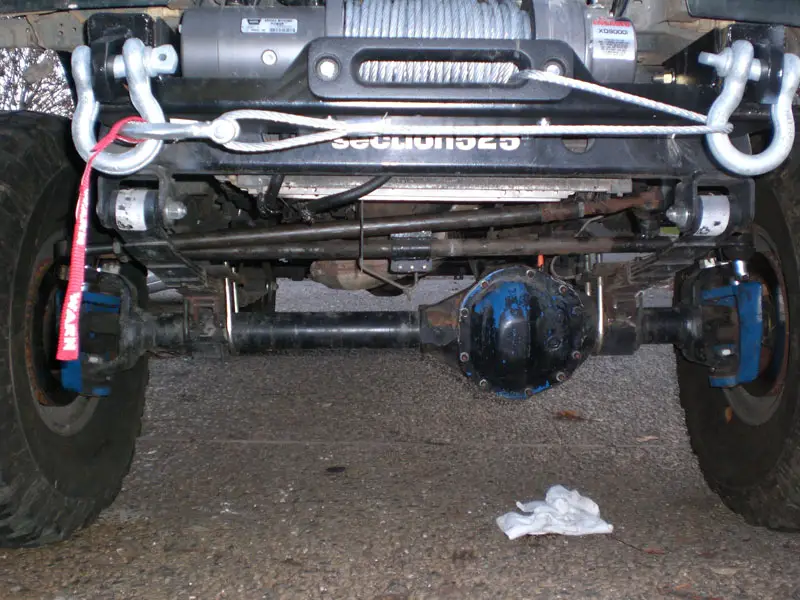

I need to finesse the tabs before they get the final sign off.
But here is where I am at so far. I may or may not keep these (this one). With the two reservoirs (coolant, washer fluid) gone, the battery out, and the ABS module deal gone, I have all the room I'd ever need. As of now, I'm setup for 5" of up travel, 9" down. I'll flex it out with the forklift before finally welding.

you didn't by chance cycle the suspension or run it up an RTI ramp to see how much bump travel you gots did ya? Looking at the pics you should be good to go but I was just curious.
